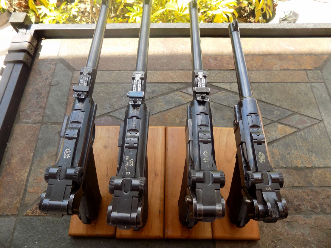

I am aware some hate my pictures, but this one demonstrates differences between both models~
