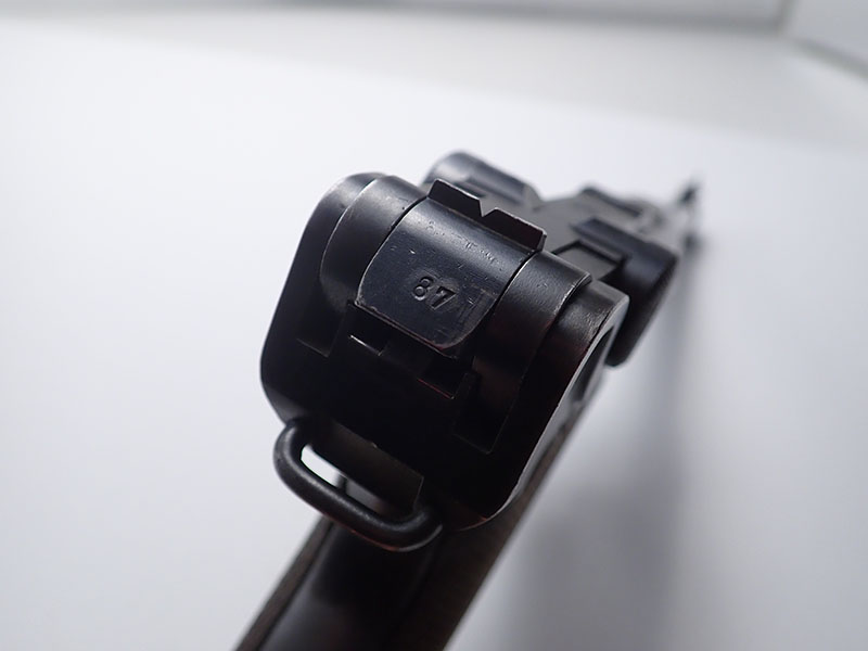

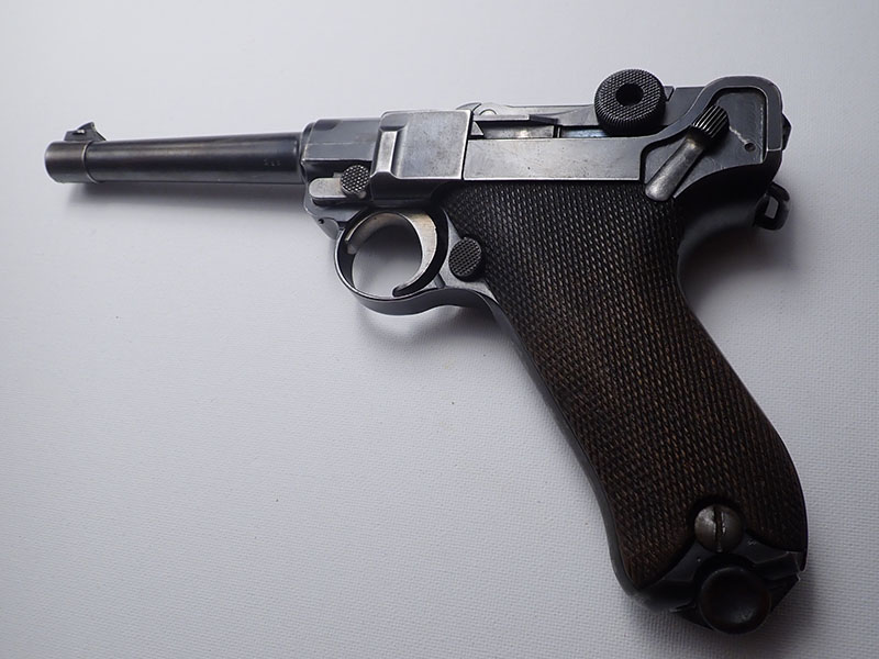

I just got this yesterday and was sent to this forum to help identify what I got. Anyone tell me more about this fine firearm?

First glance says it’s a DWM commercial Luger, looks like a pre-war one since the barrel appears to be 4 5/8” long. Would need more pictures, especially those of any/all proof marks and serial numbers. Which will be located on the trigger guard on the front of the frame, underneath the side plate and takedown lever, underside of the barrel, and on the toggle links for sure. They might also be on the toggle link pin in the rear, firing pin, and the inside of the grips among other places, but some examples are also left unmarked and this is considered normal. I am sure that one of the moderators will post a link to it, but all of us would recommend you read the FAQ document that can be found as one of the tabs of the home page to help answer questions. Several YouTube videos also show how to properly disassemble your Luger to check for proofs and serial numbers, but if you are uncomfortable do this yourself, take it to a gunsmith who does know how to do so without damaging it.
Side note, there doesn’t seem to be a pin that should go down through the left toggle knob and that looks like an empty hole, not sure I’ve seen that before and I don’t know what, if any, problems that may cause. Merry Christmas to you and congrats on your new acquisition.

I made it so you would get notified - welcome to the forum and Merry Christmas
It doesn't have any proof markings on the left or right, and a 1908 would be on the left
the 295 on the barrel is weird
Caliber? - it would be 7.65mm (30 luger) or 9mm luger - take a common pencil, a 30 luger will go down barrel tighter, while if 9mm it will just all up and down.
several notes
1. better to post pictures here than google
2. no other markings makes me think its been reblued a bit too hard
Unread 12-25-2018, 08:20 PM   #4
Missing the toggle pin.
Anyone else find the ring around the base of the barrel odd? Looks thick and almost looks like an add-on.

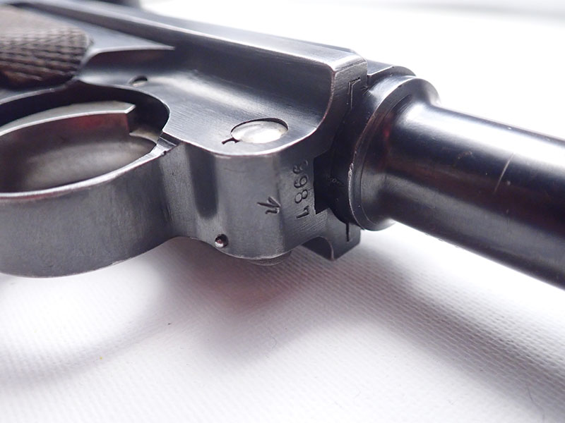

Is the serial not 9987?

yes, I did not look at these pictures
It looks like with an 'r' suffix - that is likely a post war, almost 1930 date - if it was a WW1 that was rebuilt by either DWM or other company, then it could be lots of years.
HOWEVER - since it is missing the stock lug, then it CAN'T be a 1908 frame, as an r is too late, they were less than a 'c' suffix. So, take pictures of the back of the frame, near the bottom. And it probably was removed - but lets see 2-3 pictures, straight back, slightly under, ect.

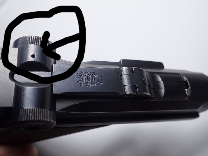

whoa - it might be missing the rear toggle retainer pin, but its NOT the rear toggle pin.
David was talking about this....
Unread 12-26-2018, 03:33 PM   #17
The pin Ed so eloquently "points" out is fairly easily made if you have any kind of old drill bits. It is a retainer pin that must fit fairly snugly but not "driven" in. Depends on your level of skill with gun smithing/mechanical aptitude..
Unread 12-26-2018, 04:04 PM   #18
Jerry is The leather guy, but I disagree- the missing pin is indeed "driven" in- or else it will fallout- perhaps as the missing one did. But then one man's "snug" is another man's "driven" in.
It is,however, "removable" to allow removal of the larger axle pin.

Well I am in luck. I am a metal worker and have a metal working shop in my garage. I bet I can get a pin made with your guys help. But I took more of the pictures people suggested I take to help finding out what this gun is.
Iannn is offline   Reply With Quote
Unread 12-26-2018, 04:30 PM   #20
That is good on the pin.
Nothing in these pictures helps, it quite likely simply a reworked alphabet commercial luger, dating to the 1920's. The usual proof mark on the left side of the chamber seems to be missing(need a good close up of this area), I cannot see it in the one angle view showing the area. This could have been removed during a re-finish if indeed missing.
The barrel was changed, somewhere, some time- with care- by someone who took the care to number the barrel and receiver. Why we won't and can't know.
To be certain the frame is consistent with the 1920 production, pictures of:
The inside of the frame from above showing the area in the well that the take down lever goes through, and the inside rear, between the "ears", from the front toward the rear will help.
Also a picture with the grips removed, and of the rear grip frame from the back.
