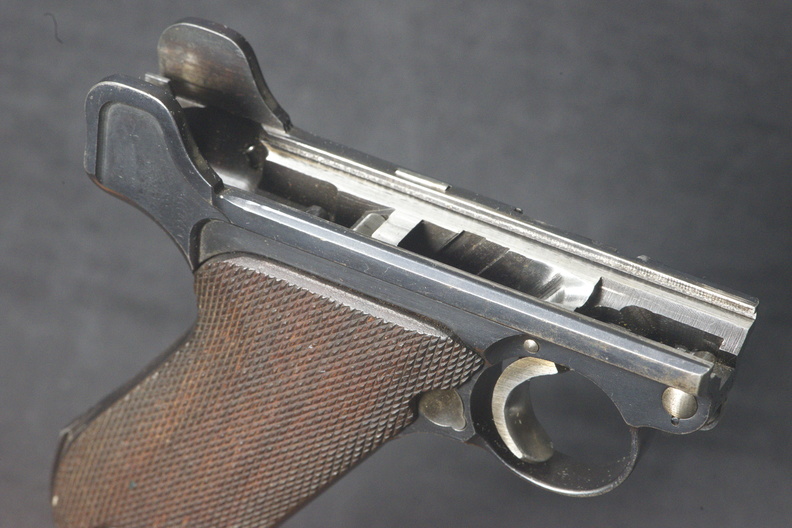

Even after 1937, Mauser commercial Lugers were rust blued, appearing with strawed small parts. It must have been considered a premium finish at that point. Here's a photo of the rust blued frame from a 1938 dated .30 Luger Mauser pistol from late in the "w" block and a 1938 Military contract Mauser Luger frame and receiver which were salt blued. You can see the metal still in the white inside the commercial Luger frame where the bluing chemicals were never applied. The Military contract Luger shows the bluing throughout the interior of the frame.
