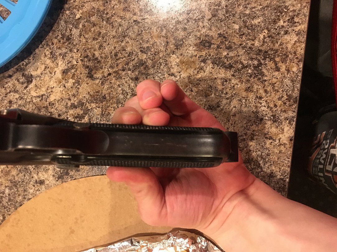

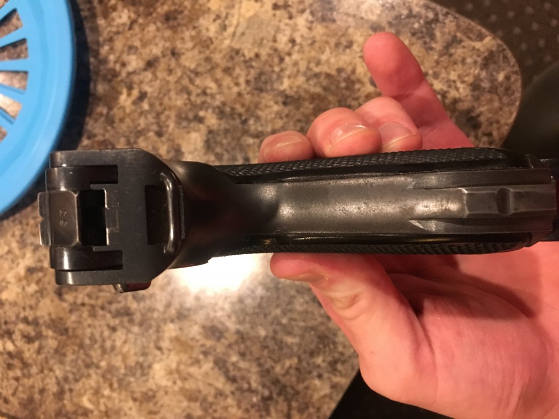

I do believe that when they are asking about the grip straps they are asking to look at the parts of the gun as shown in my pictures attached here.
