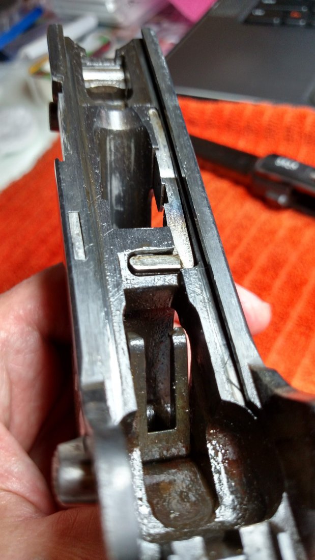

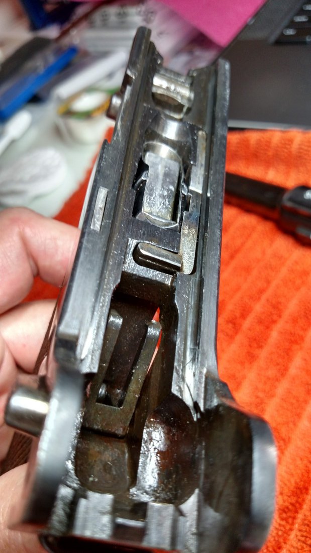

Got this Luger about 10 days ago, had some problem getting toggle to lock open. With some effort it would lock. Now it won't at all. Mag in, Mag out, safety on/off the toggle won't remain back. I've attached a few photos, can see what I think is the "hold open latch" (#26) up with the mag in, button pushing up. Drops down when mag removed.
I've cleaned the gun when I got it, field strip, nothing nuts. Have not shot it as no .30 luger locally so ordered. So no reference on what happens when mag empties while firing.

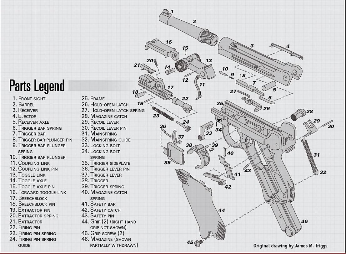

Any thoughts? I've included a numbered parts list for reference. Thank you in advance
Looked at links below for help. Please refer me there if that is the answer
http://forum.lugerforum.com/showthre...e+won%27t+lock
Sorry, photos of toggle and breech are a bit crap, couldn't get phone to focus on the near field.

The advice in the other threads is sound. Looking at your photos, the holdopen spring and basic operation appears OK. I've fixed this issue a few times and here are my bag of tricks. Basically I go down the list until the issue is fixed.
1. Push up on the mag base while attempting to hold open. If this results in improved performance, that is helpful to know although it doesn't immediately fix anything.
2. Remove the grips, operate the action and see if anything changes. If yes, the grips are somehow causing a bind.
3. If possible get a Luger that holds-open correctly. Carefully measure hold-open height when deployed. Compare the engaging surfaces of the hold open and the notch on the bottom of the breech block for wear.
4. Try a new Mec Gar magazine. Lugers can be magazine sensitive. Consider trying several magazines in search of one that will make the pistol hold open (I once tried 5 magazines to fix one pistol).
5. Ask G.T. to replace the spring in the Mec Gar with a stronger one. His contact info is available via a search.
6. Replace the hold-open spring.
7. Replace the hold open itself.
8. If, by comparison/careful measurement vs. other Lugers, you can measure that the hold-open is not going high enough, consider carefully removing metal to allow it to go higher. For most people this means send the gun to an experienced Luger-smith. I have done this myself on one pistol but don't recommend it to home gunsmiths unless you are absoultely sure of your skills, tools, diagnosis etc. Otherwise you can screw things up.
So far I've not had a Luger hold open function that could not be fixed with these steps. This seems to be a common malfunction and can be tricky to fix, but I can attest that is also satisfying to fix. If you don't want to do the above steps, pros like G.T. and Tom Heller are wonderful resources. Good luck and let us know the outcome.
When a Luger holds-open OK via manuel operation, but will not hold open with live rounds, sometimes that means the mainspring is too strong but it doesn't seem like you have hit that issue.

Just a couple things to add:
- the edge and the notch in the bolt look worn- though the pictures are too fuzzy to really tell.
They must be sharp and correctly angled to work correctly.
- I don't know where you can "remove" metal to make the hold go higher??
- Often it is simply a mag that rides too low, if you push up on it and it works- that is the issue.
This may be due to the mag or the mag catch.
- hold open springs, especially replacements, can be too strong
- the button on the mag is too small in diameter on some replacement mags, and original buttons
can be worn, I've seen them flattened from wear on one area, you can rotate the button to a new position
Hope this helps.

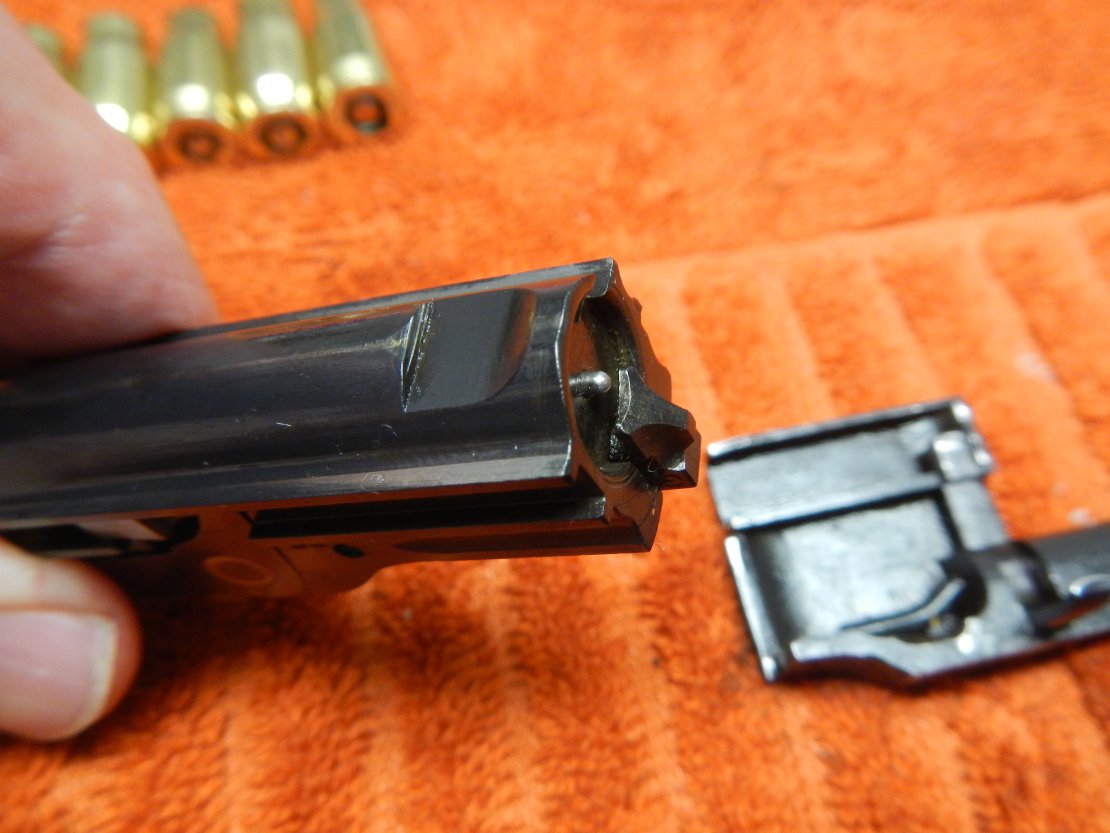

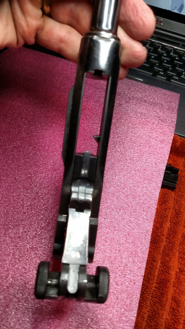

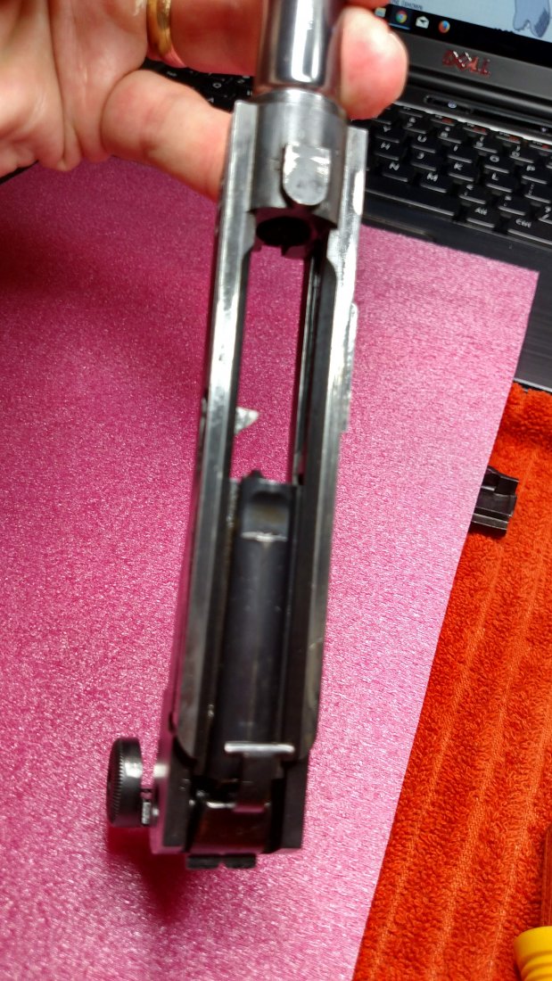

DonVoigt, you mention the notch in the bolt may look worn, I have a better photo attached now. No expert but looks OK with a minor wear indication (may be trying to convince myself) the Hold Back behaves ideally when I put pressure on the bottom of the magazine--100% compliance. I've ordered a new Mag as well.
As I look at the old mag I considered wearing away an RCH (very very thin scale of measurement) of metal at the top of the slide. My concept was to mark a thin line with silver sharpie and then grind away with a dremel until the silver ink is gone. The button would now go up just a bit more and press on the Hold-Open Latch raising it up a bit--as if I was applying pressure from below. The only concern I have is the "follower" might rise a similar amount and then cause additional issues. Has anyone tried removing a bit of the channel as I've indicated with any success?

Yes, I did this once to try and improve hold open function. I discovered exactly what Don said-the follower kept it from rising. It didn't work.

The bolt notch looks fine when in focus! That's good.
What type mag is that? It doesn't look shaped just right at the top.
Could just be a worn notch in the mag or the mag catch itself, or a defective mag.
Usually the follower is stopped by the feed lips, at about the same time the button stops in its slot.
DonVoigt, the original photo was crap, yes clear here and looks good, so that is good news. As for the type of mag....."uh a black one"? No idea? How could I tell, just poured over it and it has no markings I can see.
F15E_WSO is offline   Reply With Quote
