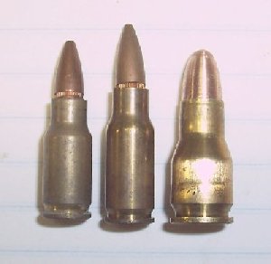

Thank you very much for the photos, history, and how-to do it. I really get into the unusual I guess, and start thinking...what if?? It keeps me occupied and usually broke also. I guess I never could be totally satisfied with the run of the mill things. I am not sure that I made some better or worse, but I usually liked the outcome.
Not all my attempts were successes...I'm still having feeding problems with my .223/30 Luger, .223/30 Mauser, and my .30/45ACP...
I have faith in your skills, and with enough time you will figure out the feeding problems....LOL Those are great!!!
Unread 01-22-2013, 04:19 PM   #6
Try using slightly smaller weight bullets in the .223's like bullets designed for the .22 Hornet. You may find using these round nose bullets to cure your feeding problems.

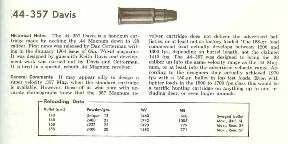

I've been doing a lot of reloading lately, and also have some new acquisitions which I am getting the required die sets for. One will require two different die sets, and while browsing through an old COTW, I found the '44-357 Davis' cartridge listed. It's practically the same as my 357 Automag/44 S&W Magnum wildcat. Both differ from the 357/44 Bain & Davis by not having the long tapered neck.
I can't find any reference as to why the 357/44 Bain & Davis had the tapered neck. Extraction was never a problem, even with Jim's hot loads. Maybe just to make it different???
Just goes to show that great minds think alike. Separated by 30 or 40 years, but the same basic idea.

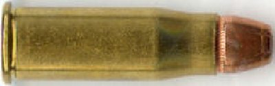

For those two of you out there wondering what the 44/357 B&D looks like here is a pic of one...
The site I got this from says the longer taper was because B&D thought there would be problems with 'setback' so they elongated the neck-to-body transition...
I've been reloading since the mid '70's and have never heard of 'setback'...I may very well know it by another term, but 'setback' is a new term to me...

Thinking back, I believe I remember two versions of the 357 B&D. I think the basic difference was in the shoulder angle. One was much sharper than the other later one?
Those would be the two I posted in the last two days. Both are said in the articles as being developed in 1964 by Davis (the sharp shoulder) and Bain & Davis (the sloped shoulder).
