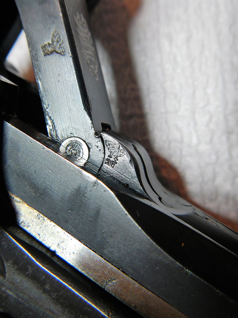

Good morning all,
Happy to be new to the Luger forum as I now have my Dad's Luger back!! After looking at this forum and photos here, it is clear once again that "maintenance, care and feeding" was NOT one of my dad's strong suits!!
I poured over the markings in this pdf catalog https://www.selfdefensefund.com/wp-c...7/09/Luger.pdf but not much help.
There is adequate matching of the S/N 3825 (25s) throughout the mainbody but things get sketchy after that...Standard DWM across the top and then things begin to unravel. No S/N on the barrel, two proofs that I can't make out on the barrel along with the calibre (7.65).
Trying to upload photos, here's link to imgur for album there. https://imgur.com/a/qmTkMvV Imgur photos will be larger, better for zooming.
If I could get some feedback on the ID of the gun would be thankful. Will gladly post additional photo, zoomed/macro'd as necessary to help anyone kind enough to help me.
Some provenance on the gun; family from France, fled to North Africa during WWII, returned to France later. I know my father had the gun in the US for past 55 yrs. Don't know if he got it in Europe Post-War, picked up during war? And everyone is dead now so can't ask them.
Finally, will break down gun and clean and start to refurbish.....If I could also ask that you list the first 3 things you would do regarding getting this luger back in health.
Thanks in advance

How about a picture of the top of the chamber? And a better picture of the circular marking on the right side of the receiver.
So far, I can see the DWM receiver was re-barreled commercially and re-proved in Germany.
The E/N is a nitro proof, and the E/J an indication of re-buliding/replacement of the barrel.

Top of the chamber is just that, toggle open or closed your choice.
should be some markings there, unless removed.
Unread 07-29-2018, 09:54 AM   #9
Judging from the markings on the right chamber area, this pistol was never completed by DWM during WW1, rather the parts were assembled later (after 1939) by a licensed German gunsmith, showing an overabundance of his test firing proofs. The circular marking, with the cross swords, is a British proof house markings, that was required to sell foreign made pistols in GB. TH
Thanks for making sense of some of that overlayed stuff. Like "overabundance of his test firing"!! My grandfather left France from Dunkirk and was an Instructor Pilot in the UK for a short time and then sent to Canada to teach there. Maybe he picked it up in the UK?

The only thing I see that is really out of place is the mismatch rear toggle.
Unread 07-30-2018, 03:12 AM   #13
Thanks: 2,078
So, what I see is a DWM luger, made WWI era, later rebarreled into 30 luger, with lots of interesting acceptance and proof markings.
Unread 07-30-2018, 09:22 AM   #14
As Ed says, I'll add that the receiver is from an artillery luger.
The proof marks of E/N and E/J are according to the German law proof law of 1940.
So this re-work/re-build of a WWI era luger was done after 1940 and before 1945.
Large and small factories were doing these "re-works" and the circle on the right of the receiver is likely a trademark or maker/seller mark from the 1940 era(JMHO).
Vono and Anchutz were large concerns doing this- but this is not their mark.
It IS Luneschloss; (but I do not recognize the mark and have not seen it before).
Update: 8-18-2018, Klaus says it is Franken and Luneschloss, see post below!
I do not believe it is a British/English proof mark, as it is not the correct size, style or location- though it could be a retailer mark- and would have to post date the 1940 time frame of the pistol if English- later than 1946.

After further thought, i agree with Don above. TH

I agree it is not an English proof mark.

...reworked by Franken und Lünenschloß

Yes Sir!!! That is clearly it. Thank you for the find and tying the proof to a name. Well done.
