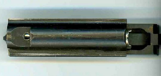

Here is a modified breech block, Not sure if it is Norwegian or Finnish?

This pressure relief modification is found on many Finnish m23 Lugers. Did the Norwegians make the same modification?

Default both pins!
That would probably work even if the pin is not relieved?.... GT

Yep.
