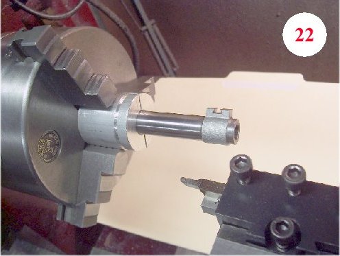

If you have a barrel vise and a Luger receiver wrench, it can be a quick & easy job. The barrel vise insert can even be used in the lathe chuck. The pic below shows a member doing something with a barrel that has been removed from the receiver. The aluminum insert is a two-piece part, and the chuck is a 3-jaw. I assume the member centered the bore before machining.
G.T. has considerable experience in Luger barrel work of this kind.

Rich has it pictures perfectly!!!!! That is Exactly how you do it, although the "less" lathe you have, the closer to the chuck jaws you want the work to be?... .... Excellent pic Rich! ...til...lat'r...GT
