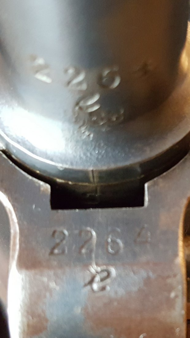

I find a very nice all matching 1918 DWM artillery luger in local gun store. It looks nice but I have a question.
There is no letter (a or b) under the serial number on the bottom of the barrel and the frame. Is that correct? And I can see a circle N on the frame. What does it mean?
I am attaching a picture from this forum which show that letter under the serial number.
Sorry, I cannot take a picture of the gun that I saw.
Thanks!

We can't be certain without good photos, but the lack of a letter (suffix) may indicate that it was one of the early 9999 mfg. that year, before they started over with the letter A. Not an issue either way.
The N may suggest a commercial gun, not sure on that one.
Unread 02-28-2018, 04:33 PM   #4
1918 DWM LP08s have serial numbers running from no suffix to j suffix.
