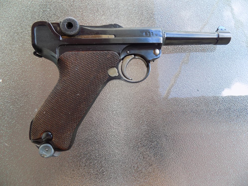

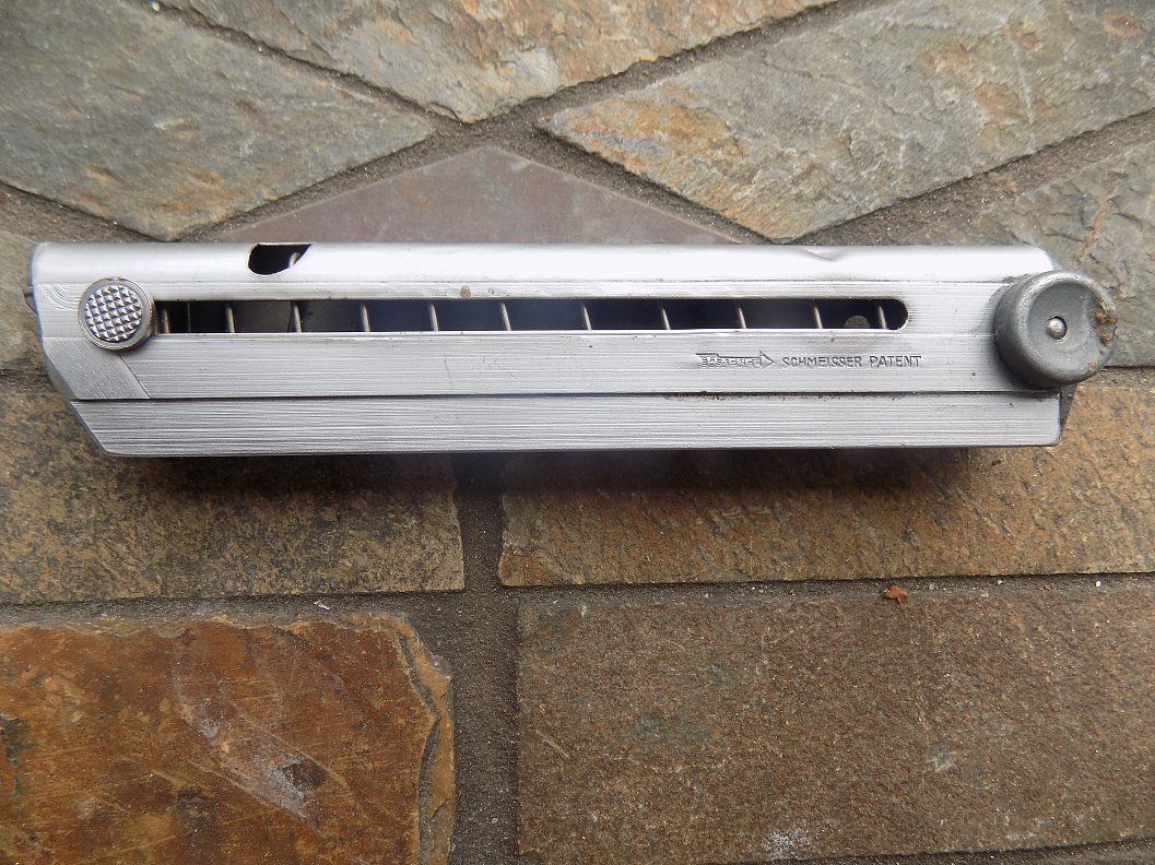

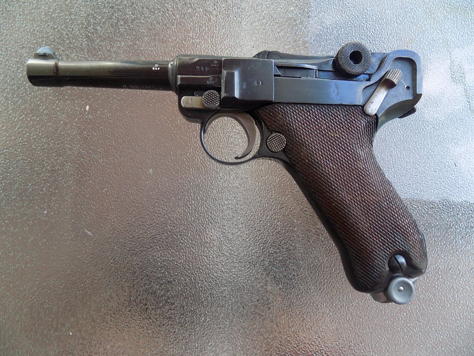

Default George Andersons' Shooter Mag!
George Put this pretty together when I told him I shot our 1914 DWM Artillery! The Mag is much heavier! Tks for your input!!

Eric, I noticed that the magazine tube has a dent in it... GT can iron out that dent so you won't even know it was there...
