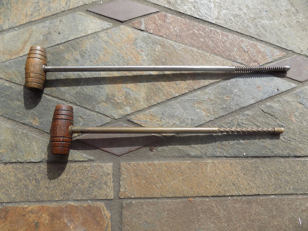

Default How Nice~
From Uncle George~ How about all brass?
Unread 02-13-2018, 03:08 PM   #3
I found my other~
Unread 02-13-2018, 03:36 PM   #4

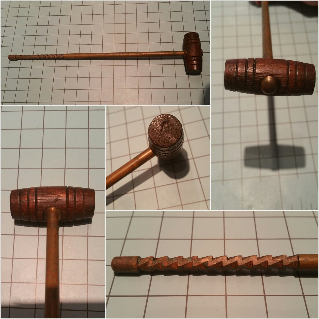

Default Early Navy Rod
I believe this is authentic
Unread 09-13-2019, 10:22 PM   #7
I don't think so.
Norm

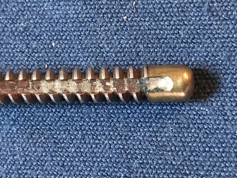

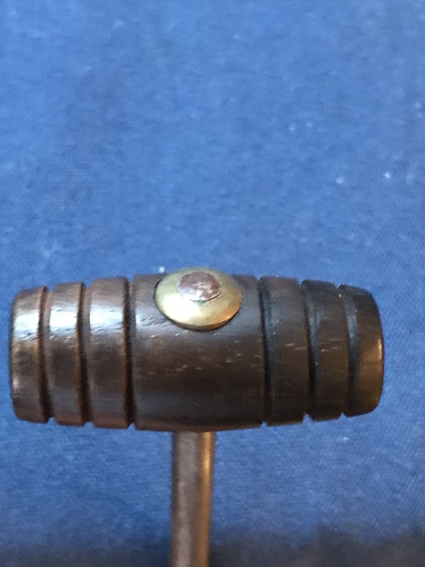

Default Navy Cleaning Rod, Brass Tip
New to the forum, not new to Lugers. Picked this up some years ago.
G41M is offline   Reply With Quote
Unread 08-12-2022, 09:32 AM   #11
Hi, and welcome to the forum! Your Navy rod looks good to me, but to be certain check it out against the original drawings.
