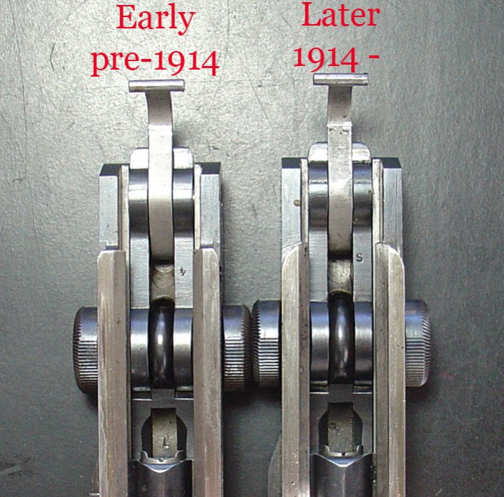

This photo illustrates what I was trying to explain about the cannons

Thanks for the picture, it clearly shows the difference.
But, the difference does not affect the interchange of the upper to lower. The rails are the same width as the "ears" and thus would pass through the same area- but they don't come back that far.
I just tried several early/ late combinations and confirmed the above conclusion. There may be a combination that will not work, but I have not found it.
I'd rather think the the longer curve of the later receiver aids in re-assembly- making it easier to start the receiver on to the frame rails.

I just tried an early/late combination with success. My concern about the different cannons is based on an upper/lower (1910/1917) mismatch shooter. When I received the gun, there was some drag in sliding the cannon in the frame and I discovered that the very back of the cannon rails were slightly mushroomed. I had assumed this was from contact with the reinforced frame and filed them to the "new" profile.
KFS
Unread 01-15-2018, 11:30 AM   #13
Karl,
I just tried a couple more, and found that my 1908 DWM comes up slightly short on a Mauser frame.
You are correct that filing the rear edge to the rounded contour will solve the problem.
It appears that the curve at the rear inside of the frame must have some variance from early to late and mfg. to mfg!
Thanks for you pictures and input. It is a good day when one learns something new or different, especially with all the ins and outs of lugers.
Miles,
check for full travel, and if need be round the rear edges of the rails on the upper!
