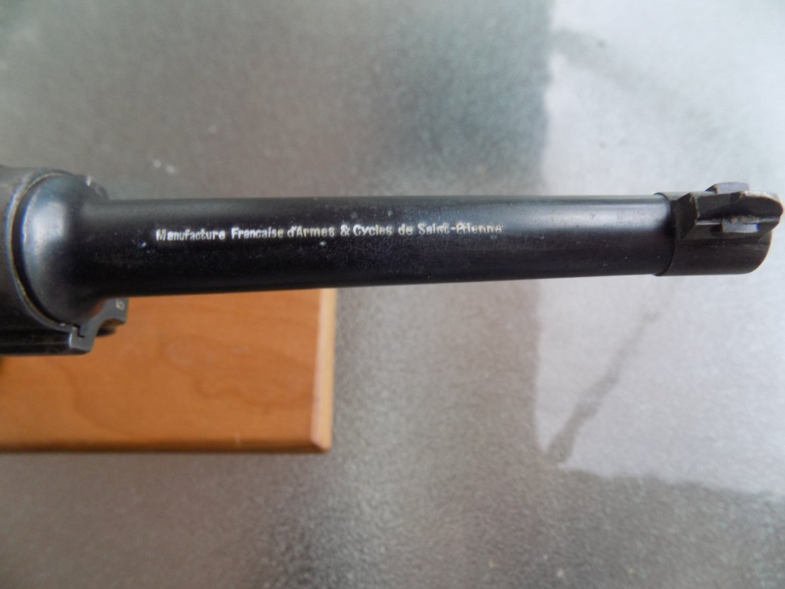

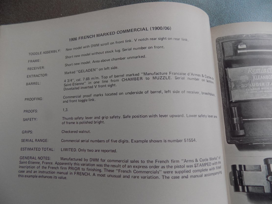

Thank You Greg~The beauty of lugers there is one for every taste, condition price! My first was a 1906 French as I spent 2 summers living with a prior Basque resistance family in Bayonne France. You never forget your first or last!

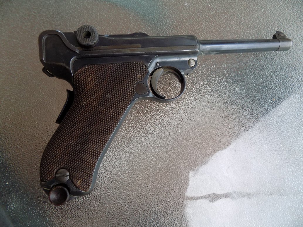

Unread 01-07-2018, 10:02 PM   #11

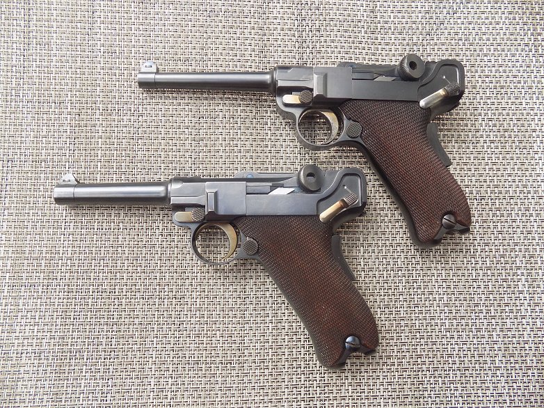

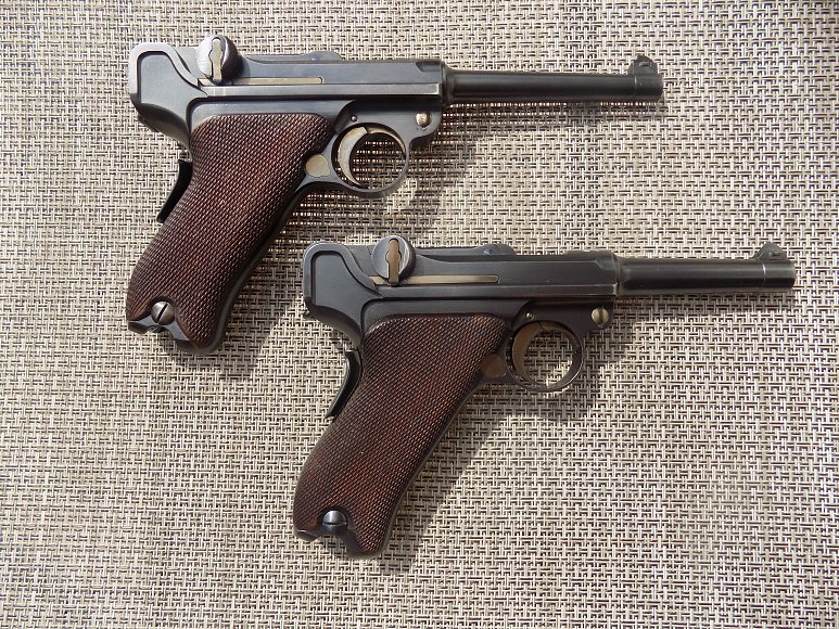

The 1900 was the US test gun and 1902 For commercial sales! The 1902 was the first 9MM, only around 500 made! On its face is "Germany" The test luger has no such marking!

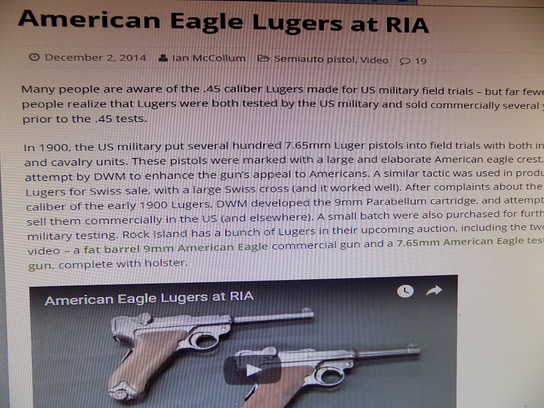

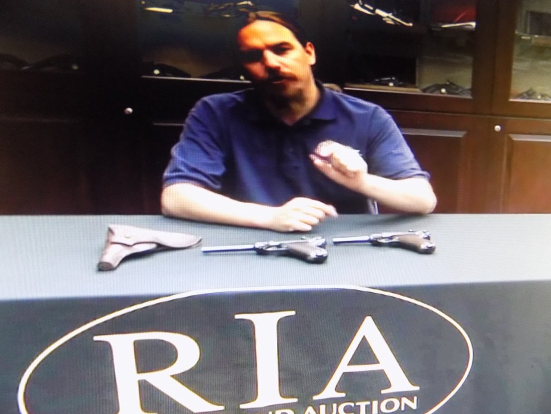

Unread 01-08-2018, 12:38 AM   #14
Heres A Reminder Eagles~ https://www.forgottenweapons.com/ame...lugers-at-ria/

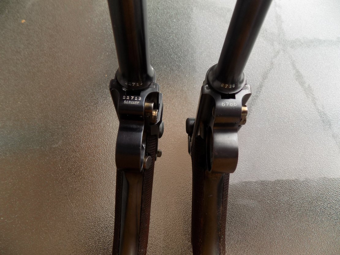

Unread 01-08-2018, 11:36 AM   #16

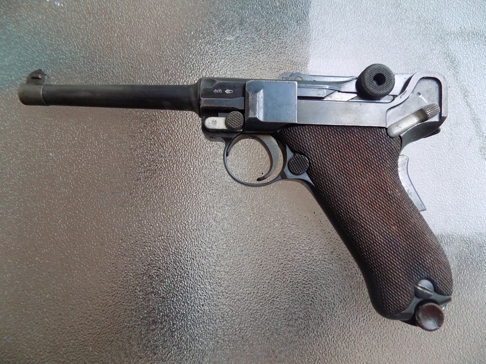

Import marking on 1902 fat! No inport marking on 1900 Test Luger?

Unread 01-08-2018, 11:37 AM   #17
Thanks: 1,119
No, export. Country of origin marking was a requirement of the 1890 Tariff Act (commonly known as the McKinley Act) for goods imported into the US. Therefore, the marking was applied by the country that exported the items.

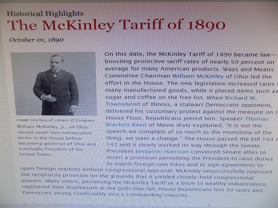

Unread 01-08-2018, 12:11 PM   #18
Ron Knows His Stuff~ https://en.wikipedia.org/wiki/McKinley_Tariff
Unread 01-08-2018, 12:26 PM   #19
http://history.house.gov/Historical-...ariff-of-1890/

Unread 01-08-2018, 05:05 PM   #20
Thanks: 1,119
No, that is an export mark on your Fat Barrel. And you already know there isn't supposed to be an export mark on a Test Eagle, that is one of the distinguishing characteristics.
