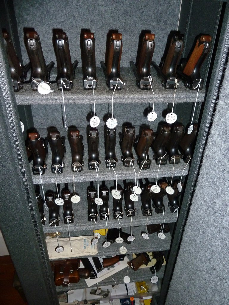

I store my pistols in a gun safe. The shelves are lined with a synthetic fabric. The Lugers stand on their heads with inventory tags hanging from the lanyard loops. The other pistols lay flat.
The following 3 members says Thank You to George Anderson for your post:

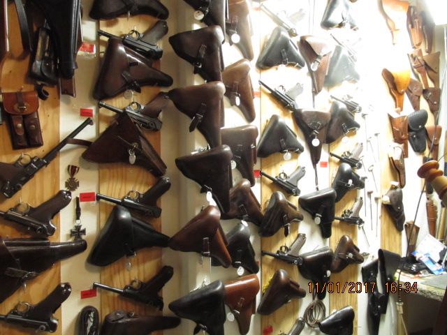

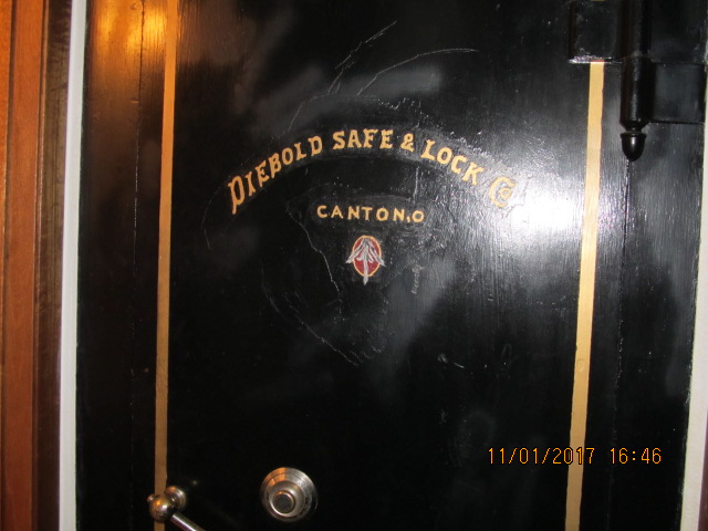

All my firearms are in a vault (room) we had built with the house. The door to the room is from an old Idaho bank. I don't worry about storage and have never had a problem in 60+ years. I do put a liberal coating of good old 3 in 1 oil inside and out. I give them a good cleaning once a year. More for fun than functional. I never store in holsters or cases of any kind. We all have different methods. If it works for you and has for years keep it up. Too many variables to have one surefire method. Bill
The following 5 members says Thank You to wlyon for your post:
