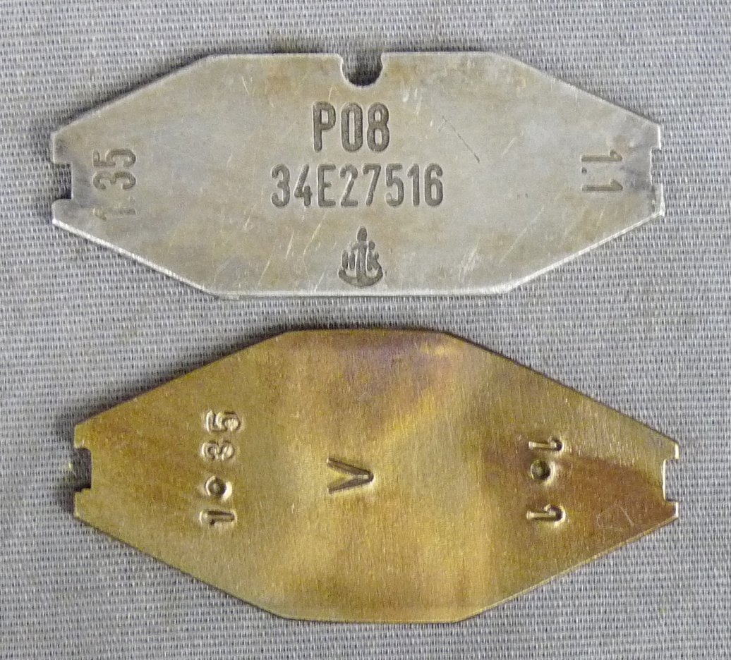

I once was sent from Europe a German gage(said it was from a war time bunker) for checking firing pin protrusion, just two notches, one on each end, go/no go; with a bunch of stampings. As usual, firing pin protrusion has to be checked at times I suspect; not a new requirement by any means.

Hi, I found that when setting up the head space in the new barrel that I couldn't find a case that was on. 754". So used a case that was 0.750" and used a piece of paper as a feeler Guage as it is 0.004"thick. Shown in photo.
Perhaps Military Ammo has crimped primers to make up for the variations in head space, maybe a reasonable knowledgeable members may be able to let us know.

No, crimped primers would not "make up" for headspace.
Military weapons would have correct head space, and if a problem developed, they would have been repaired.
To the comment above, on suitability of your make shift head space gage, while much better than nothing- a guy who can thread and turn a barrel can make a steel head space gage without problem.
Should be a quick and easy project, dimensions are to be found on line.
