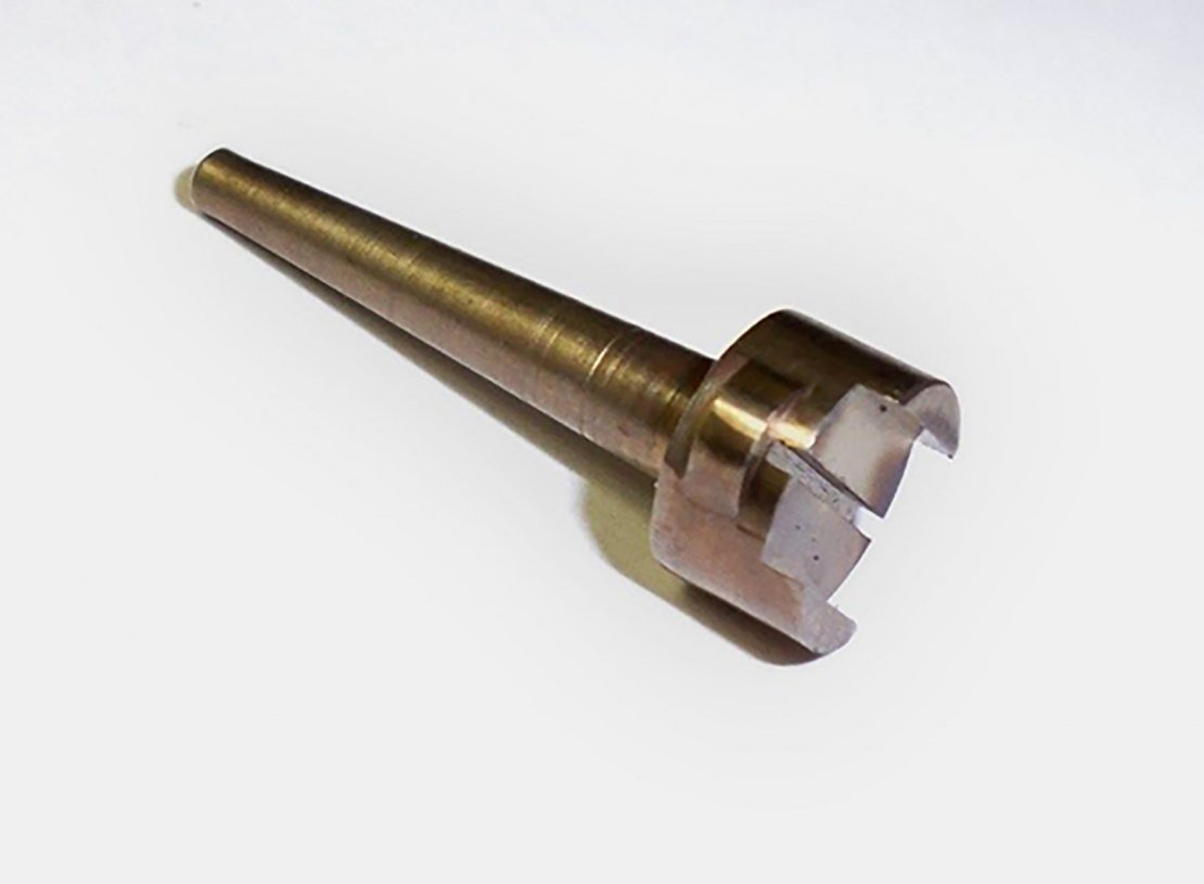

While reassembling my 1923 shooter, I ran into a problem. After putting the firing pin, spring, and firing pin spring guide into the breech block, I wasn't able to depress and turn the spring guide with my finger so I used a screw driver instead.
I mistakenly pushed too hard and turned the screw driver. The result is that the firing pin spring guide is now jammed into the breech block and I have no way of removing it.
Photos are attached.
Any suggestions?
Thanks in advance for anyone's help!

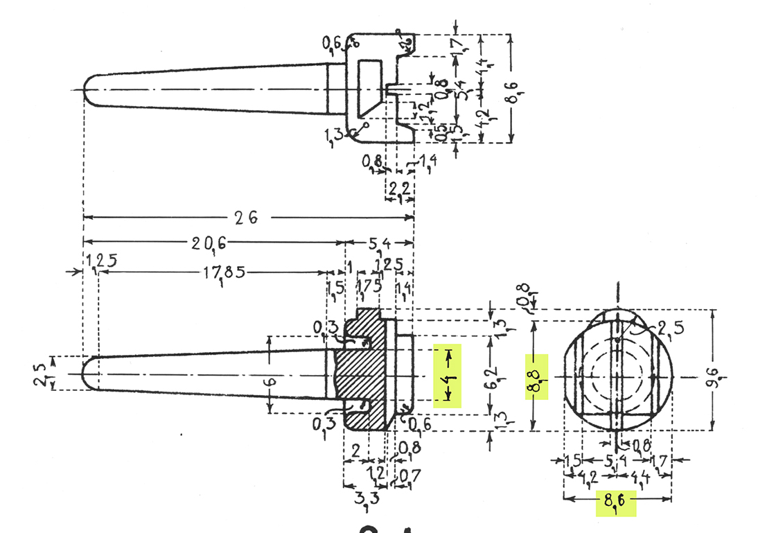

After studying it for a long time with a 10x loupe, it appears the top of the guide is slightly off center with the edge being caught by some small protrusion inside the breech block.
I also looked at the Luger blueprints I purchased from John S. years ago to see what might be in the breech block that was keeping the spring guide from coming back out. If my breech block was made correctly, there shouldn't be anything restricting the guide rod.
On the top of the guide rod, the plans showed nothing out of the ordinary except that it is slightly oblong (see plans below).

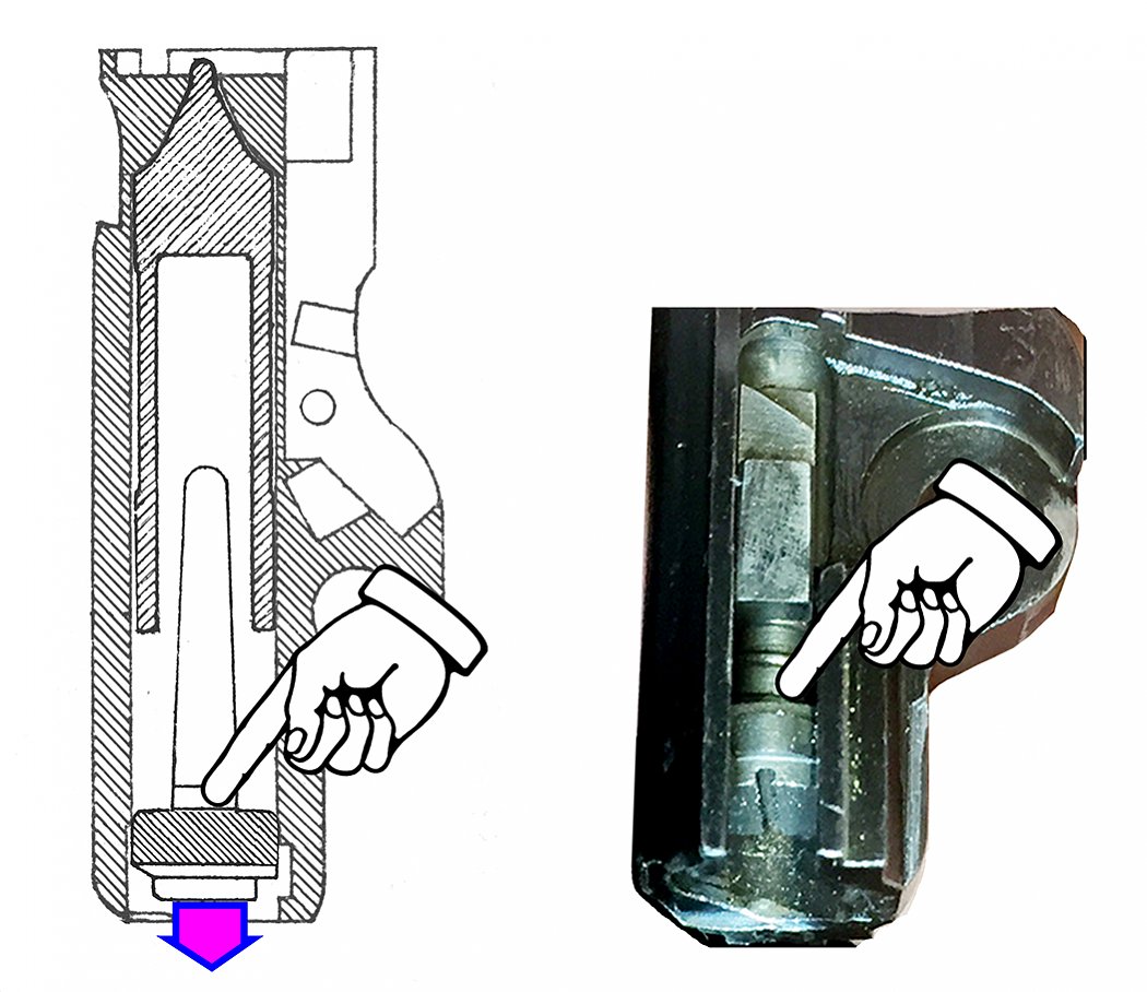

After much thought, I finally came up with a solution to the stuck firing pin spring guide rod.
In anticipation of the worst (having to drill out the stuck rod), I purchased two replacement rods. I even built a special jig to hold the breech block in a drill press vice without putting too much pressure on the machined sides. The last thing I wanted to do was distort the breech block. The rod was expendable, but not the block!
When I finally figured it out, the solution was surprisingly simple. After looking at the plans and carefully examining the disassembled breech block of my other Luger, I came to the conclusion that the rod was merely wedged in. It wasn't caught under a "lip" and the locking cam was nowhere near the locking slot in the block.
In the end, I simply placed the block vertically on the desk, with the firing pin pointed straight up and the end of the guide rod straight down. I then placed the tip of a needle nose plier on the upper edge (see diagram below) and gave the side of the plier a rap with a small hammer.
The rod jumped right out! Amen!
Under the loupe, everything looked none the worse for wear. But, before reassembling the pistol, I took a piece of 2000 grit emory paper and gently polished the sides of the rod where it had been held by the breech block. I didn't want another experience like this one!
Thanks to all for your good suggestions!
Dave in TN
