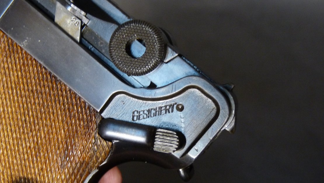

Pistol has been refinished - during rework. It must have been in pretty rough shape, as the original navy markings on the left chamber are quite weak, and the added serial number there much stronger. Usually the sear safety is added after finish, and the rivet is "in the white" , in this example, the bottom of the pin is blue- but it does show a pin prick after finish, in the white-perhaps to tighten a loose rivet?

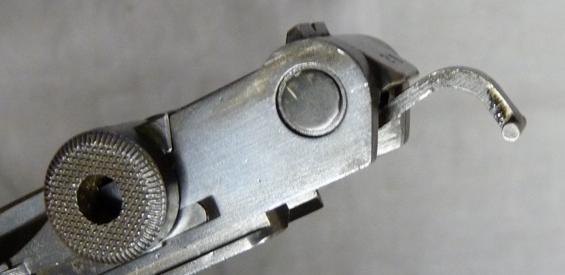

A good example of the serial being added to the left chamber after original mfg, i.e. at rework. The original take down lever and side plate are numbered on the bottom in the Navy/commercial style and -interestingly-the side plate has the added "28" in exposed fashion, but the TD lever does not. The replacement small head toggle axle/pin is not numbered, though one would expect it to be; shown with the correct original type pin below.

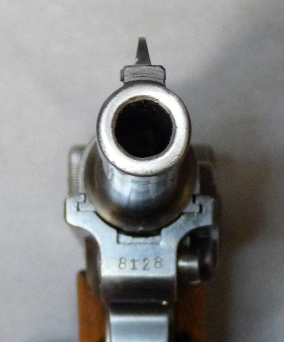

The TP marked and proofed barrel is not numbered, but the bore gage of 8.82 is present.

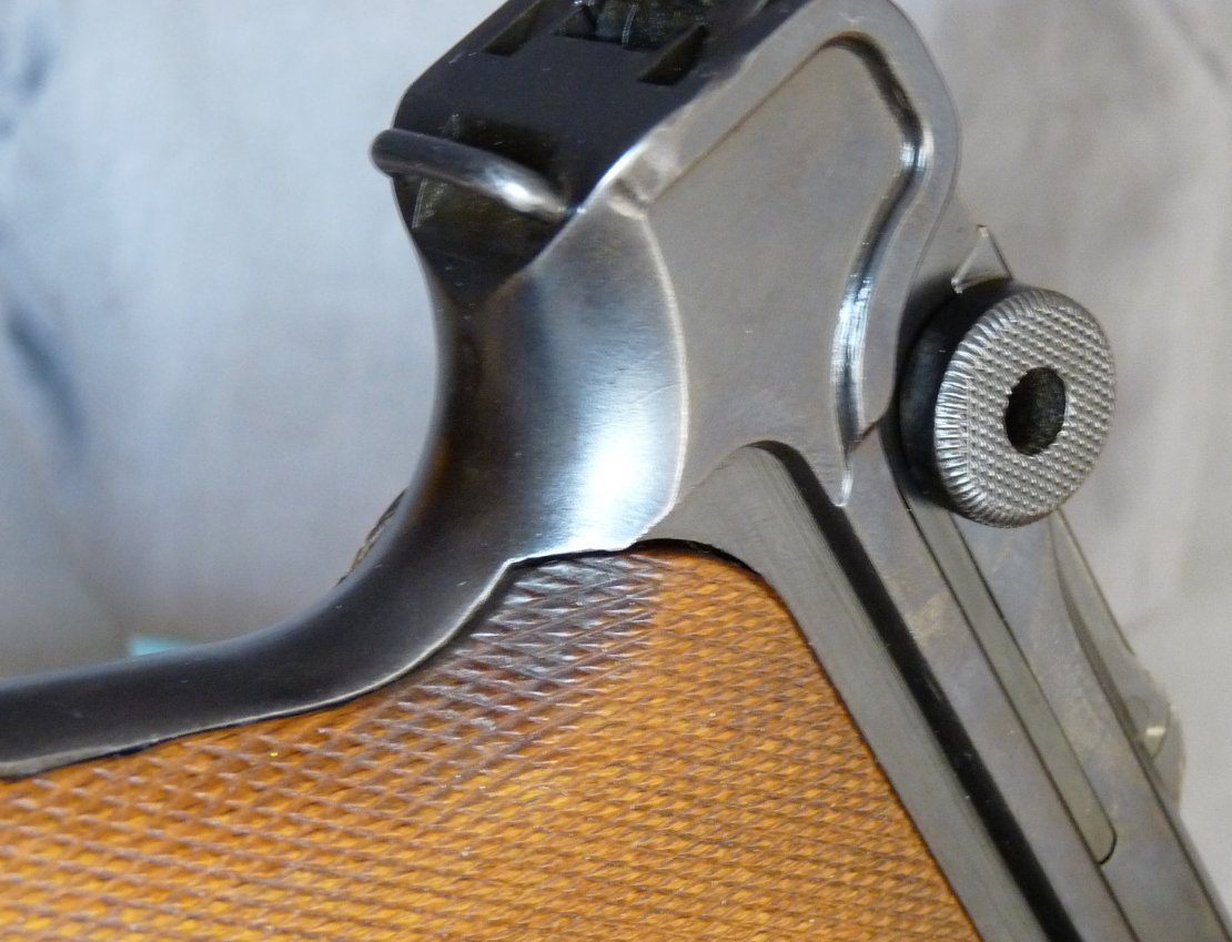

The finish applied is interesting as it appears to be hot blue on the frame and receiver. The toggle train and the sear bar do not appear to have been refinished during re-work. Edges and corners were well maintained in prep for the refinish, notice the lines and marks in the flats. The frame is blued on the inside as is the case with the hot, salt blue finish.

Kudos on putting all those circumstantial puzzle pieces together, Don. Nice work. I notice the crown of the muzzle is in the white, what do you think is up with that? Is the unpainted "GESICHERT" also typical of this kind of rework?

Don, excellent analysis of your pistol. I agree with your general thesis but think the rework may have occurred in 1935 or -36. The arming of the Gemeindepolizei with P08s was ordered in February 1934. In October 1934 it was acknowledged that this was going slower than planned because of the need to fit the pistols (presumably from the cache of these weapons) with sear and mag safeties. On p. 179 of HWIS, I note holster evidence that the stamp of the Berlin police armory changed from PTV to TP sometime in 1935.
Most Gemeindepolizei did not property stamp their P08s so the 1937 date terminating police property marks probably is not relevant for this pistol.
For what it's worth, my best guess for reworking would be 1935-36.

on the muzzle- i just "assume" muzzles were polished when the barrel was made, the barrel may have been completely finished before installation- I can't decide when the TP/E was stamped, sometimes it looks after finish. But prior "art" dictated polishing the muzzle, for aesthetic effect- as it makes no practical difference.
I have several or perhaps many police lugers that when refinished the safety marking was not filled in. I suppose this was too much work for little effect? JMHO.
