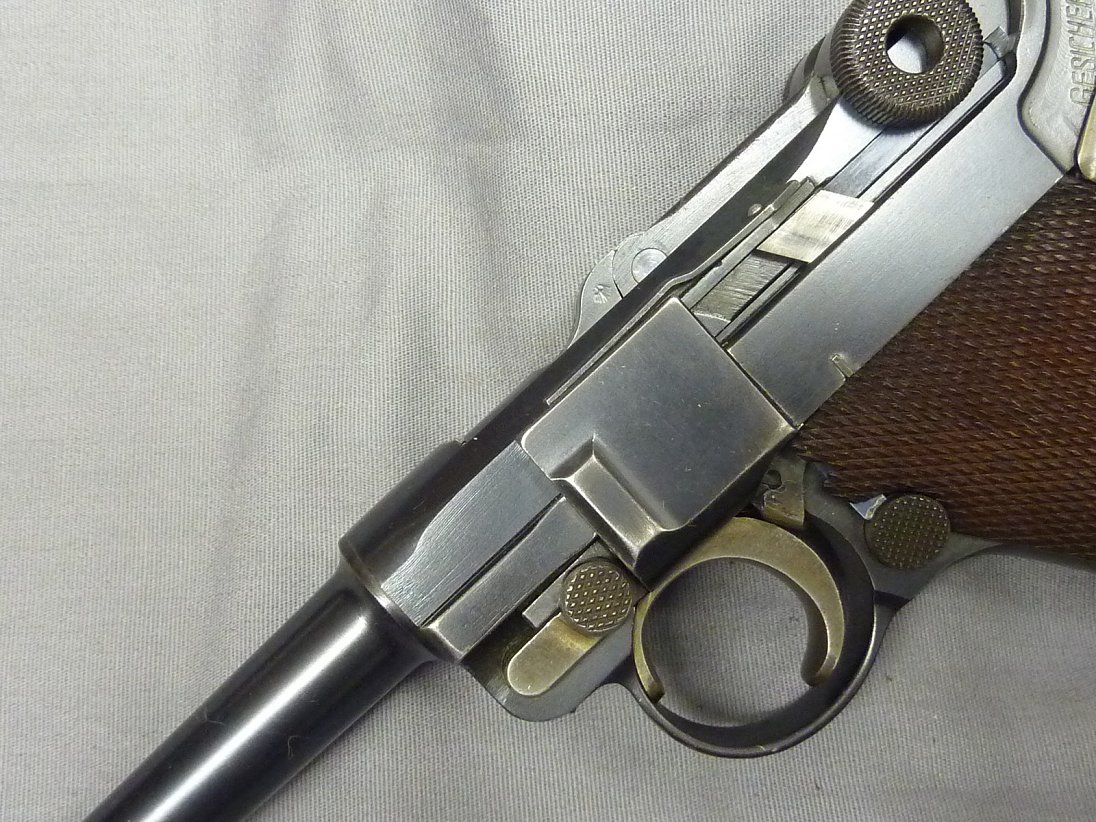

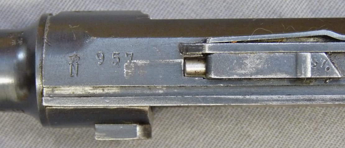

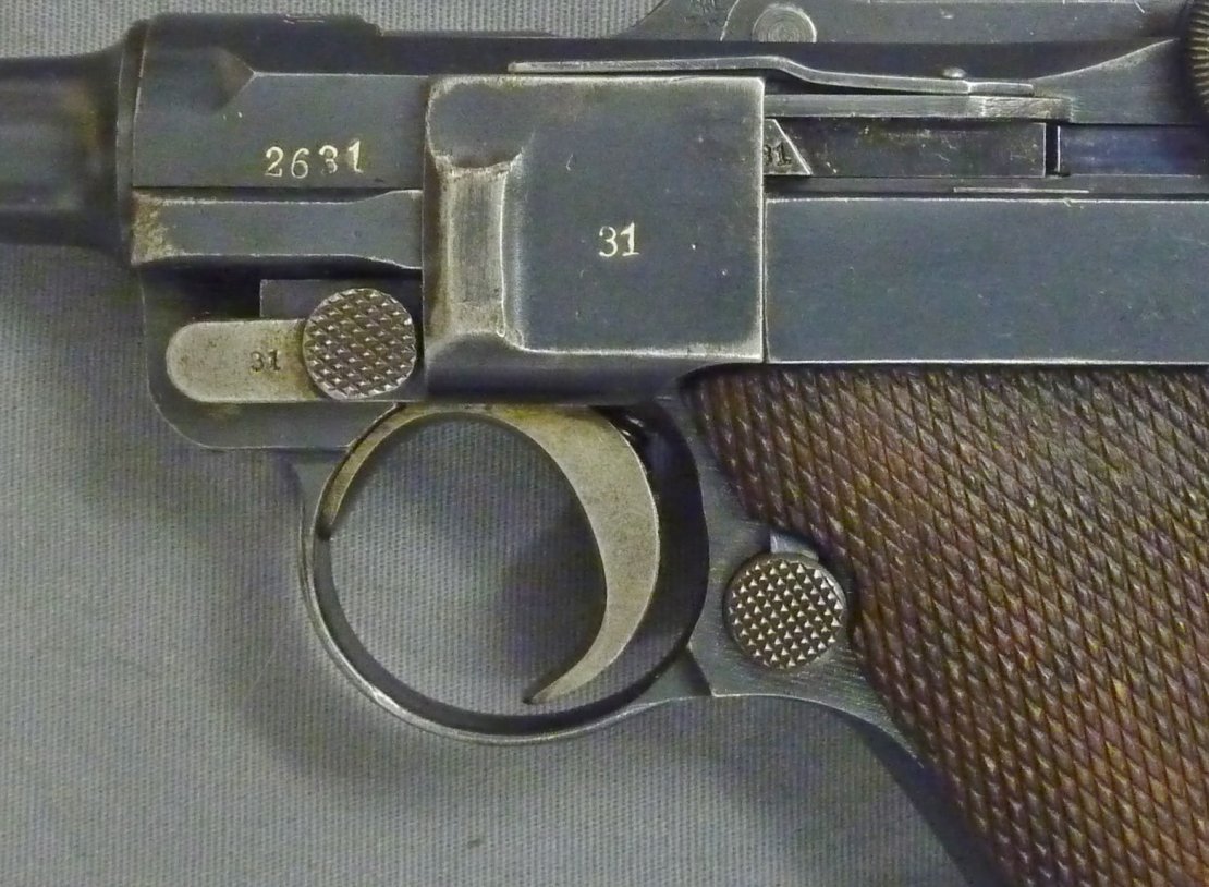

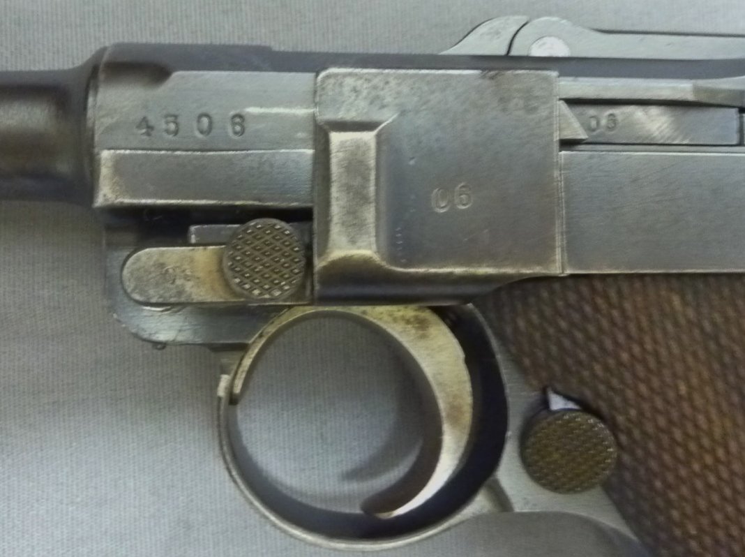

Here are pictures of a few police "reworks" I have with the added serial digits to the left of the chamber, and a couple that did not get them added. Remember that most of these reworks were refinished after the work, and all the markings are typically "under" the finish.
Hope this helps.
