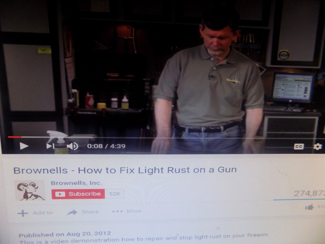

Another~https://www.youtube.com/watch?v=J41c-uWChmM

The whole idea behind using mild abrasives like 0000 steel wool is that browish/reddish rust is much softer than a blued surface. I have verified under a microscope that rust on Lugers is in fact quite soft - almost like a powder loosely attached to the surface, and that blue has far higher resistance to mild abrasion.
The trick is to use light pressure and lubricant with whatever abrasive you select, so that there is not enough pressure to damage the original blue. As Eric's video above shows, different abrasives are available. Cloth, polishing compound and 0000 steel wool are all types of abrasives from mild to more aggressive.
As rust progresses pits form and begin increasing in depth. IMO the difference between freckling and pitting is simply depth. As pits progress in depth, steel wool and similar simply cannot get to the bottom of the depression to remove the loose rust.

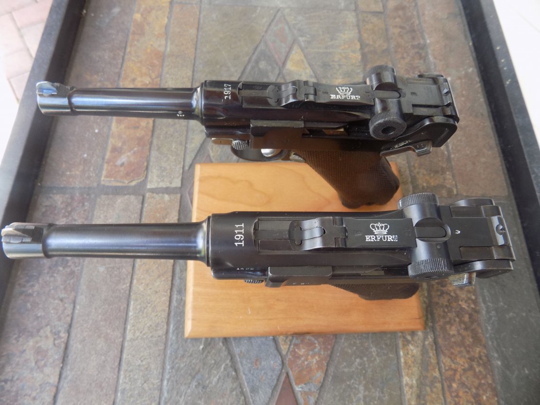

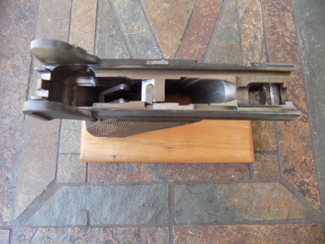

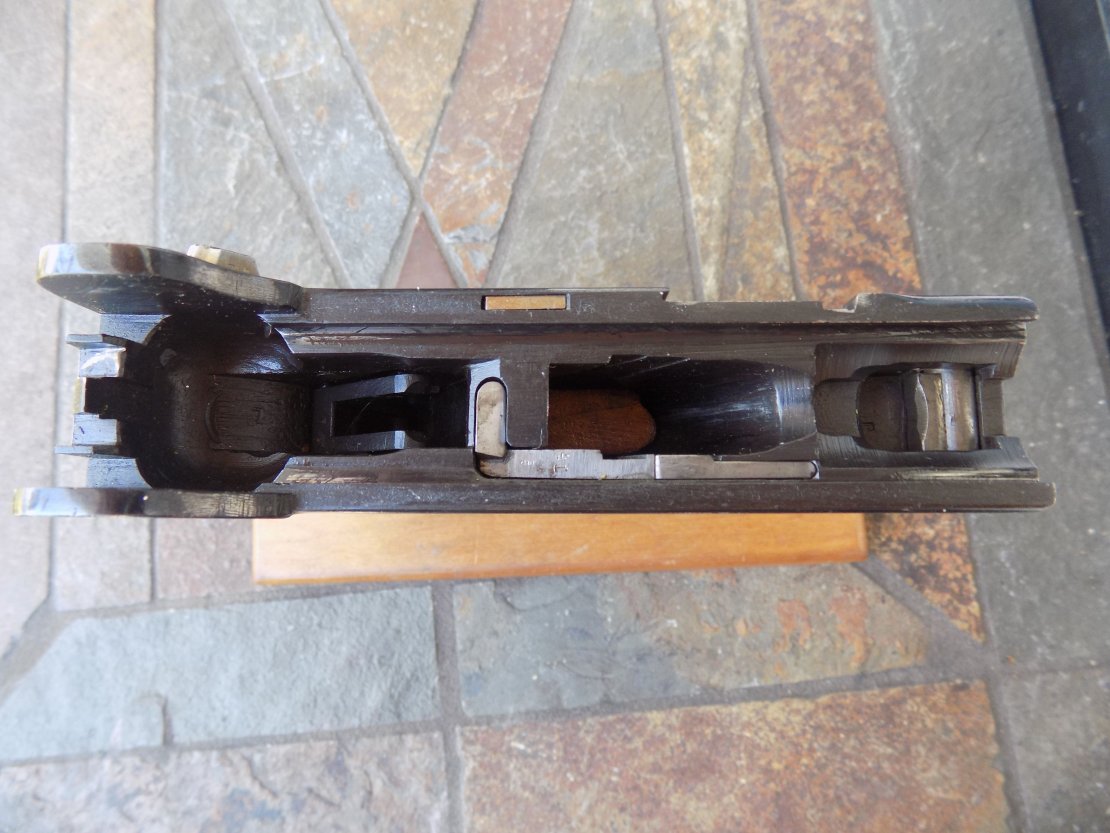

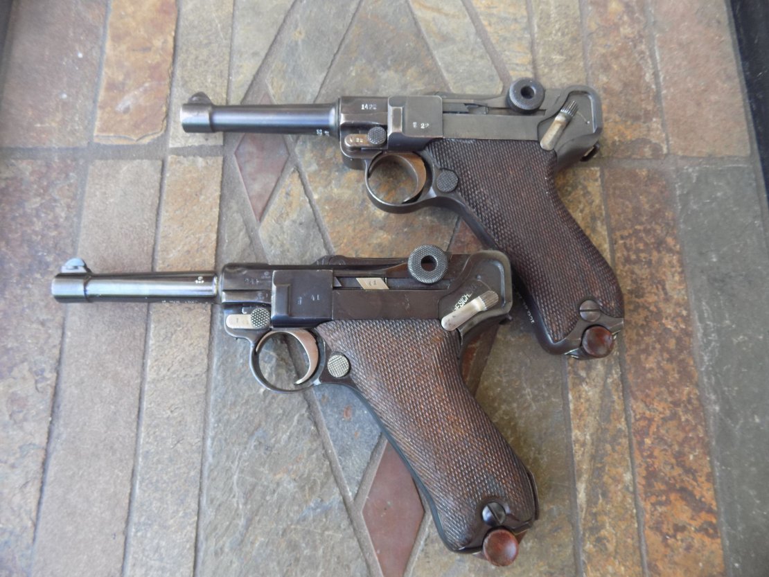

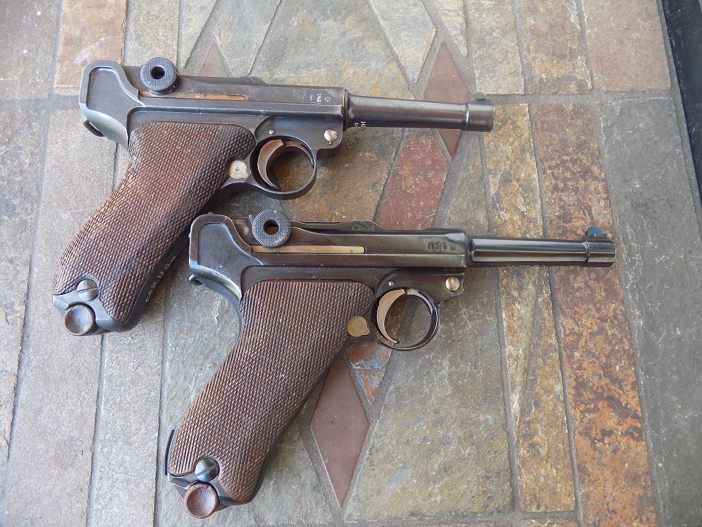

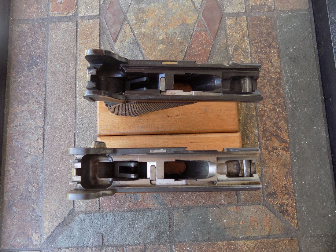

The Difference Between Original Blue And Reblued~

Unread 08-18-2017, 07:29 PM   #16

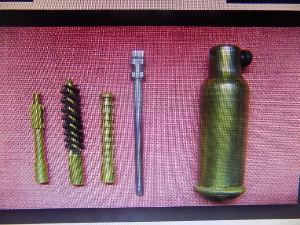

Were Luger cleaner kits issued to German troops like the Swiss?

Ted without searching somewhere, whats the difference with rust bluing as opposed to?
Unread 08-19-2017, 08:37 AM   #18
Salt Blueing. Salt blueing is a hot, chemical process, as opposed to controlled oxidation. I suspect that your second Erfurt has been Salt Blued, Eric. That's why it looks shinier and darker than your original. A quality rust blueing would have made the second pistol look much more like your original, albeit darker, given a finish with no age wear.

Thor
Thor's Avatar
Posts: 4,583
Thanks: 958
I believe alanint is spot on. I too looked at that barrel and thought salt blued. The interior of both should be in the white steel, like one of them displays. A lot of times if it is a "bubba blue" , the edges would be rounded too much and the safety not painted in. When you look at the flat surfaces, they wont look "flat" but wavy reflecting light. A bubba blue is easy to spot, yours looks better than that, but a reblue for certain. Also, they should have a rainbow or step strawing/fire blue color on the top of the hold open, not the spring that should be white.
