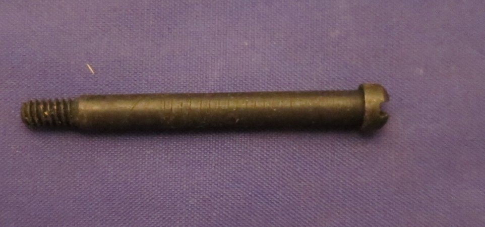

Well I don't know Don, just seem the right thing to do. The tap looked to fit and turned through with not much effort like it was following. If it's too small I'll make it bigger. Haven't been able to find just the screw w/o buying the complete hardware so worse case is I'll have to make one.

Good old ebay $10

ebay is full of goodies.

Old 08-07-2017, 10:58 AM   #34
Originally Posted by unitedcs View Post
Good old ebay $10
Great deal, hope you got it.
Threads look a little coarse, but then there is no reference.
I've pre-drilled and pre-threaded before, and at least half the time I then wished I had waited!
Maybe you are luckier than I am.
Old 08-07-2017, 12:17 PM   #35
Didn't you mis-spell 'goodies'???
Goodies. Fixed.
Looks being a replica. But it fits the role.

Thanked 30 Times in 15 Posts
Don, just an update on those threads. My ebay screw arrived today, ended up being a 6-32.

Old 08-09-2017, 09:15 PM   #37
Thanks for the info.
You can get an exact duplicate if you want one.
One of the forum members had some made- but they are not cheap.
