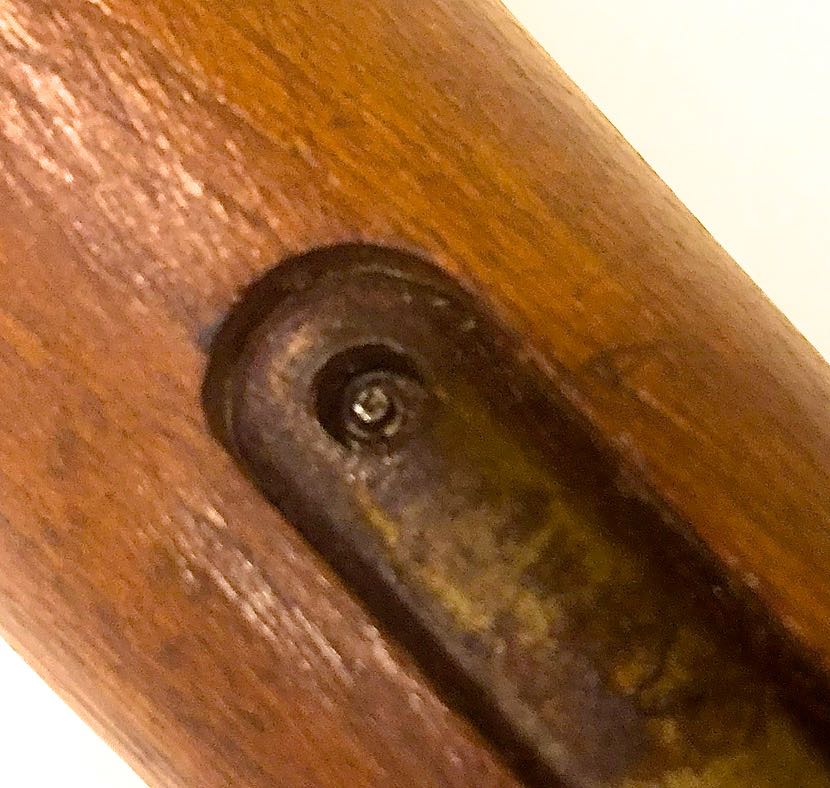

Hello all, I was wondering if anyone can suggest a way I can remove a broken screw from a C96 stock. It's the long retaining screw that holds the mounting bracket. The screw seems too small to drill and get a good enough bite on to extract. If it wasn't original I'd just drill it out and retap but the stock is orig and in great condition besides that screw. Has anyone ever run into this situation ? I clipped a sarco picture to show the screw I'm talking about.

Does the picture have anything to do with the question?
Other than it is a stock iron with screw?
Is the Iron still in place on the stock, with the screw in place- except head is broken off?
Then only chance is to drill the threaded end with a carbide drill, using a millng machine and remove the just out to the threads, then tap the screw body out the other way.
Clean out the threads or re tap to the original size.
A tricky and delicate procedure, IMO.

Yes that was just a ref pic. It's still attached. Guess I'm off to the depot for a couple of bits. Thanks for the suggestion.

Even with a center drill, it will be difficult to get the initial divot/hole centered. This is due to the thread and hole exhibiting an 'off-center' appearance. Looking at it as it is installed, the thread shows the apex on one side of the hole/screw and the root on the opposite side.
If the screw is 'finished' flush with the stock iron then there won't be any dome.
A tricky issue even for an experienced machinist.
I'd give it to Gerry Tomek!

Default delimma
Reluctant to drill it out and lose my threads. The head of the screw is missing, just a hole. If it was an aftermarket stock I wouldn't hesitate

Looks like some of the screw is sticking out of the hole. How about soaking with kroil and them grind a screw driver slot with a steady hand and Dremel and smack it sharply to loosen and try to screw out.

This is not the original screw there. Looks the tip is hex shaped, installed by a special tool. But this must be there for a long time and match this stock's overall condition. A new replacement screw won't make it prettier for sure. Downgrading for fun, I guess?
