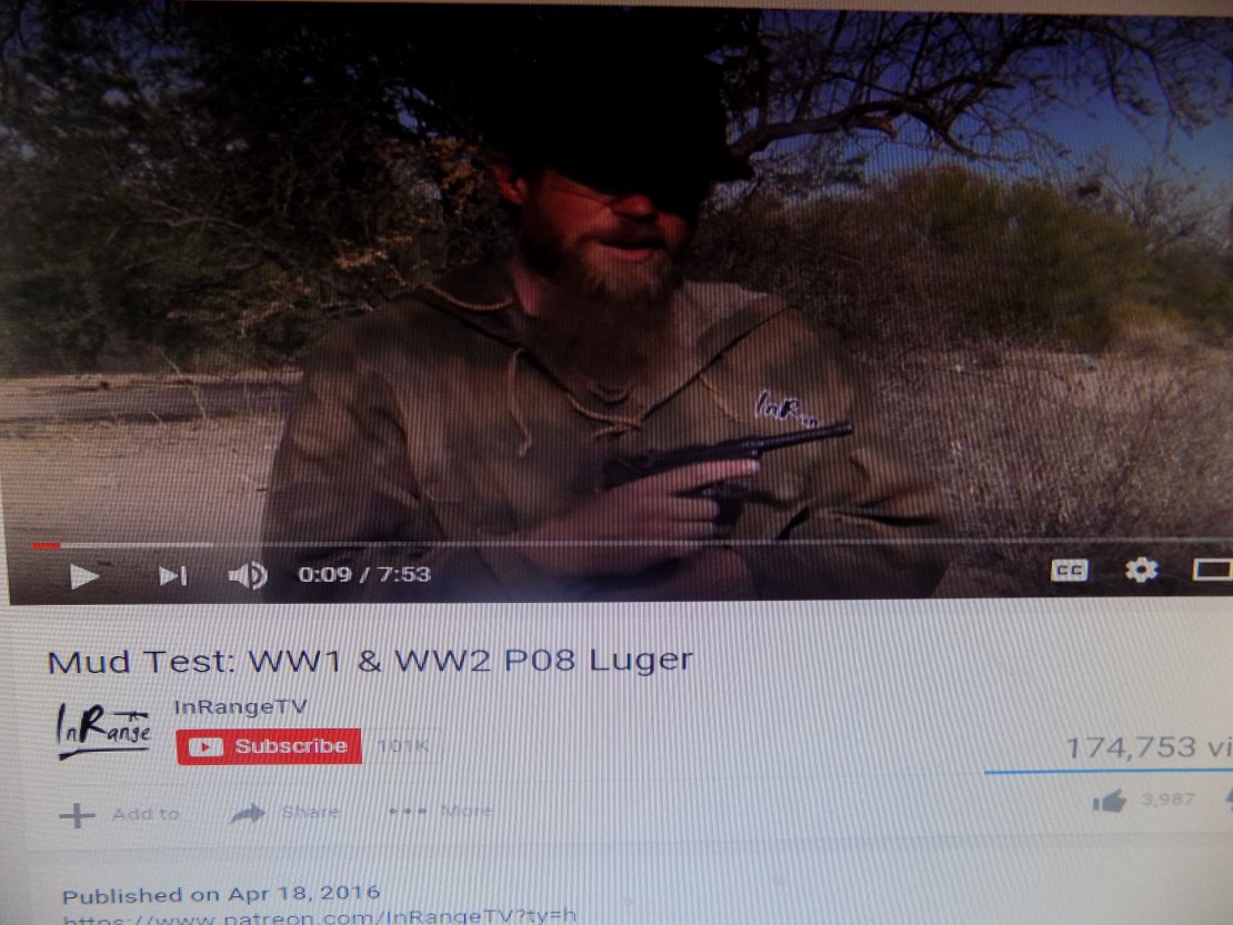

Interesting~https://www.youtube.com/watch?v=z_IeAaR5AmU
