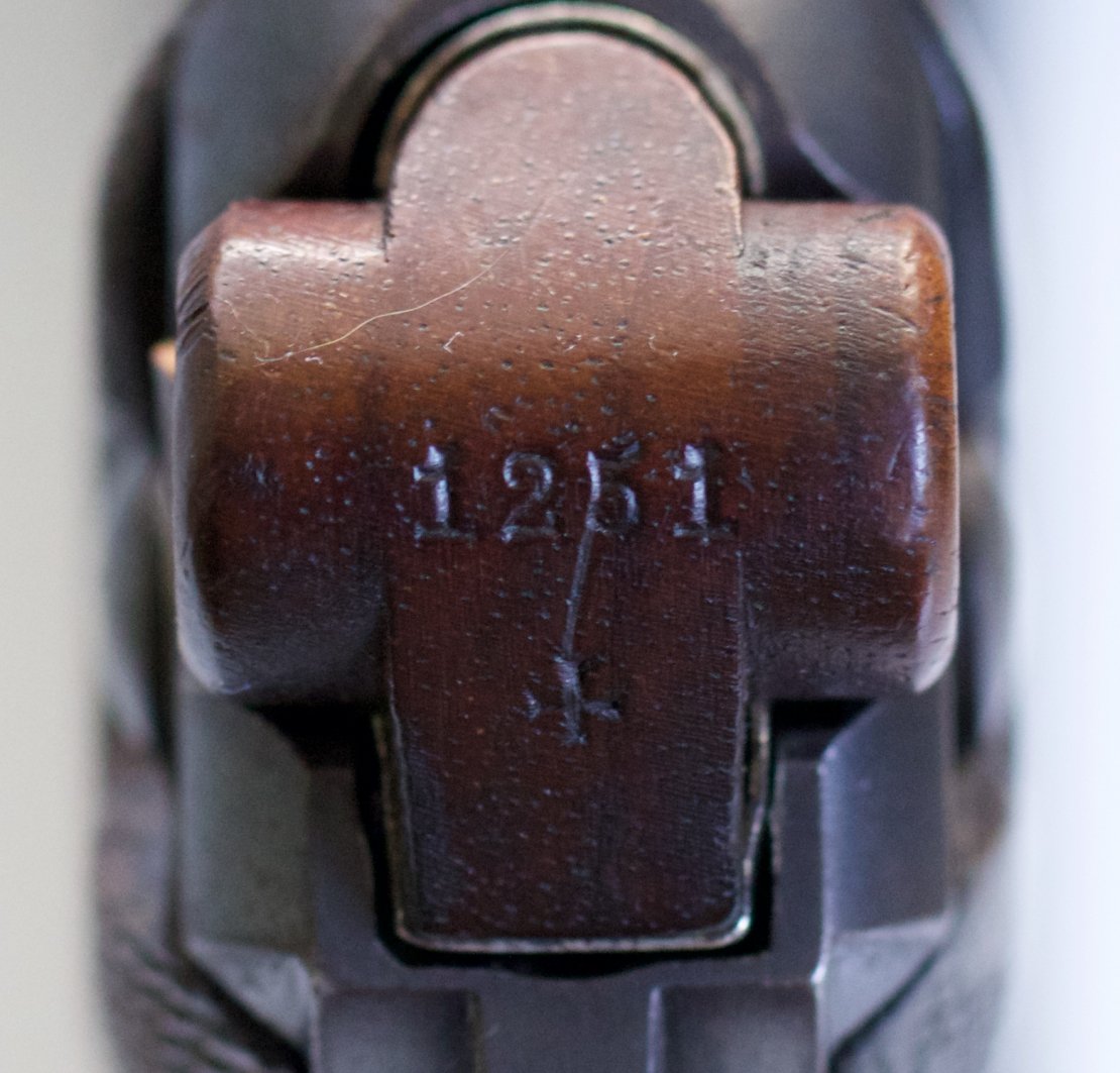

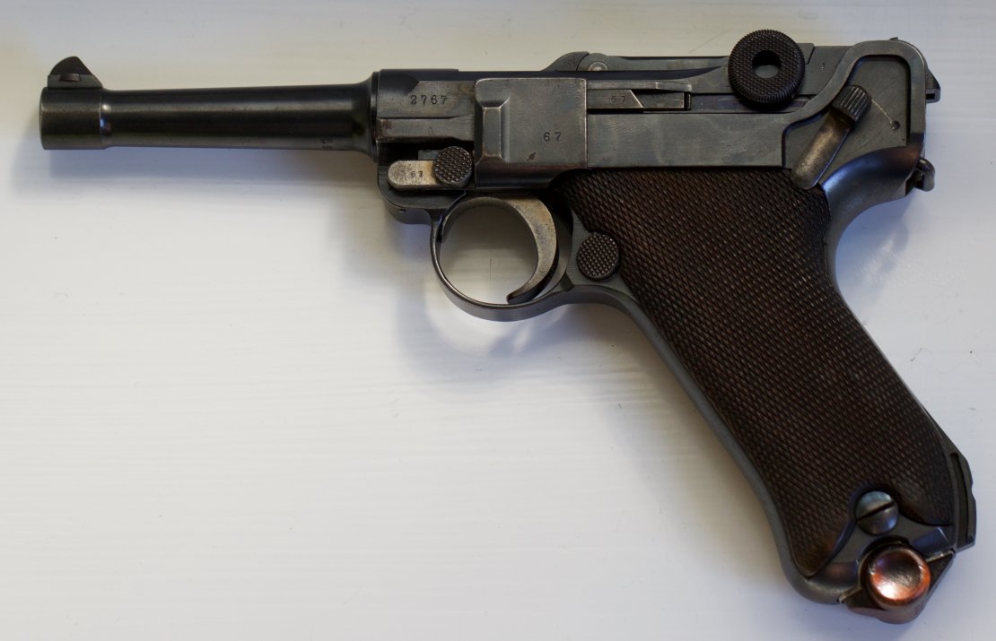

Hello all. I just purchased my first Luger and would like some information on it. I know it's a 1915 DWM and the numbers seem to all match. I haven't disassembled it, though. Pics to follow.

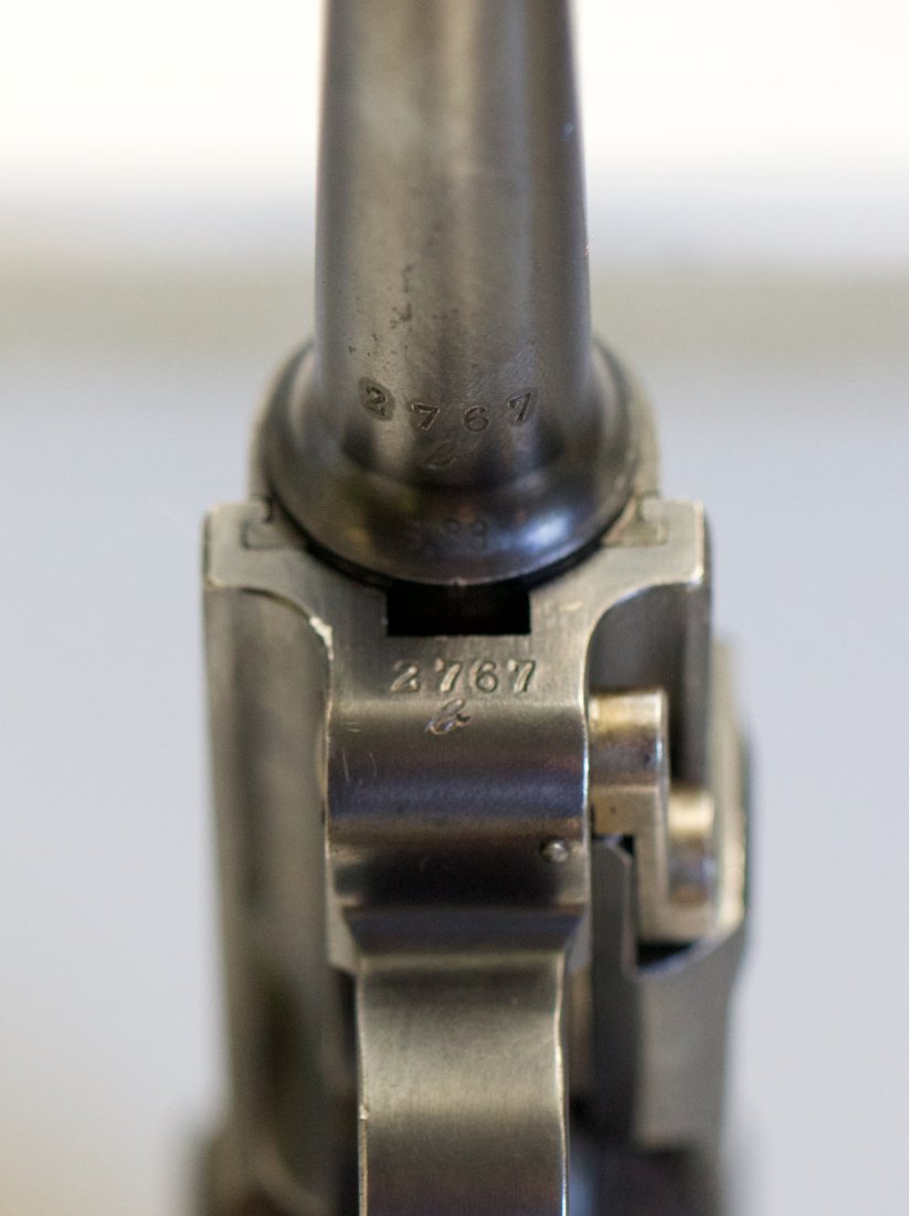

More pics

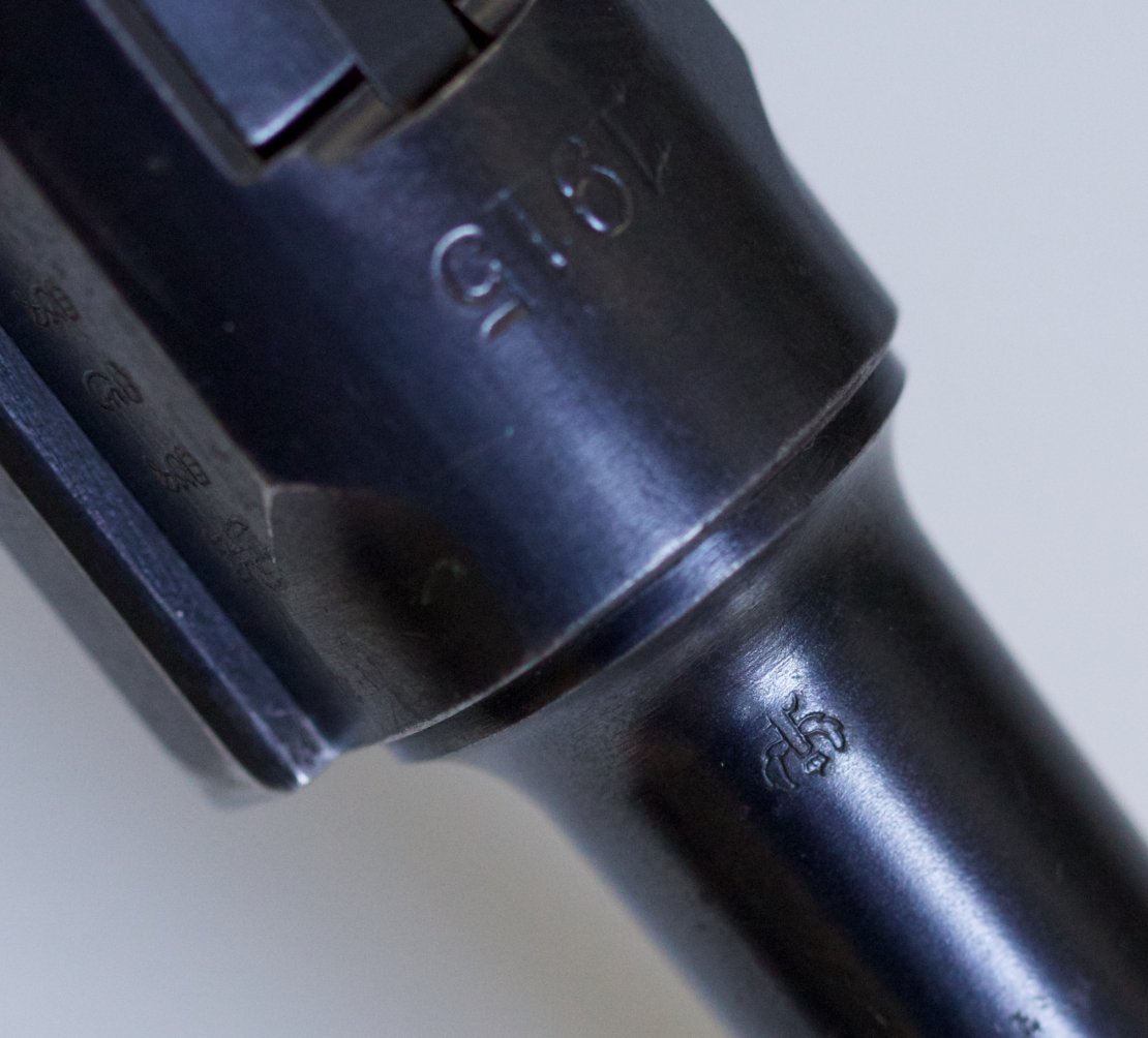

Even more...

Welcome,
decent looking 1915 DWM.
I suggest reading the stickies for info, and then if you have more questions you can ask moe specific questions.
I don't see anything unusual.

What I see is an army 1915 DWM made Luger, no unit marks and did not go into police service.

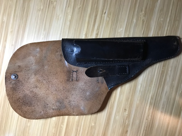

I almost forgot the holster:

Here's what I know so far from browsing this site for the last three days:
Pistol was made by DWM, under German Military Contract.
Has military barrel proof and receiver proof.
Receiver inspection/acceptance stamps are S E S
Magazine is WWI, DWM Military and by the “+” means it’s a spare mag. S/N doesn’t match the pistol.
I have no idea about the holster.

What does S E S mean on the right side receiver?
Inspectors initials applied at various points in mfg. and after proofing. This is covered in the stickys.

Value of holster?
Not much, looks to be aftermarket or ?? not German WWI military

More specifically, I know that S-E-S are proof stamps, but is there a way to tie them to a proofing officer or his staff?
AllenArmory is offline   Reply With Quote
Unread 07-11-2017, 09:36 AM   #12
The stamps are the first letter of the inspectors last name with the Imperial crown over it. If two inspectors had the same last name, then the second on got a line under it.
I believe the actual names are lost to history- but someone may have more info on that.
Unread 07-11-2017, 11:21 AM   #13
I agree with the last above statement that these Crown over a letter are inspector's markings, applied at various stages of construction, not test firing proofs, which are the stylized eagle on the barrel, receiver and breech block. TH

Pretty nice, not much holster wear on front of the frame rails, sideplate island, and muzzle band sides. Sweet
