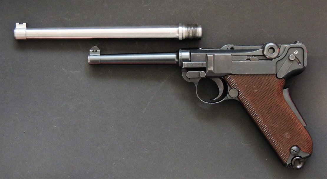

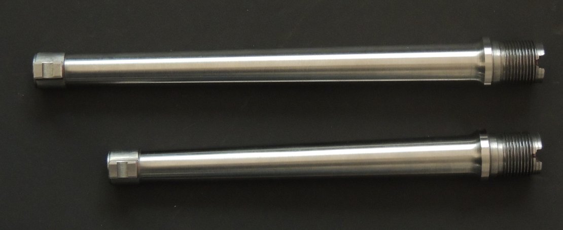

I could recently buy two long 9mm barrels (170mm and 200mm) for the Pistol 06/29 made by the Waffenfabrik Bern (W+F).
I suppose they were produced, when the Swiss Army conducted trials with the 9mm Luger cartridge during the 1940's.
The W+F also produced 9mm Pistols 06/29 for the commercial market, but normally with 120mm barrels. These pistols are quite rare.
Better known (but also rare) are long barrels variants caliber 7,65mm Luger - some of these pistols were produced for sport shooting.
It would be fun to transfer an ordinary Pistol 06/29 in a 9mm "LP 06/29"...

What a great find! They might be collectible just the way they are, but would look super on any Swiss or early frame grip safety gun. If I'm not mistaken, this combination of barrel length, taper, and sight block style aren't encountered very often in 9mm. I have a 9mm Mauser 29/70 with a 150mm barrel, and I wish it looked like it would with one of these installed! I am envious of the 170mm, to say the least!

@ithacaartist: I'm not sure if I will use one of the two barrels for producing a nice shooter - but anyway, a 200mm barrel like a LP 08 would look nice...
