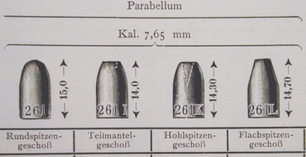

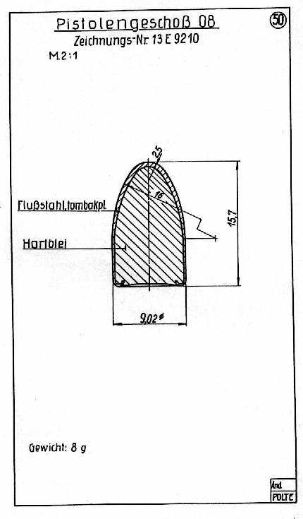

Chickenthief
Join Date: Dec 2016
Location: Denmark
Posts: 135
Thanked 131 Times in 48 Posts
The little ones are quite long
