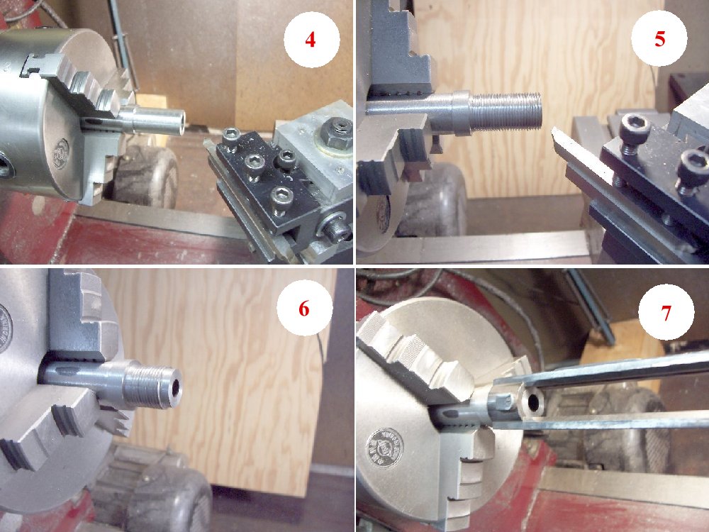

(4) Turning down the breech stub.
(5) Threading the breech stub.
(6) Cutting the stub to required length; turning relief.
(7) Final fitting the barrel extension to the threaded stub.

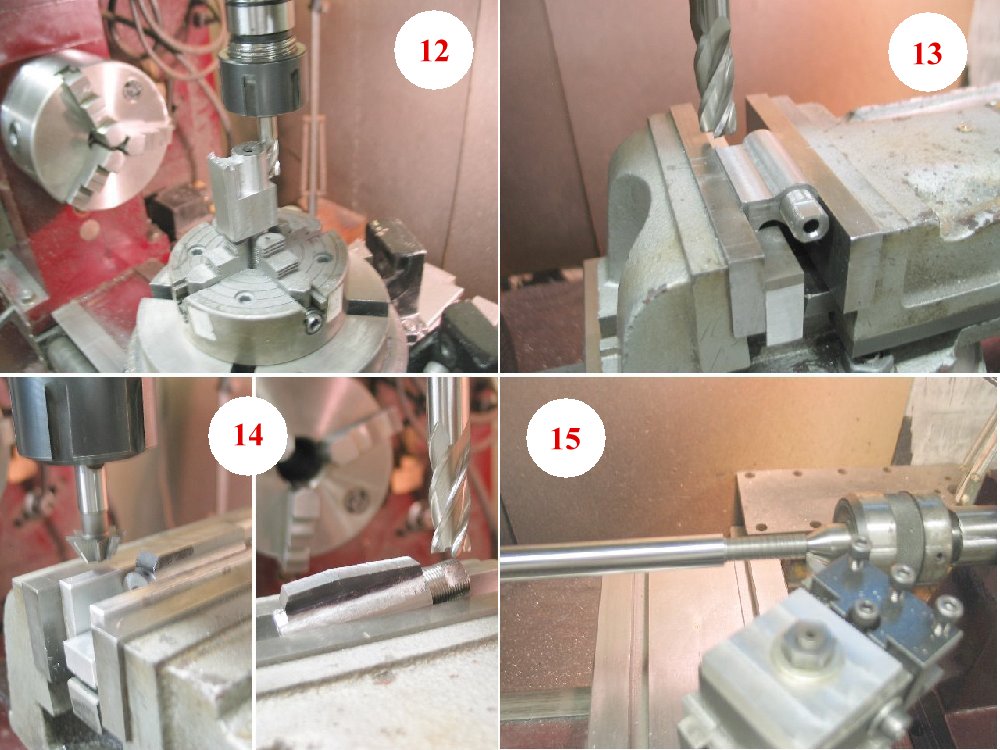

(12) Rectangular piece of steel drilled & tapped 1/2" x 28tpi and mounted in rotary indexing head to mill outer diameter.
(13) Milling the sides of the sight base flat.
(14) Chamfering the front of the base and milling the rear ramp.
(15) Turning down and threading the muzzle for the front sight base.

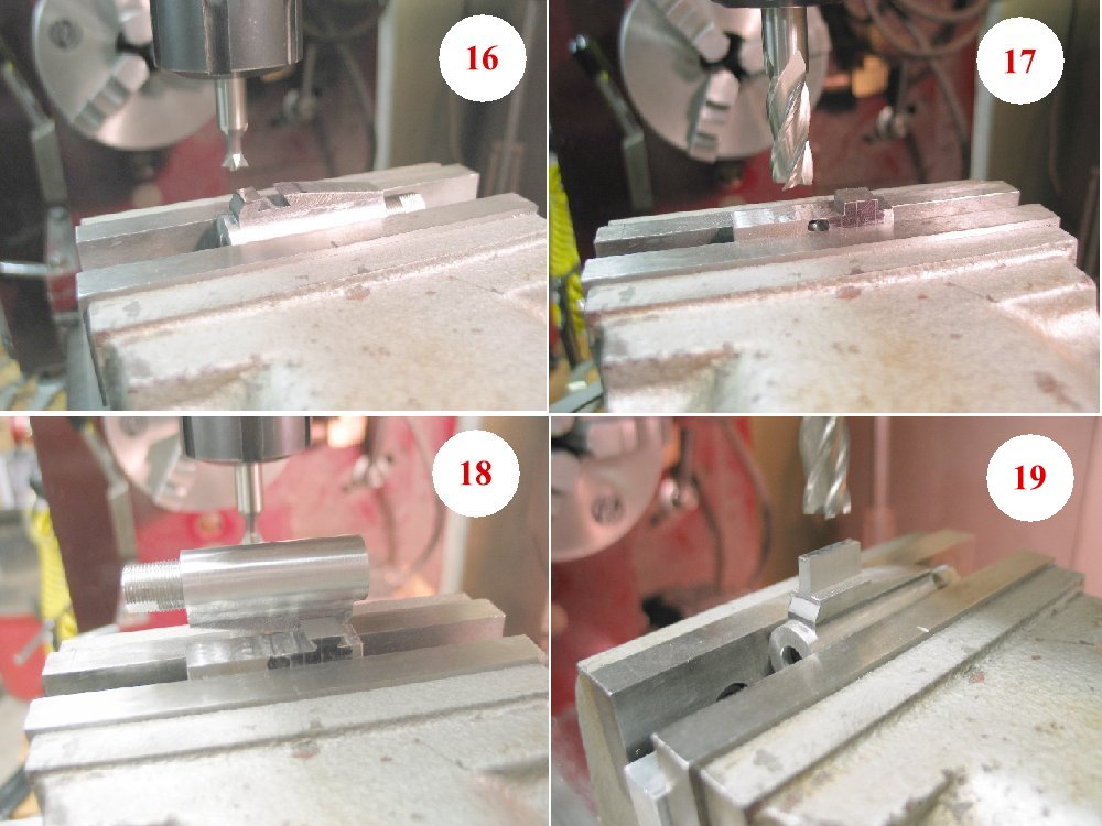

Now I'll mill the dovetail for the front sight blade.
(16) Cutting the dovetail.
(17) Milling the front sight blade from a piece of 3/8" steel bar.
(18) Blade has been dovetailed and is ready to be pressed in place.
(19) Blade has been squared to size and is being finish milled.

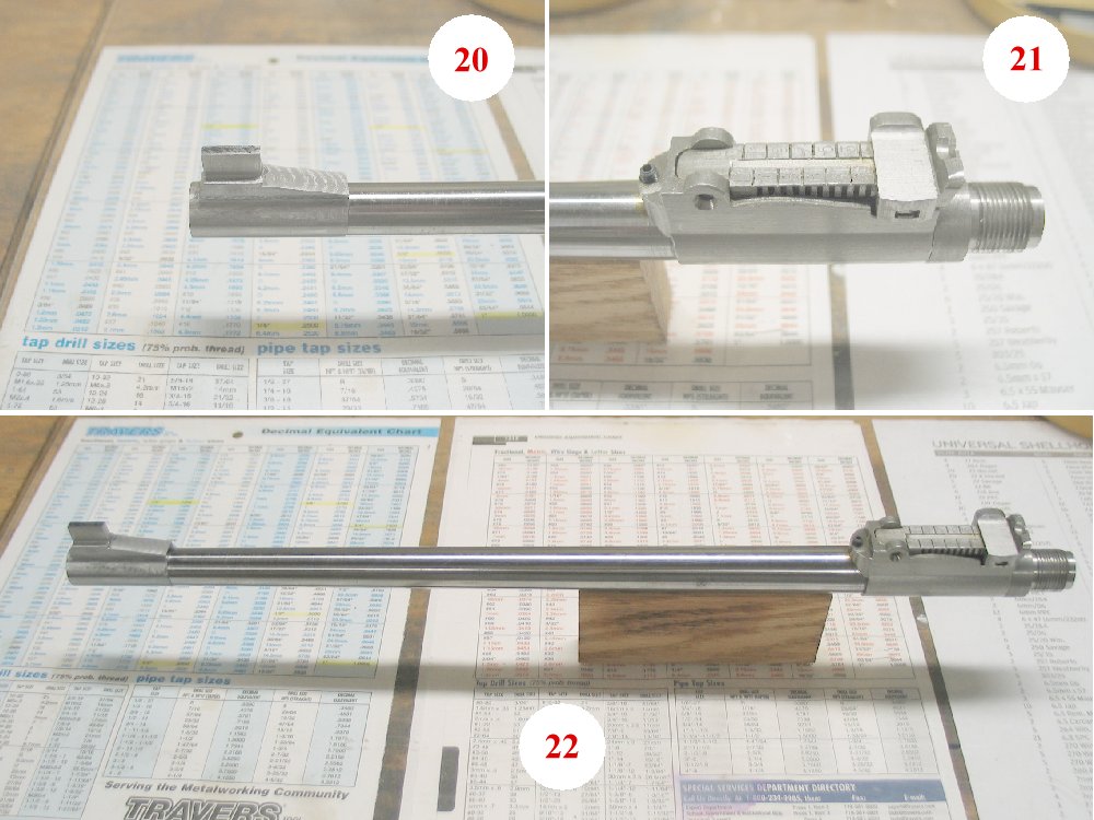

Test fitting the various pieces for fit and visual effect.
(20) Front sight screwed in place.
(21) Rear sight is a slip fit; it will be secured with screws later.
(22) Full length profile view.

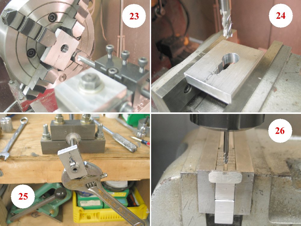

Making the front sight base keyhole spanner, barrel vise inserts, and other small items.
(23) Boring a hole in a chunk of 7/16" aluminum plate.
(24) Milling the slot for ramp clearance.
(25) Spanner in use. Works great! By some stroke of luck (or divine intervention) the sight base is in exactly the right position for tightening to 12:00 position.
(26) Milling Patridge-style notch in rear sight leaf, to match squared front sight blade.

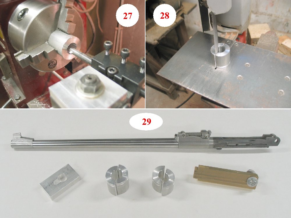

Vise inserts, made from aluminum round stock, 1 1/2" dia & 1 1/2" long.
(27) Faced insert being bored to ~.755", which is the diameter of the barrel just in front of the rear sight base.
(28) Sawing the finished vise insert in half. Cuts will be belt sanded smooth.
(29) A second vise insert is used for the front sight base, as shown in pic #25 above. An insert from another barrel project was the right size, so no other insert fabrication was required. Sight spanner, vise inserts, and receiver insert shown with torqued assembly. Bluing will be the final step.

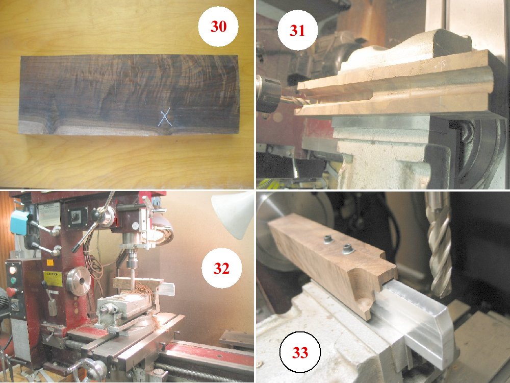

(30) I have a piece of some kind of Walnut, 21" x 8" x 1 1/2". Has some defects [the X] but hey, it's what I gots.
(31) Slab has had a 1 3/4" x 9" piece cut off, decked top & bottom parallel, and barrel trench cut with a 5/8" ball end mill.
(32) Trimming ~.200" off each side. Bottom has had a similar amount milled off.
(33) Cutting the coves with a 1/2" ball end mill. Mounting holes were drilled first to hold the forearm to my mandrel/vise fixture.

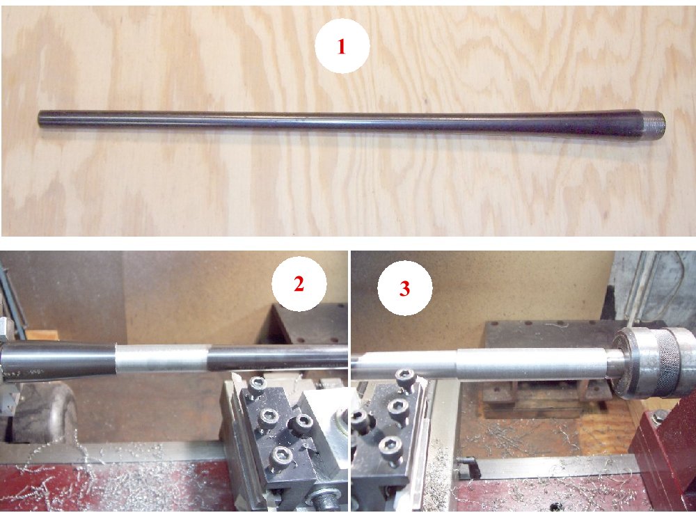

In another thread, Schutzenbob is building a Sharps-Borchardt with a forearm dovetailed to the barrel. That sounded interesting, as it would allow you to use a long barrel w/forearm on any Luger without the mounting lug for the forearm. I have one more Remington 700 30-06 barrel, so I'm going to make a long barrel with a forearm dovetailed to the barrel, somewhat like the Luger artillery rear sight dovetail. Long enough to hold two forearm attaching screws. And I'll make the inletting at the rear of the forearm wide enough to allow it to recoil over the frame.
Here's the start...
(1) Remington 700 barrel in 30-06 caliber.
(2) Turning down the breech end to the OD of the Luger barrel flange and then turning that down to the ID of my 1896 Swedish Mauser carbine rear sight. The two black spots are the OEM Remington rear sight tapped mounting holes. I'll be using them to attach my sight.
(3) Sight slipped on for final fitting.
The sight is from an 1896 Swedish Mauser carbine. I like the look of it, although like all Mauser sights, it is incredibly optimistic.

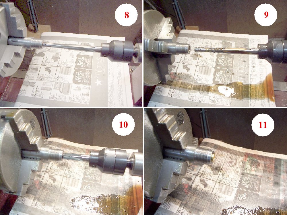

(8) These three pics show the muzzle being turned to diameter, threaded 1/2" x 28tpi, and the steel block from pic #7 above fitted to the barre.

(32) Forearm lug drilled & tapped for attaching screws.
(33) Side milling the forearm taper.
(34) Milling the brass inlay for the forearm.
