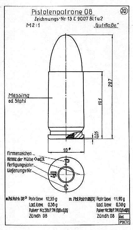

Here are the dimensions like Georg Luger intended them:
http://home.scarlet.be/p.colmant/polte9.htm
Hi,
Sorry, but not quite for Luger shooting!
Please note that steel case ammo was not intended for pistol shooting by the Germans during WWII.
Your excellent original German source is dated from 1940, 32 years after German Army adoption of the Luger.
Confusing, I know, especially to non German speakers.
Sieger
