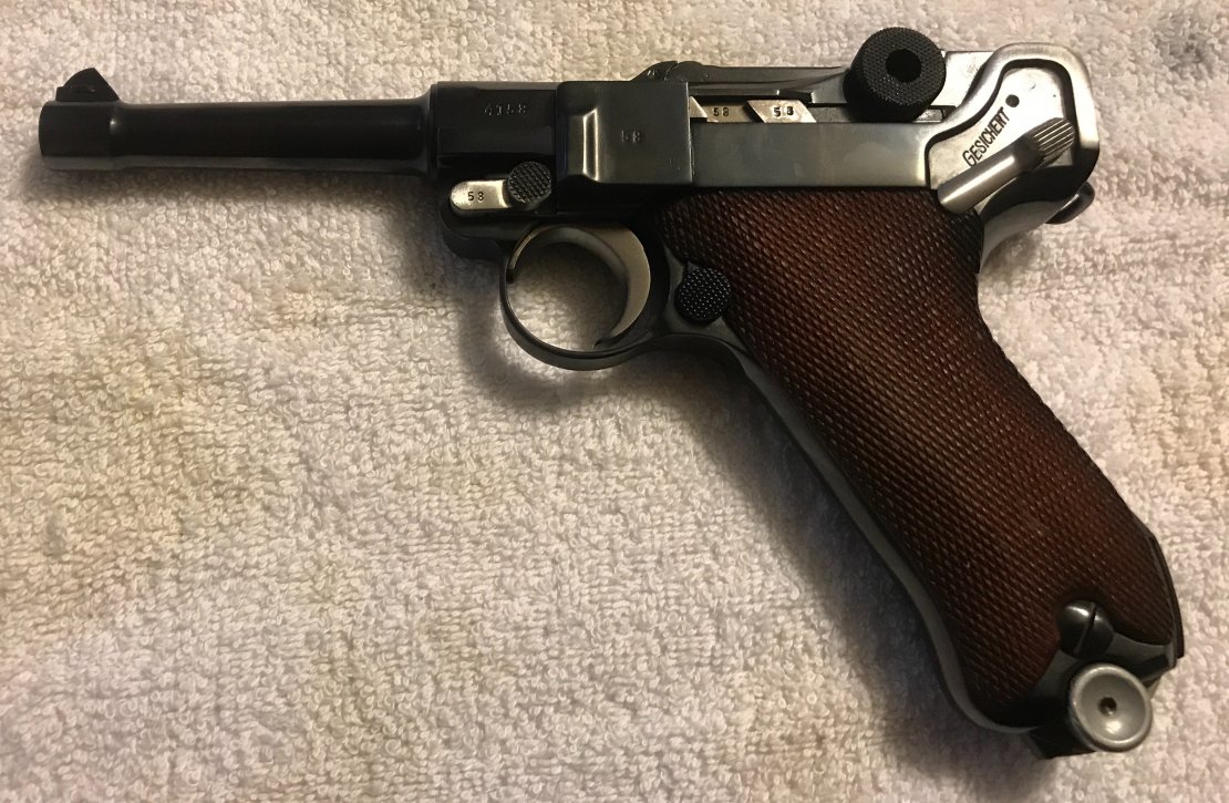

I just bought my first 1936 Luger for $1600 (actually $2000 including a 1937 K98). The Luger is all matching except the mag. Looks very clean. Grips show no signs of wear. No dents, dings, nothing. The previous owner had it for the last 20 years and claims to have never fired it.
How do I know if this is a shooter or collector? I don't like safe queens but don't want to be stupid either.

Pic

Hi, it's a nice restoration, reblued and buffed slightly before the reblueing. So that would place it in the 'shooter grade' category and you have paid a high price for it.
That said: Collections and the nature and basis of collections very: Some collect quality items which are all correct, others, like myself, collect representative examples for research purposes. So I will pick up guns that will not be considered 'true collecting material' at times, because the guns have properties that attract my attention in one way or another. Sometimes, guns in original condition are impossible to find and/or too expensive to be within reach, and one can settle for a less perfect, but still representative example for research/analysis/testing purposes.
To complicate matters further, there are R&D pistols that have been R&D'd considerably and then some. These guns, coming from gun company departments are absolutely collectable, but usually look like a train drove over them a few times. It goes with the territory, and I will never pass up on an original company R&D gun in any condition.
Anyway, it's not a black and white situation, there are numerous shades of grey in between.

If that is the 1936 I hate to be the bearer of bad news but it appears to be a refinish. Telltale signs, it should be rust blued and some of the sharp edges are not sharp anymore. The proof marks look to be washed out as well. Nice shooter though, I wouldn't kick it out of the safe.

That gun is definitely in the "shooter" category.

That Luger is a shooter category gun, but a very handsome shooter!!! I would be proud to own and enjoy it.

It has been refinished so it's definitely in the shooter category, as the other users here have stated. Shoot it shoot it shoot it!
