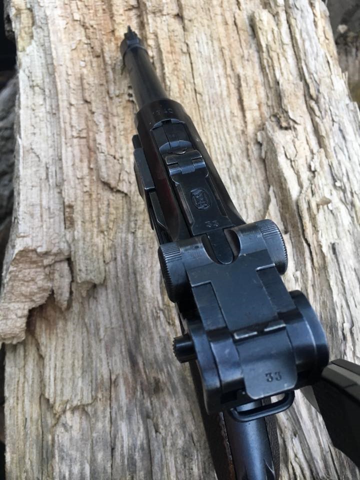

Hi
What is you'r opinion about this Luger.
Serialnumber is 33.

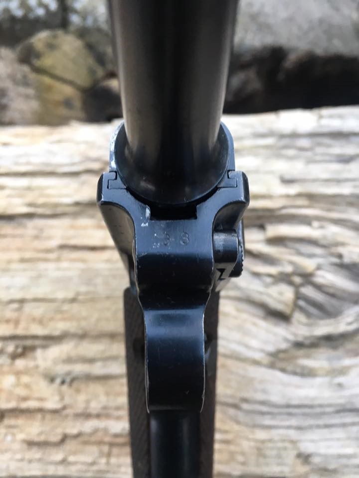

Gun is matching on Frame, bolt, rear toggle,and middle toggle.
On all other parts where gun not is matching, there is no number!
Barrel have no number but WAA marking.
So opinions?
What is it?
Lunchbox special?
Late war production assemble of what they could find?
Civilian gun that have been not been properly marked?
Postwar rebuild?

Repaired or re-barreled with a Steyr made barrel-see the mark on the bottom of the barrel-
When- who knows.

S, What are the WaA marks or proof marks on the sides of the 1940 receiver? Most likely a shooter assembled postwar from left over armour's spare parts. TH
