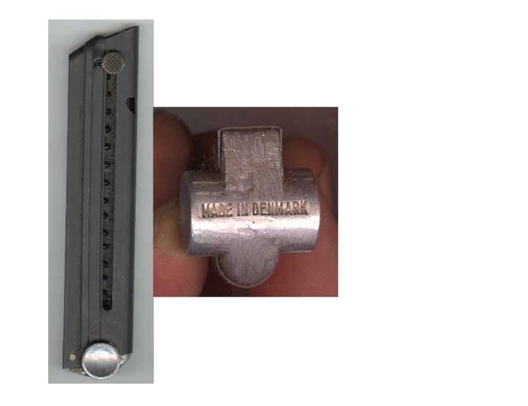

Unread 03-12-2017, 08:19 PM   #8
LU1900
LU1900's Avatar
Location: FRANCE
Posts: 914
Thanks: 49
Here one , if that about you talk
