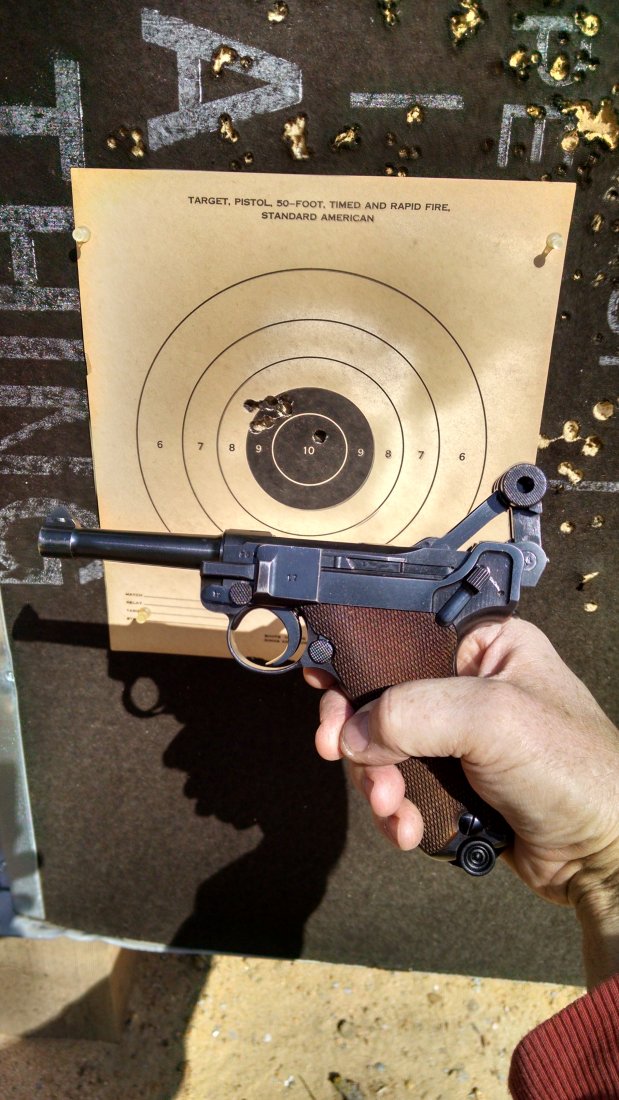

Default shoots well
http://forum.lugerforum.com/attachme...1&d=1488649982
I had to get a prescription from the Luger Doctor , (thanks Tom) for a new hold open spring and a recoil spring for modern ammo and it runs perfect now . I was shooting WW white box 115 grn. http://forum.lugerforum.com/attachme...1&d=1488650469
Oh and I thought I was fairly handy , but learned what difficult really is when you go to change out the mainspring in a Luger . I even built the tool , still really tough!

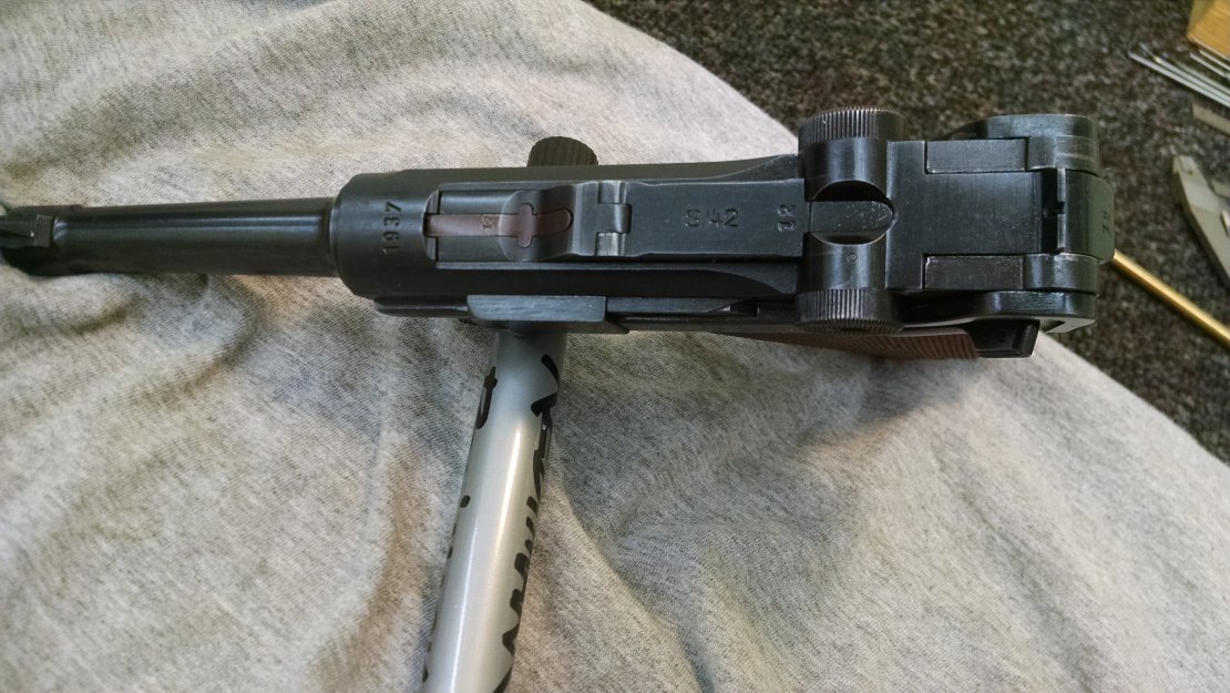

Here's the tool that I made :
http://forum.lugerforum.com/attachme...1&d=1488740698

Kirk, Congrats on your recent PO8 recoil spring change. I personally have two tools that I use to do this job: first I have a lever type arrangement that lifts the spring guide, so that I can disconnect the hooked top from the recoil lever with my free hand. Then I use the hooked tool to remove the spring and guide from the frame. Same in reverse to install. This makes connecting the guide to to the lever easy. TH
OK , that got me thinking so I went out to the shop and wondered just what would I have that would do that ? And it came to me , a pair of lock ring pliers might do the job.
So I found a pair I had and fit them to the hole in the spring guide and ground them a bit so they would fit nice to the frame radius and whalla , Easy peasy , they worked Great.
Also noted that the frame cut out where the guide goes through was rough as cob and the guide itself was very rough on the sides . So that was easy to remedy .
I also found that if I greased up the hook and spring it would twist on to the guide much easier - imagine that !
This worked so well I just wanted to share this , I even found with a zip tie I could have both hands free to get the spring guide hooked up with the recoil spring lever . Snap ring pliers made this job very easy , night and day difference between trying to compress the spring with a hook tool and then look for another hand to get things together.
( In the pics below I just locked the toggle open to show how the pliers would work )
