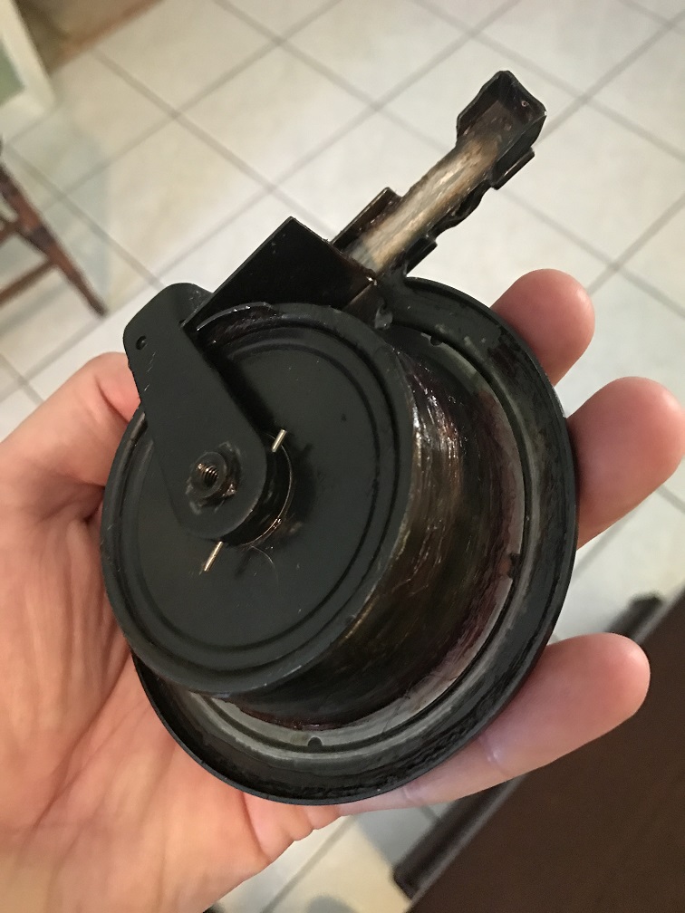

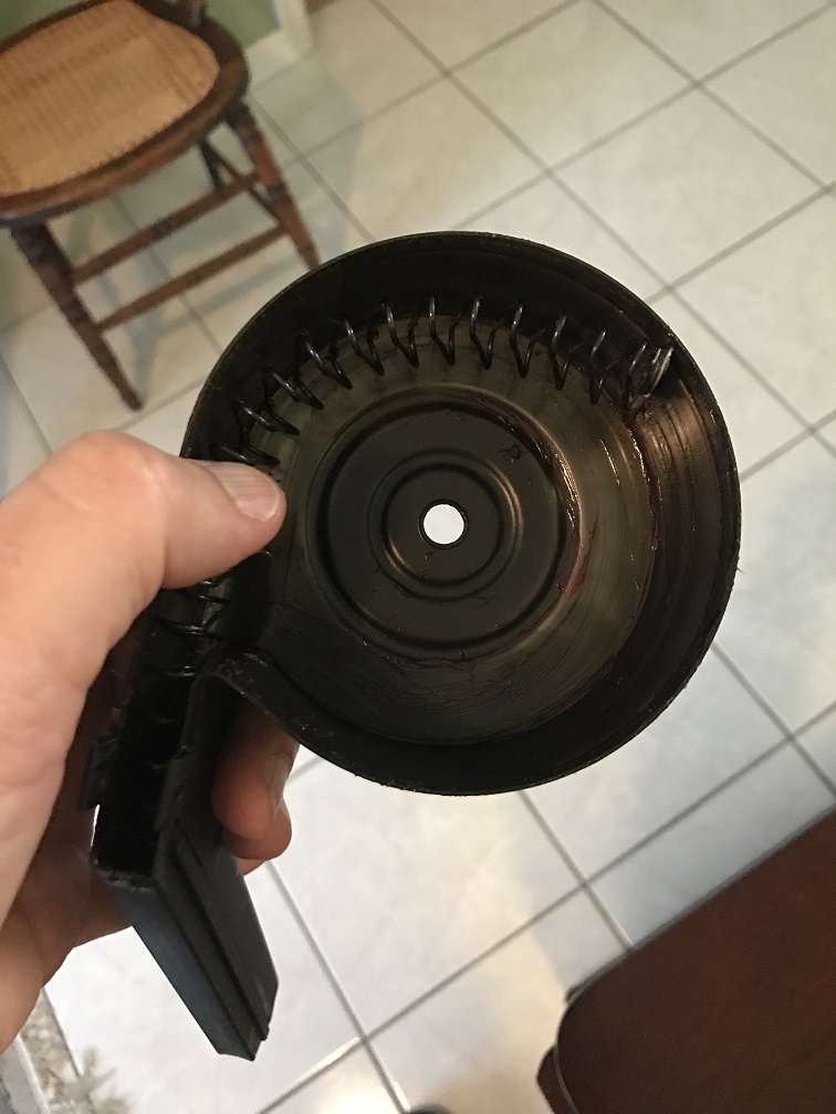

OK, I had to put the drum, loading tool and loading assist strut down for a few days but was able to spend some more time with them early this morning and I think I might actually have a chance of getting this to work. We'll find out when I get out to the range this weekend.
Like Don, I find it easier to load a round or two first by hand to discourage the follower from popping out the top of the magazine. I also used a drop or two of oil every few rounds per a how-to I read by George Anderson.
It was instructional to take apart the drum and see exactly what is going on inside. As usual, I managed to do things the hard way by forgetting to wind the spring before this morning's disassembly. It made for a bit of a greasy mess getting things back together (the issue being taming the mag spring back into place with some compression), but I managed to get it done and all seems well after a follow-up disassembly and re-assembly (after WINDING THE DRUM SPRING FIRST).
While I was in there I took a few pictures to hopefully enlighten some of you on the innards of the drum. You can see the generous amount of red grease inside. I believe that some of the areas where the bluing appears removed may be those polished by G.T. during the tuning process.

Yes, those bright areas are "hand" work by GT, and critical to functioning!
