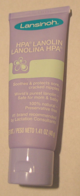

The good thing about Bill's suggestion is that Connolly's is a lanolin that is found and extracted naturally from sheep hide. It only penetrates the very surface where you want to stop cracking. Hand creams are made of the same stuff.
If 100% Lanolin is what you wish to try, check your local drugstore for a 100% Lanolin lotion used by nursing mothers.
I don't know how it affects holsters, but I can assure you that it leaves women's skin soft and smooth.

I went looking for Lanolin in the drugstore and they wanted almost $8.00 for a little tube (1/2 oz.?) Looked on eBay and bought a small tub for about $5.00.

I have tried pure lanolin and it's a little thick for my purposes although I am sure it would be manageable if you got used to it. The trick I use often enough is mild heat. Put a little on a soft toothbrush an work on applying a light coat. No matter how thin you get it..it will appear tacky and stay on top. Place it in the sun, a warm car or lightly wave it under a hair dryer and it will glisten and disappear. Don't apply a heavy coat. A little goes a long way. Connelly's Hide Care has a mineral spirit dryer mixed into it which makes it easier ..for me anyway, A jar of it lasts me 6 months or more but I use it every day.

I used a floodlight to 'melt' it into my old baseball glove. You can tell it has been absorbed instantly.
