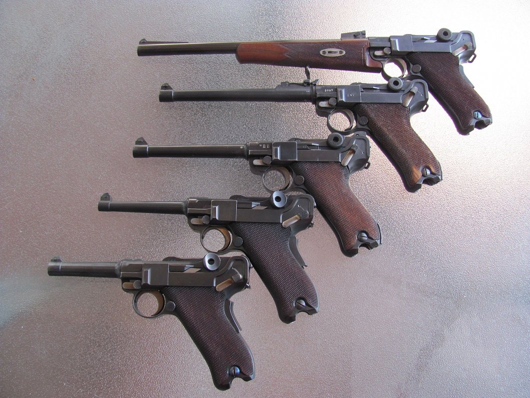

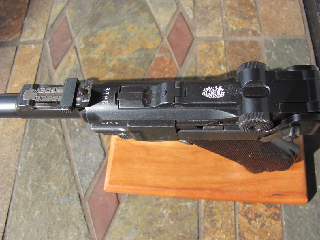

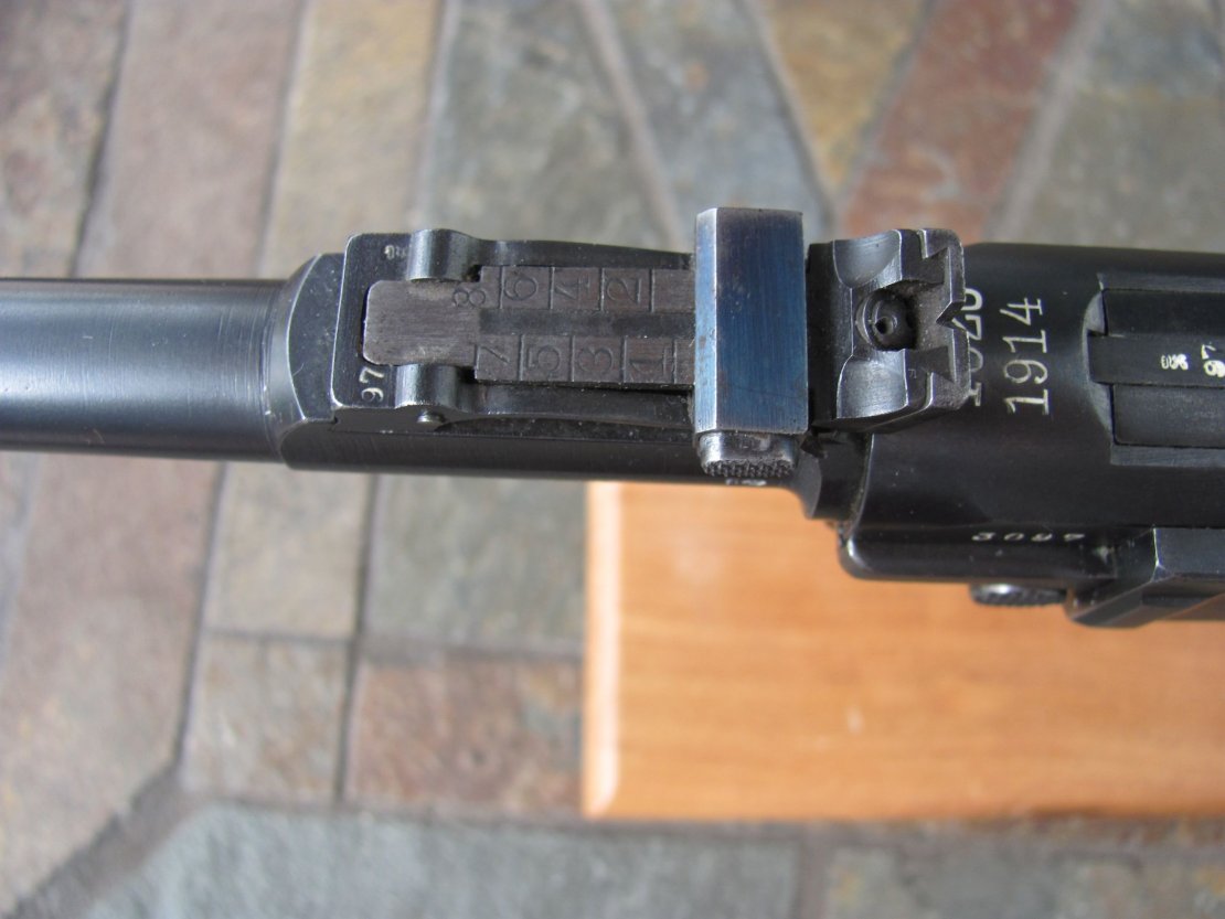

This year I fired 2 lugers for the first time! My first was an 08 shooter from George and also an artillery which I have come to know was reckless. One thing I noticed was the artillery seemed to have much more of a kick and seemed more powerful. Same round but much more powerful! Is there a difference? Maybe barrel length! I did screw up fireing my 1914 DWM artillery which was awesome~ Eric

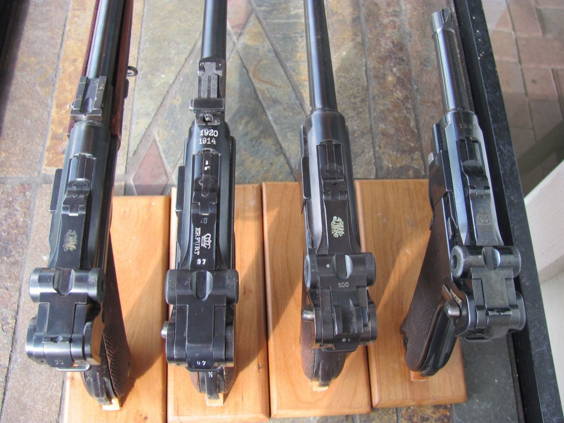

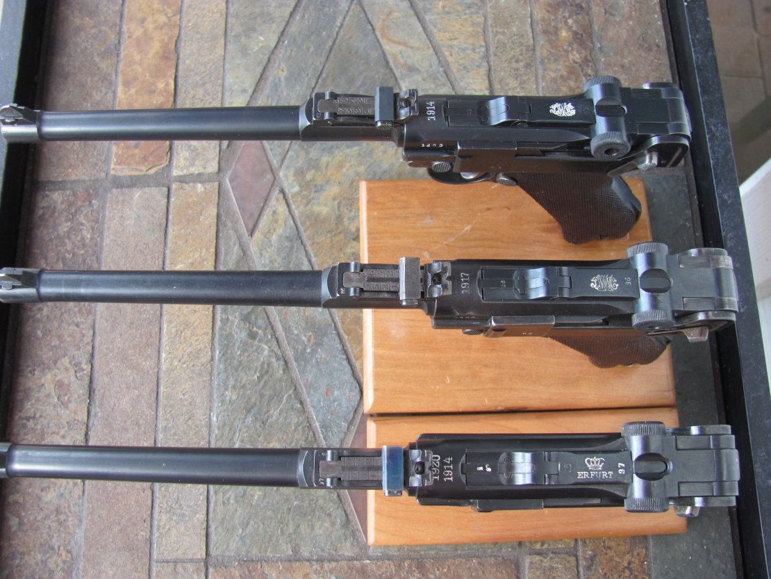

Unread 12-14-2016, 12:54 PM   #3
Thanks all! I used my rarest instead of my other two~

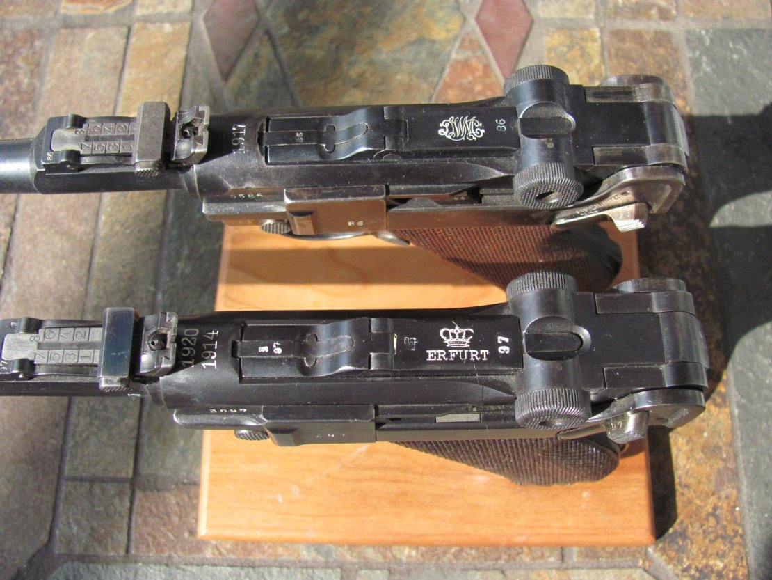

Unread 12-14-2016, 04:08 PM   #6
Which model shoots further with the same ammo?

Don, since you use the same frame for a P.08 and LP.08, I think the two springs would be pretty much the same. But with the 8" barrel, the round stays in the tube longer, thus imparting more oomph to the recoil. I also think someone has mentioned that the recoil is more noticeable when the stock is attached.

You are for sure correct about the longer bbl, but the key is the higher velocity- which gets "squared", thus increasing the recoil impulse- which is somewhat off set by the slightly heavier bbl.

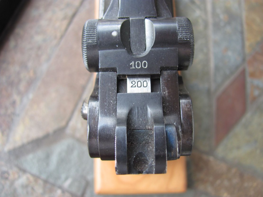

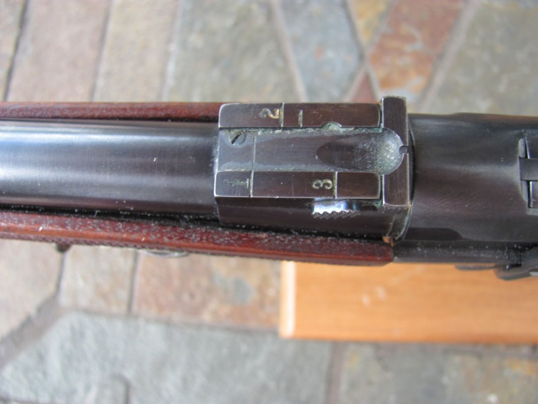

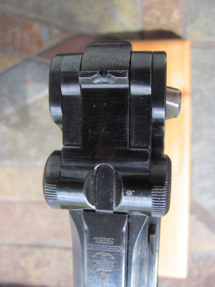

Unread 12-15-2016, 11:16 AM   #13
Obviously for different uses!
