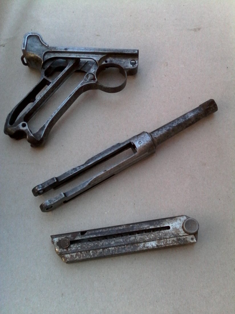

A few quick pics,

A nice coat of rust, and not much finish
The perfect combination for a shooter project
Fortunately the rust was for the most part confined to the outer surfaces,
And all parts present matched, including the magazine, however I will pickup a couple Mec Gar
Pitting is not bad, and can stay, I will rust blue it once it is completed and operational

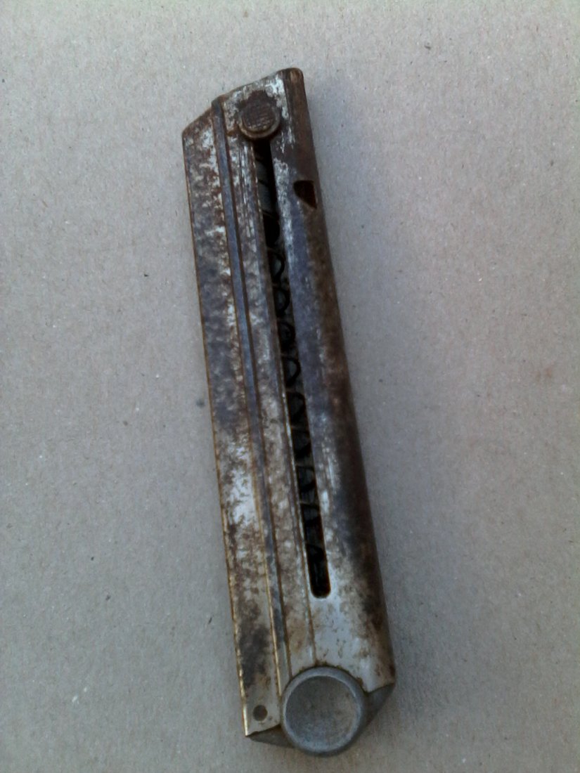

No clue how it got in such a sad state,
Stored in a leather holster would be my guess
Proof marks are 63 and 92 plus a third design
Magazine has aluminum base, with 63 proof and nickel plated?
Any idea if this would be original, or were they sometimes serial numbered to match at a later time?
Any advice on refinishing the mag, or just leave it as is?
Caferacer is offline   Reply With Quote
Unread 03-23-2016, 07:10 AM   #8
"0000" steel wool and a lot of elbow grease will make the mag LOOK better, and may even function...but it will never be as nice as an un-rusted one. Buy yourself a couple of good aftermarket magazines (Mec-Gar), or an original mag of the FXO variety... and just put that one away would be my advice.

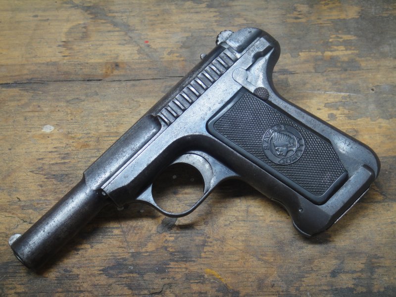

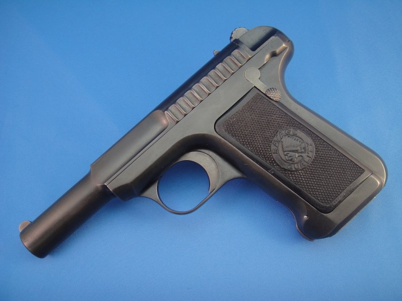

Not too bad, I think it will look pretty good after some rust blue. Enough rust on it already to get a good start.
I have done quickie jobs on guns like that by blasting the parts with fine aluminum oxide (150 grit), followed by rust bluing. A fine grit like that will clean off the remaining rust and give the bluing a good bite, and the blasted texture is so fine that it will disappear after rusting and carding.
Here is one I did that way:

Did you sand the Savage to remove the pits before blasting ? I have a batch of water/smoke damaged non-Lugers I've been asked to rescue.

Originally Posted by Paladinpainter View Post
Olle,
John
It has been a while, but as far as I can remember I didn't. Could be that I hit some of the worst spots, but I know I did the whole thing in just a few days (and most of that time was of course just rusting) so it wasn't much anyway.
You can probably do a pretty nice job like this if it's just a matter of surface rust and light pitting. It's not a show finish by any means, any pitting will still show but won't be nearly as noticeable as it would be with a high polish finish. Parkerizing would be the next option, the coarse blasting and flat black finish will hide a lot of imperfections.

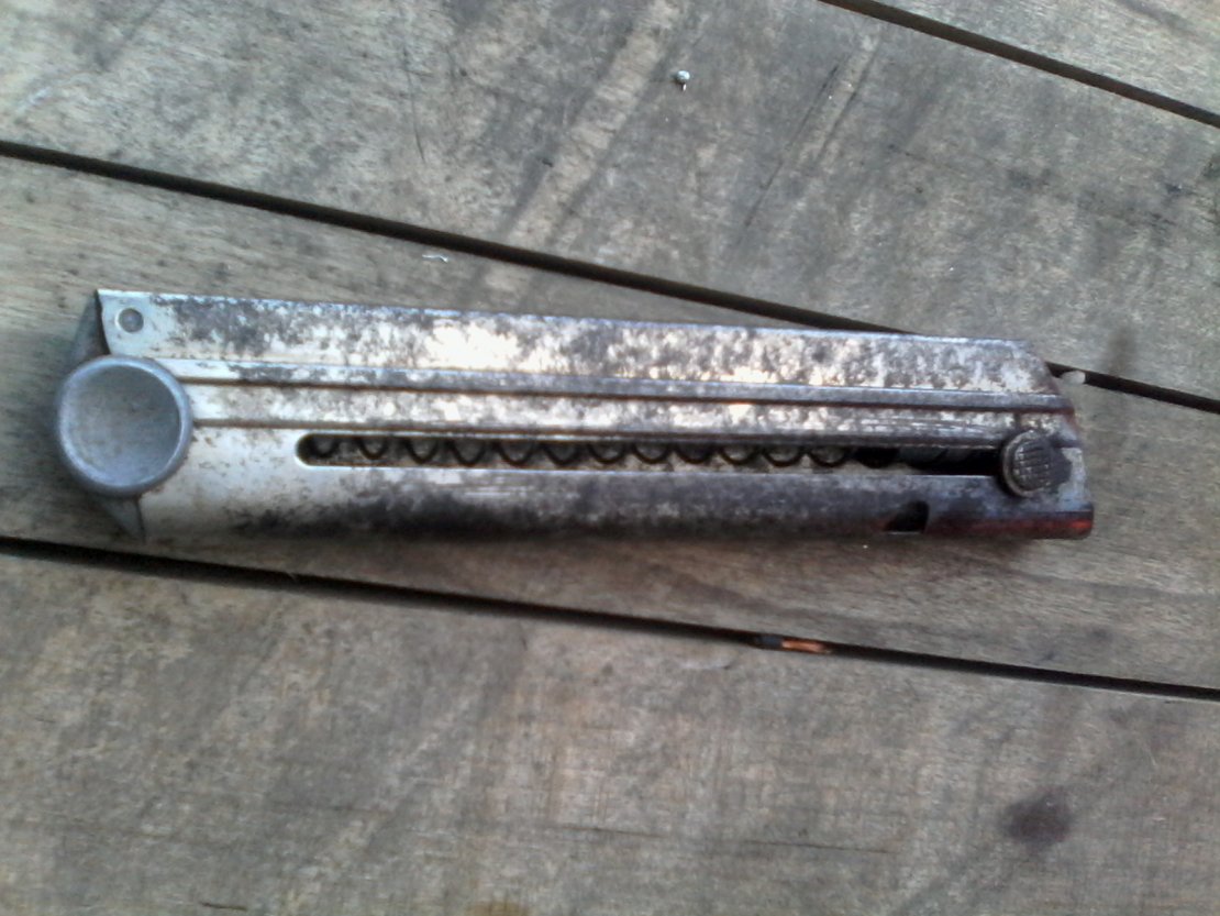

Cleaned up the magazine with a bit of oil and OOOO steel wool
The spring was twisted up inside, I had to disassemble it and straighten it out, funny I just got a Walter PP with the exact same mag spring problem,

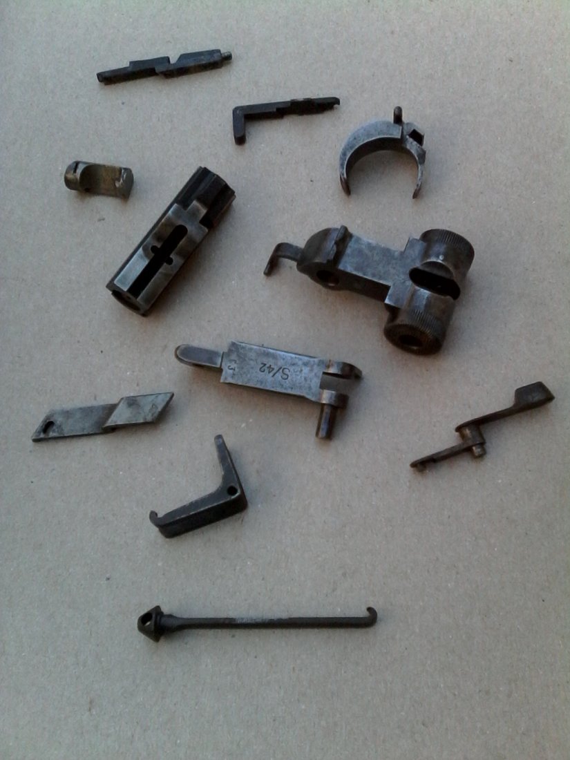

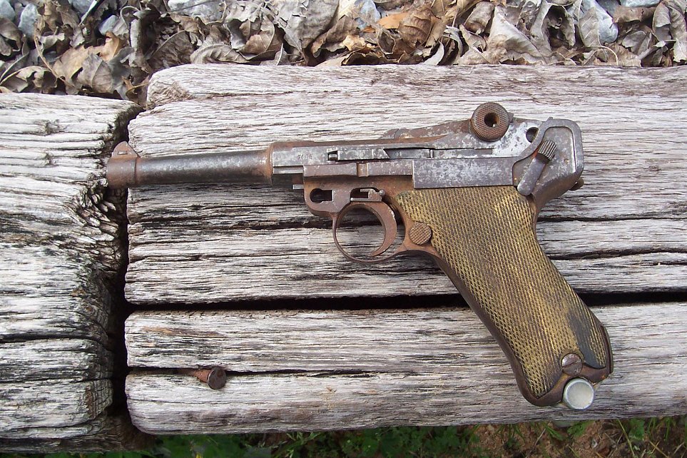

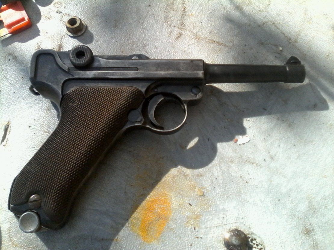

Well l got the last few missing parts, and finally assembled it for the first time,
I only gave it a quick cold blue so l could test fit everything, and hopefully test fire it soon
but thought l would post a couple before and after pics of the progress so far
as l got it, and today

Now we're getting somewhere!
You could also try and straw color the small parts, I don't think it would be correct for this gun but it does a lot to the overall appearance. Makes it look more Lugeresque, so to speak.

Being a 1935 G date, l think straw should be correct, and I do plan to try the 450 degree oven method when I refinish it
