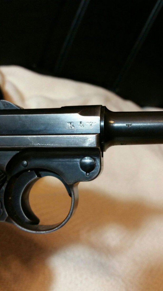

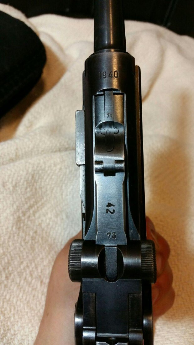

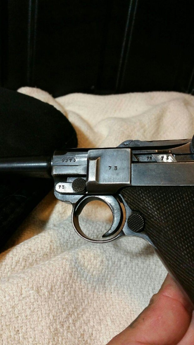

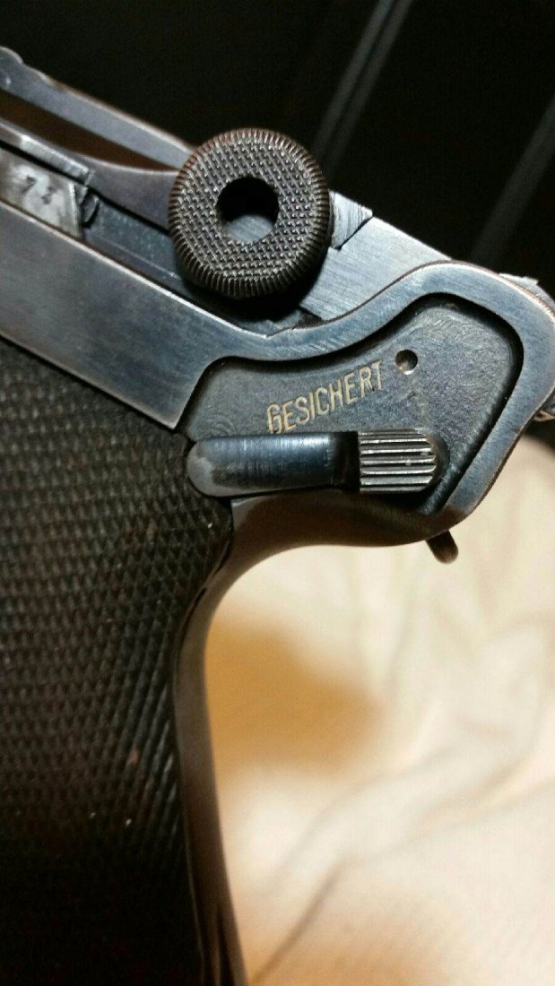

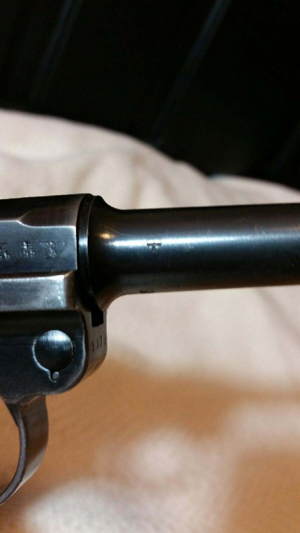

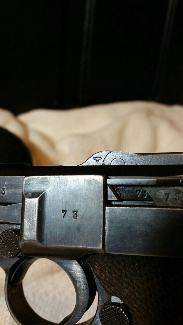

I am new to this forum and was referred here by a user from Calguns forum on Tapatalk. They said this is the top site/forum for the info I am interested in finding. So here goes,

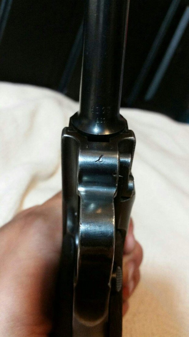

my Mother was just handed down a pistol through unfortunate circumstances. Now that the dust has settled, she and I are interested in finding out about it. What do the markings mean, what would it have been used for? The pistol is numbers matching from what I can see without dissassembly, but magazine is not. I am very unfamiliar with antique firearms. My mom is not anti gun whatsoever, but she does not want the responsibility of having a gun in her house and will likely give it to me. Any info would be great! Thanks everyone.

Well, you have a Model P.08 Luger manufactured by Mauser in Oberndorf in 1940. 42 was the code for Mauser.
The marks on the right side are proof and acceptance/inspection marks.
There were about 137,000 or so P.08s made in 1940 and yours was built in October or so. Sadly we do not detailed records to call it any closer.
Absent other information we have to assume the pistol was issued to the Army as they received the bulk of production in 1940.
hope this helps.

Looks like a very nice 1940 Luger. The full serial number is 9373 with a "L" suffix.
Enjoy your historical gun!

On first glance, from the photos, it appears that you probably have a collectible Luger in original finish and with matching parts. It will have to be disassembled to check some of the internal parts and the grips to be sure. Use great care when removing the grips, particularly the left one.
These Mauser made Lugers were well made and used advanced metallurgy which became available in the period.
Condition looks reasonable, but it's hard to judge finish from the photos. Perhaps 90%. It looks un-messed with, and you should keep it that way. If it's all matching, resist the temptation to load and fire it. Parts do break on these, and if they are matching they will considerably reduce the pistol's value.
The number "94" should be stamped inside the trigger side plate. Does the magazine have a matching number? You didn't photograph it so I can't tell you if it's original and period correct.
What I can see, if all matching and original finish, would be worth $1500 with a correct magazine. Perhaps more.

For what I can see I think you've got a very nice example of WWII Luger made by Mauser, and all its original marks seem to be crisp and untouched.
