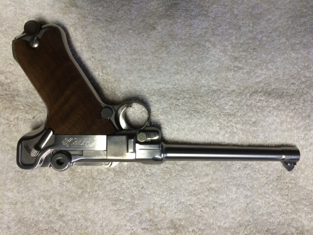

This is what it looks like when it isn't malfunctioning if I can get the photo attached.
Vic
