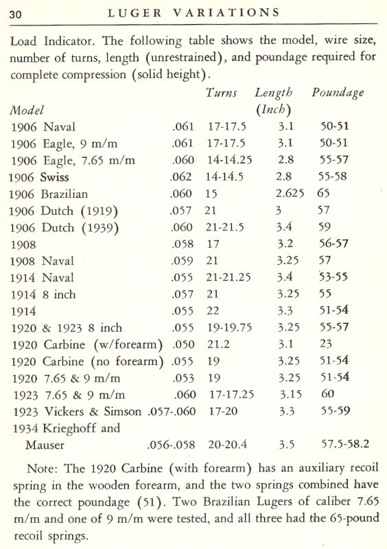

Unread 03-18-2016, 01:10 PM   #6
FWIW, I have been told by a reputable manufacturer that coil springs are measured by the amount of weight required to fully compress the spring to coil bind [fully compressed; coils in physical contact].
Unread 03-18-2016, 01:29 PM   #7
That is what I understand to be the current way- resulting in approx 38 lb ratings of the luger main spring.
But this does not agree with published data of 51 to 65 pounds for various models-
thus, obviously the way they were measured is different.
Unread 03-18-2016, 02:25 PM   #8
But this does not agree with published data of 17 to 21 lbs ;
Yes. I had previously been told that it was the force [weight] required to compress a coil spring one inch.
Frankly, I don't know what to think now. I conducted my own tests a year or so ago and posted the results here.
I remain doubtful of Wolff's spring specs, although I do use them.
Unread 03-19-2016, 09:44 AM   #9
Luger recoil springs varied in both the number of coils and the weight of the wire used.
I believe that the published data "17 to 21" refers to the number of coils not pounds...
Take a look at the table in our FAQ.
Compression poundage is up in the 50's...
Unread 03-19-2016, 10:01 AM   #10
Marc,
you're corrrect the 17 to 21 is the # of coils, old guy mind bubble!
But the lbs are different too, so they must be measured differently.
