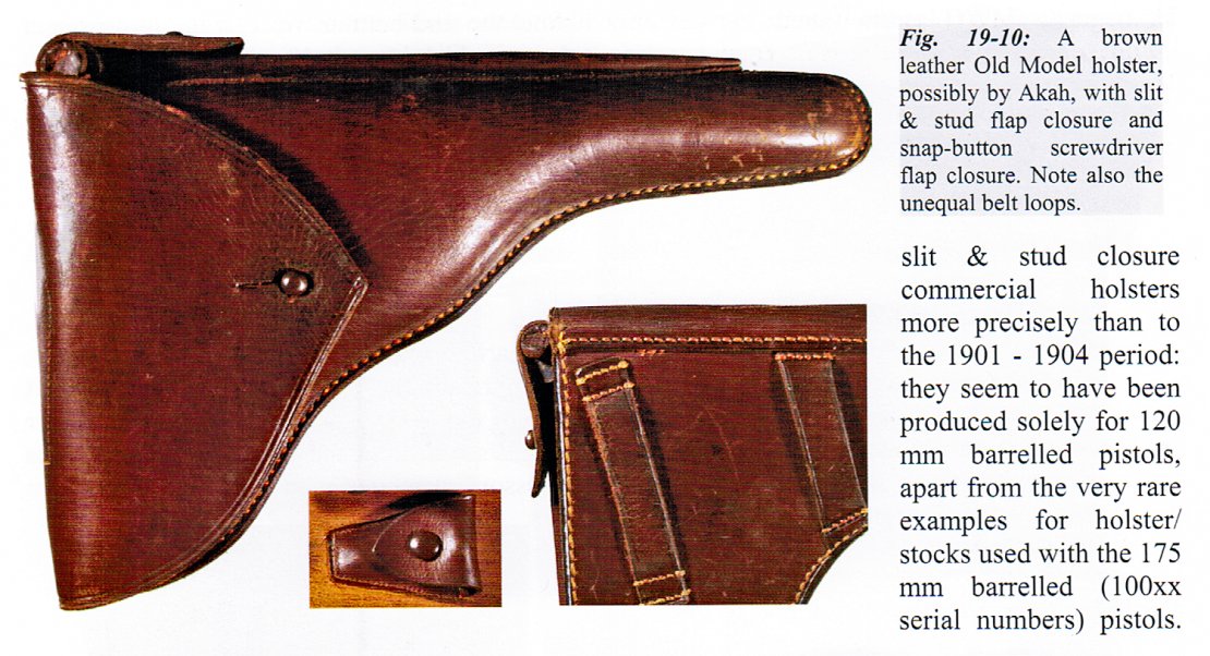

Here is a picture of the type of holster I have that appears in "The Borchardt & Luger Automatic Pistols" by Joachim Gortz and Dr. Geoffrey Sturgess, Vol III, page 1171 (red covers).
Comments always welcome.
Bill
