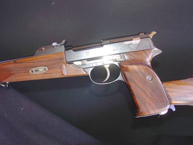

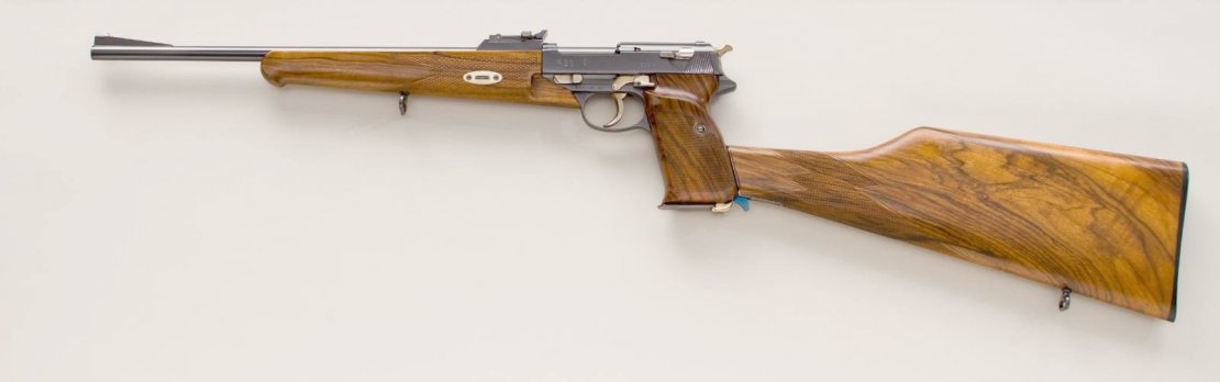

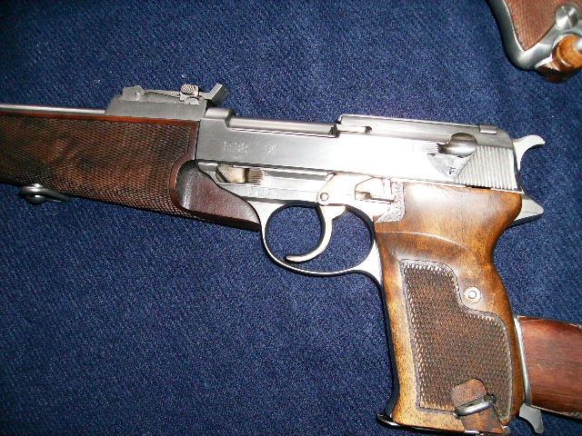

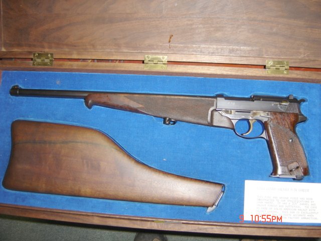

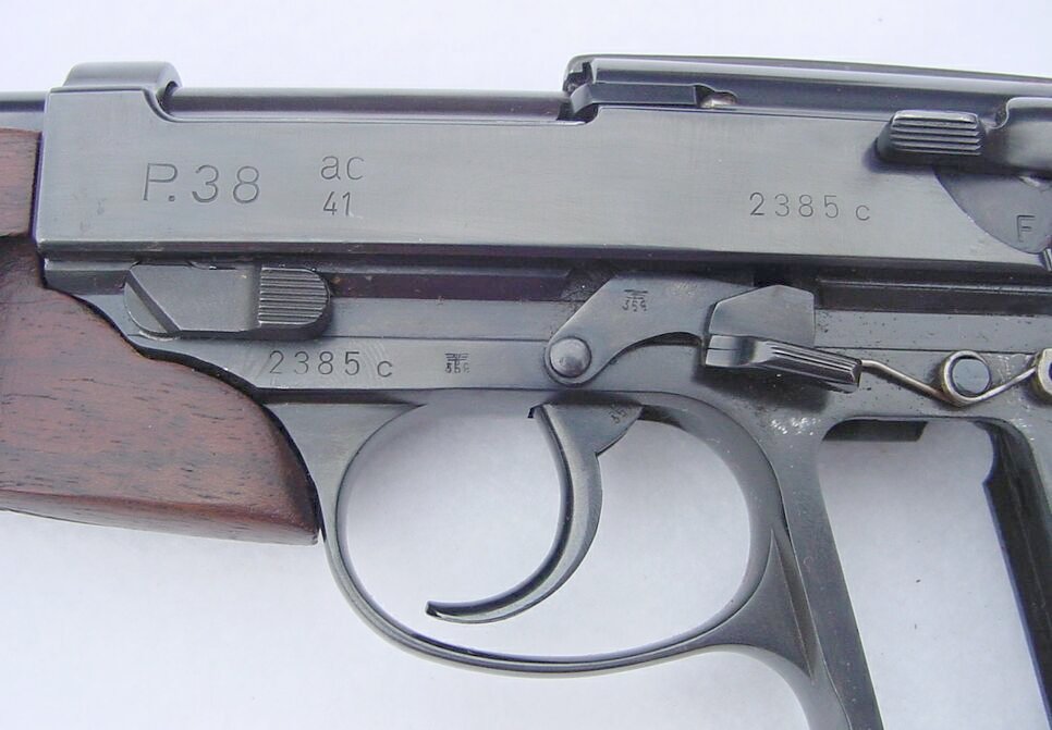

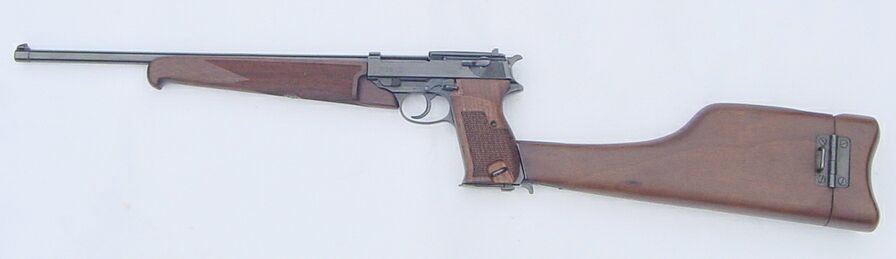

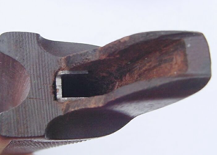

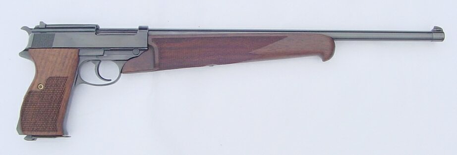

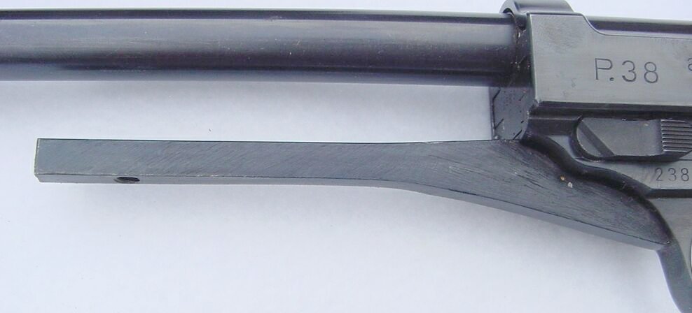

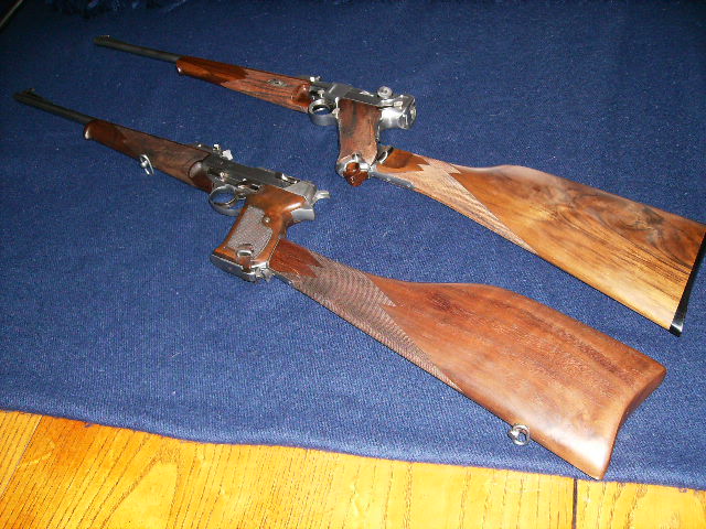

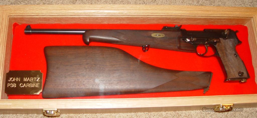

I found the thread(s) saved to my other PC, from 7/20/2014. Most were from a "Page 297.htm" site (I didn't save the URL ) and a couple were of the carbine that Greer bought & sold, one from an auction site.
In any case, here they are, attached rather than linked, for posterity...

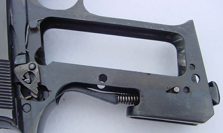

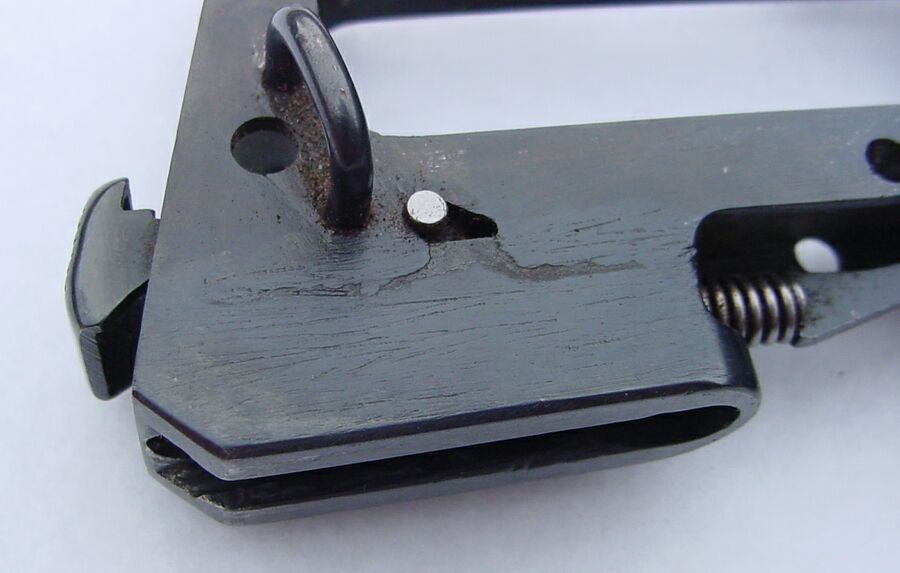

And I think I see how Martz modified/fabricated the new mainspring strut anchor...
(It's shown as the "magazine catch" in breakdown pics but it also holds the hammer strut and mainspring in place)...
Edit: Interesting that one of the carbines uses a Mauser C96 stock, and the closeups of the gripframe show the 'straight' lug (rather than the curved Luger lug) that Martz welded on...Which necessitated the 'magazine catch' modification...
