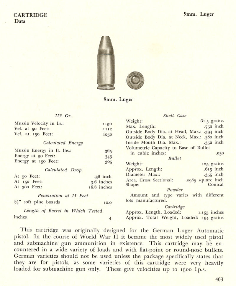

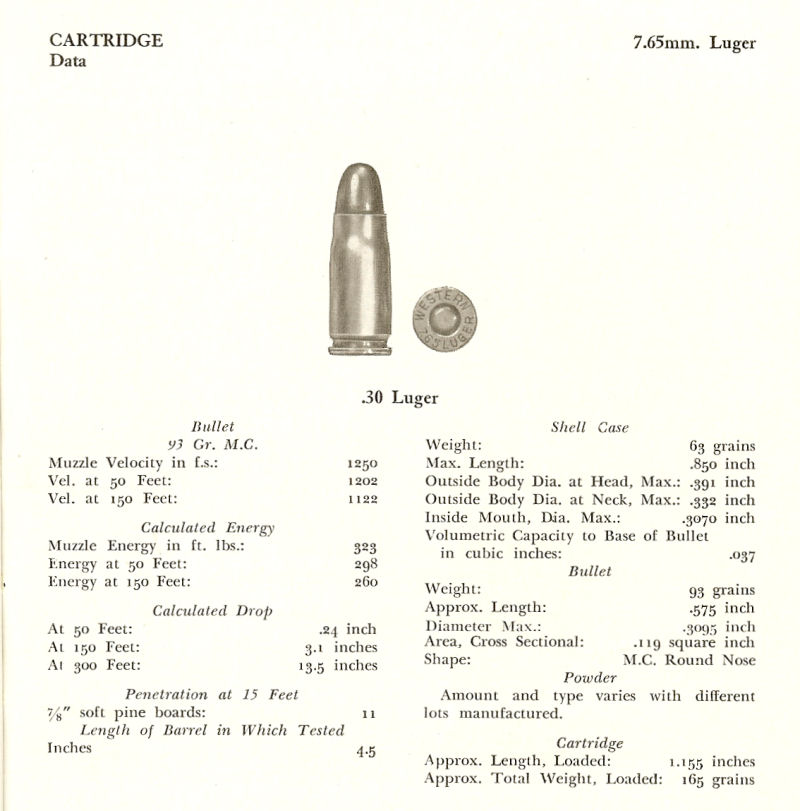

I stumbled on these while browsing the 1946 edition (4th printing 1953) of the NRA Book Of Small Arms, Volume 1, Pistols and Revolvers. I don't present it as the definitive description of these cartridges but as what shooters/reloaders had as reference material in those times.
There are many other cartridges shown; I posted these because they are the Luger cartridges.
Dimensions may not agree with other published (or believed) descriptions, but it's what the NRA writers observed prior and during 1946.

Looks to be talking about a 9mm major load for subgun use if it's 125gr as advertised at 1500fps. 1150 is NATO spec; if not quicker.
... ??? ...That's what it says; 1150fps...
Unread 12-28-2015, 10:34 AM   #4
Posts: 3,920
At the bottom toward the end of the paragraph they refer to the sub-gun loads as high as 1,500fps...
BTW - I just ordered a copy of the book via Amazon/Ebay sources. It looks like an interesting documentation of history at that time!
Thanks for the references...

Hi,
Again, these are not original German source materials, and thus, are suspect.
I'd like to see any 9mm Parabellum round loaded to 1,500 fps?!?!? This is surely a myth.
Most of the early post-war materials I have read on the Luger are misinformation.
Stick with the original German factory or military specs. for the truth.
Please also note that the two subject cartridges in the photo are Western Cartridge Company loadings, not original German ones.
Just some thoughts.
Sieger
