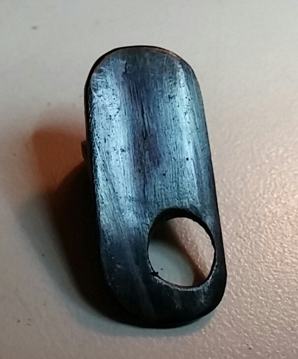

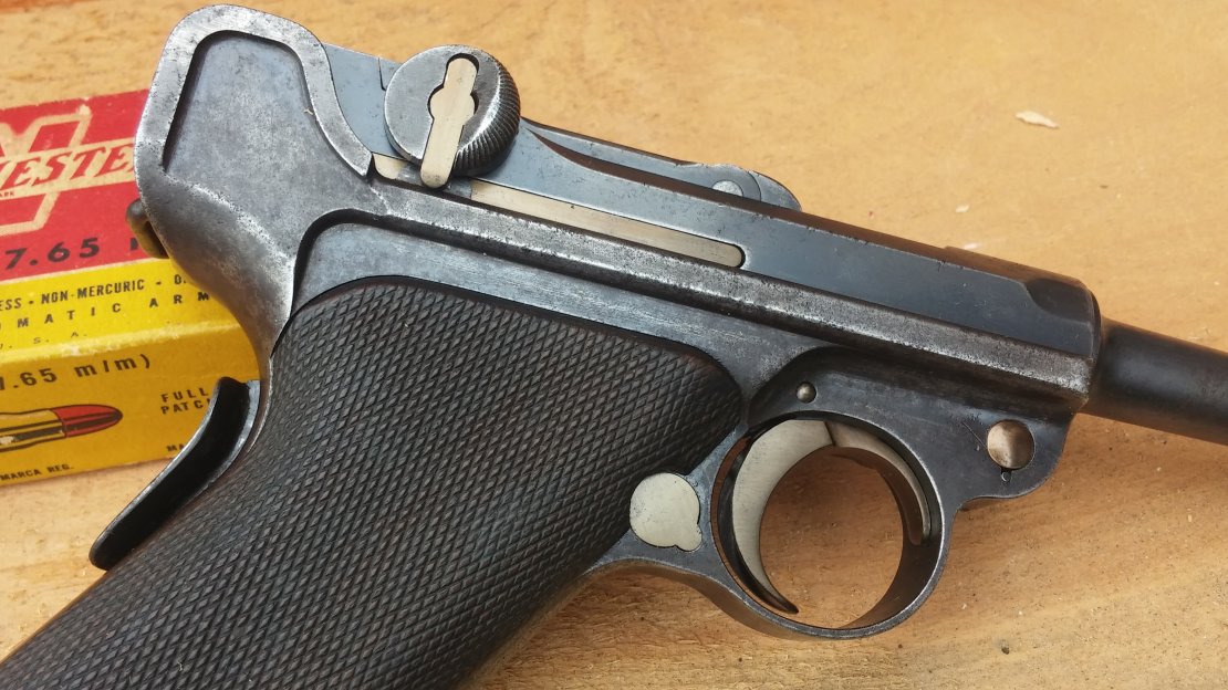

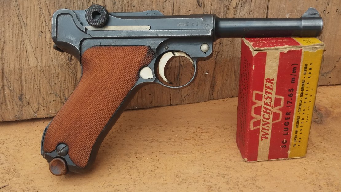

You may have had the bad luck to get a bad unit. The mark I made on the dial for where "Straw" happens in the oven is a lower temperature than the notch for heating a TV dinner, or re-heating a plate of food. For blue/black, I didn't use the sand, but set it on the highest setting and let it run for half an hour or so. Pics below of straw and blue, thanks to Black and Decker's $35 t.o.
Unread 12-23-2015, 10:09 PM   #63
Posts: 3,403
Thanks: 7,569
1 more

No reason not to use the "real oven" in the kitchen.
Strawing makes no odor, it only takes about 400-420 degrees.
Getting to 600 for the bright blue.may/ would be a little tough, would need a heat treating oven for that-or a torch. The blue has a much smaller temperature band to achieve the blue color, which is why the salts work well if controlled to exactly 600 degrees.
One could do the same thing with any media that was inert to the metal at 600 degrees.
