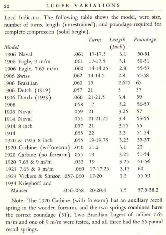

Years have taken their toll on original springs, springs have been replaced with "home made"; and several different configuration(sizes) were used in original production.
A compilation is shown attached below.

the Alpha commercial had a 17 turn spring(0.056 wire) and the
1912 Erfurt a 19 turn spring of similar wire.
Just a note on replacement mainsprings. Wolf makes three "rated" springs; IIRC 36,38,and 40 lbs ratings- All have 21 or 22 turns, at least that is what was in my kit. Overall length varied by 1/4", but not in relation to the ratings. I think they are all the same. I did buy two spring kits from Sarco, the mainsprings in them are 19 turns- and may be a better choice if you want to replace the springs in a .30.
Though if one studies the chart/info below, one sees that essentially all spring variations have been used at one time or another interchangeably for 9mm and .30 pistols. My apologies for not citing the reference, I do not know the name of the book where it is published.
Luger Variations, by Harry Jones, 1959, pg 30.
