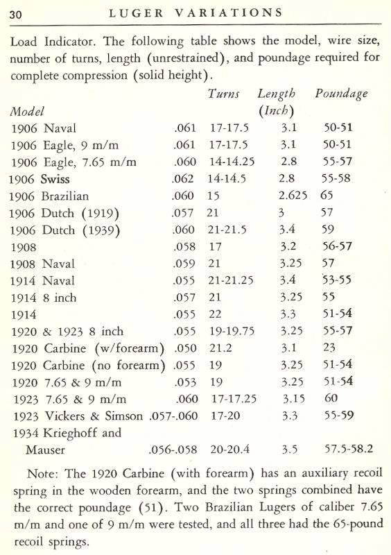

Lightbulb
The Germans, DWM and all had trouble deciding what spring to use.
This chart will give you some idea.
Though counter-intuitive, the .30 luger did not always use a "lighter" spring than the 9mm chambering; in fact the opposite is true in the
1906 American Eagle data. The 1920 and '23 models are shown as the same.
So, weaker may not be "better" in this case.
Be also sure your chamber is immaculately clean, just to confirm it is not a rough chamber, try a little oil on a couple rounds and see how that goes.

Pretty interesting results. I put a drop of oil on each round and another drop in the chamber. Had trouble loading the first round from the mag by drawing back the toggle and releasing; that first round got hung up at the chamber. I dropped the mag, and the round went into battery. After that: function was flawless: no trouble loading successive rounds, no jams, no trouble with extraction or ejection, and action locked open after last round. Not sure what this might mean, but it's a big step forward. I guess I'll try some Winchester .30 Luger, too, though if this pistol demands that ammo., I won't be able to afford to shoot it. Thanks to all......CF
