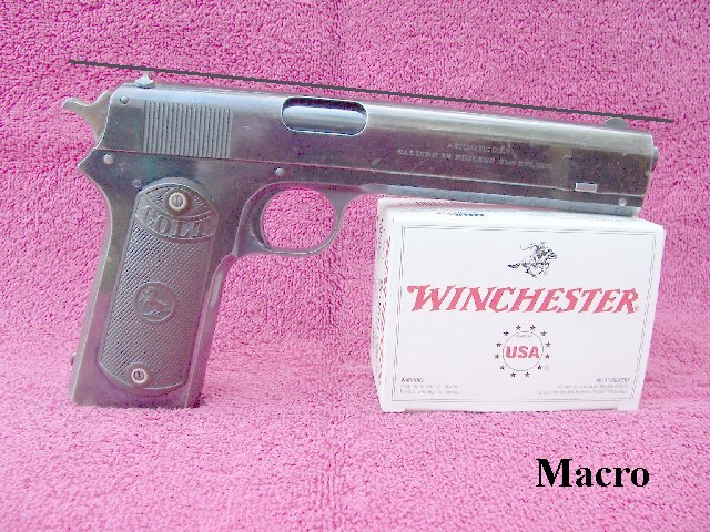

I imagine we all use digital cameras now (except Tom ) but to get a decent close-up I have to use the macro [close up] setting...
They don't look all that good...
How do you guys get the close-ups to not bend??? I drew a line above the sights on my 1902 Colt to illustrate...
(Not a phone-cam; Kodak EasyShare)...

You get a "fish-eye" effect with macro/closeup settings on a point and shoot camera. It allows the software to sharply focus at close range but the lens introduces spherical aberration because of the curvature of the lens. This usually can only be corrected by a seperate close-up lens that corrects for this condition. To get sharp photos without introducing a "curve" it is best to use a high resolution setting and shoot from a bit longer distance using the zoom function to get a close up effect. Also shooting at a high resolution then cropping the photo to the portion that you want to illustrate helps. Macro settings are only useful for a very close up photo of a small area, not the entire gun (for instance, you could us the macro setting to take a sharp photo of the rampant colt logo on the grip). It also is much less apparent for not-linear objects (you don't notice the bend).
Some higher end cameras have on board photo editing capabiliies that folks that know how to use them (not me) can manipulate fish-eye and correct for it.

Hi Rich, The problem you are experiencing is called spherical aberration. Macro lenses are corrected for this, but it's not usually a problem 99% of the time since so few close ups contain straight lines. You can get around this by placing your straight line, in this case the barrel, so that it passes through the center point of the frame, in other words, it's essentially a radius. I know this sounds complicated, but give it a try.
I do get what you mean. I'll try that too.

The effect is called barrel distortion, straight lines bow outward. This is the result of cost compromises of lens design, most often seen in wide-angle lenses or the wide settings of inexpensive zoom lenses. This shows up in "macro" pictures because the "macro" setting almost always defaults to a lens's widest-angle focal length.
The opposite effect, with straight lines bowing inward, is called pincushion distortion and usually associated with long focal lengths.
As Norm notes, placing straight lines as closely as possible to the horizontal center of the fame is the only way to reduce the effect without investing in different photographic equipment.
Spherical aberration is seen as slight "fuzziness" surrounding sharp points of focus. This is the result of lens design which does not adequately focus off-axis light rays.
