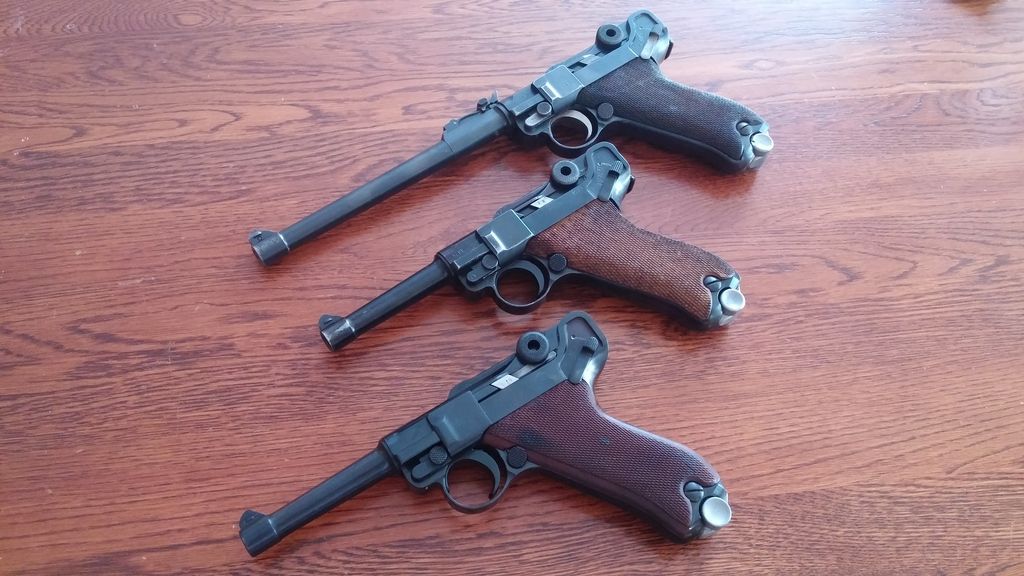

I have three Lugers. I thought I was done at two but then I found a nice shooter last week so here we are!
Have an issue with the 1916 Artillery up top, I will be asking about later.
So again, hello!

It is all matching, and it has the micrometer sights. Of course I had to shoot it once, and when I did the striker retainer came out of the back of the bolt. A tiny piece of metal broke off of the bolt that holds the striker retainer in.
I need someone who can add some weld material and machine back to shape. I have a metalurgist / engineer friend who also has a specialty welder friend, but if anyone knows a Luger doctor who might have tackled this I'd love to talk to them.
