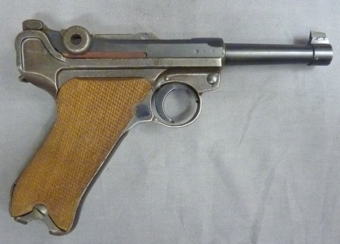

P 08 s an P 04 types were produced with either new or shortened 4" barrels in the Weimar era.
They are pretty scarce pieces, but are the inspiration for this shooter!
In my quest for pieces for the '06 basket case restoration, I accumulated a number of parts. One of which is an essentially complete '06 upper, which will be used for the '06 restoration.
So, with pieces on hand with no home and help from various members here, I assembled this clone.
It is built on a '37 Mauser lower, '38 Mauser receiver,
commercial 4" bbl, and the toggle train from the '06 Navy.
I took her out for a date yesterday, and she fires, cycles, and behaves perfectly- a great shooter and a little out of the ordinary.
I have to borrow a 9mm P reamer to finish ream the chamber, it is marginally short; in fact I had to select some ammo that would let the toggle close completely for the test firing.
When it is finished, I'll fire for group, to see how much too low, if any, the front sight is. Yes, I know it is not a P 08 sight, but is what I had that only took and hour with needle files to fit to the sight base dovetail.
Don't ask what it finally cost- I don't want to talk about it!

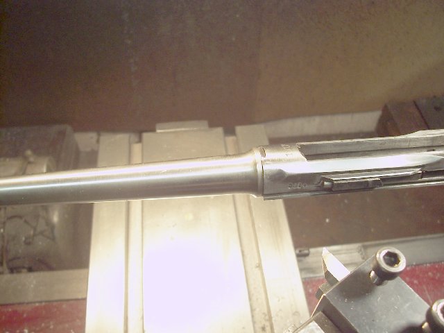

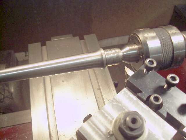

Here's a 6" barrel being threaded now...

I had originally posted a link or Search to a thread about 'odd Numrich barrels' but when I checked it I remembered it was for a barrel that had NO front sight base, so I fabricated one...
That doesn't help you...You have a barrel with a front sight base. If you chase your thread, you'll be able to screw it into your barrel extension and find out where you are. The thread is 20tpi which is .050" between threads. With a 'crush factor' of ~.004", the most you could be off is ~.046". That is, if you screwed it in all the way until you couldn't tighten it any more [by hand], and the front sight was exactly 12:00 o'clock, then you'd need to take .046" off the flange. But it won't be that much, so you could thin the flange and cut back the OAL and get a proper fit. But you would almost certainly need to deepen the chamber, and re-cut the extractor notch and feed ramp.
Adding a shim to a mis-matched barrel/extension combination opens up similar cans of worms. Will it need tweaking? Cut chamber, notch, ramp? Thin the shim?
There is a thread here somewhere where that was done with a OEM Luger barrel, but I've lost it...
I would chase your barrel thread and see whatcha got...
