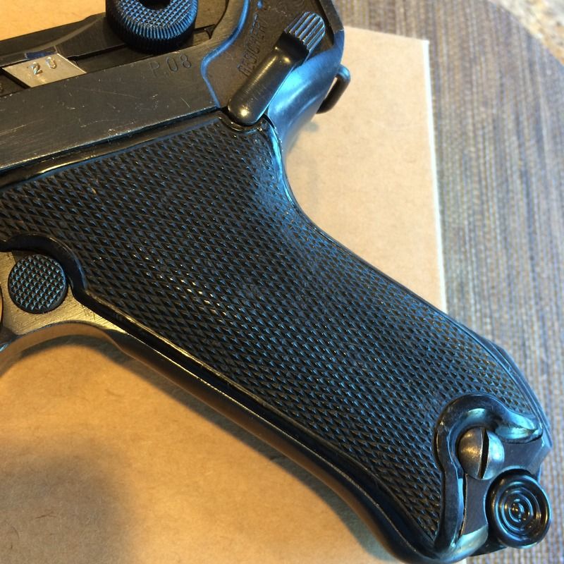

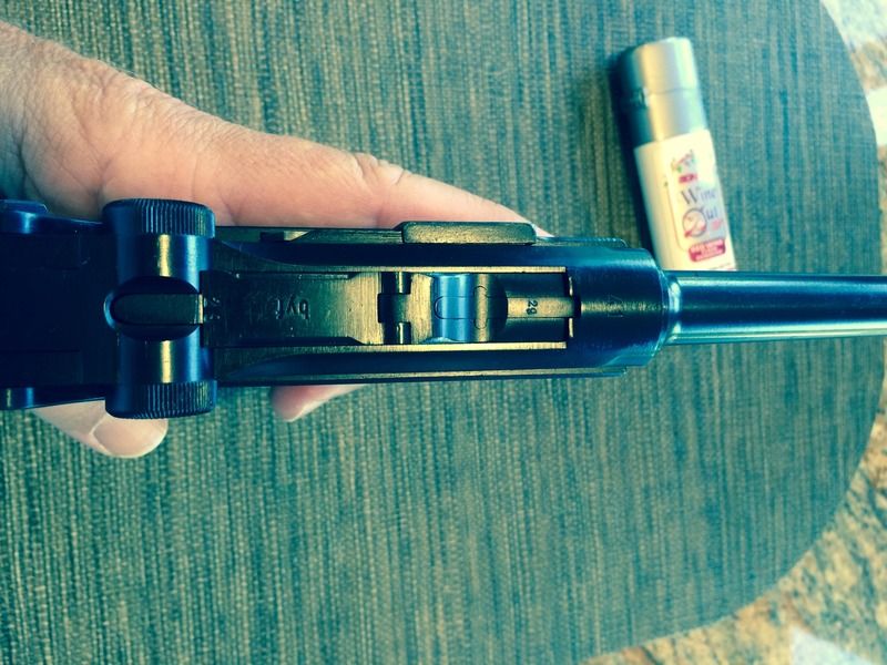

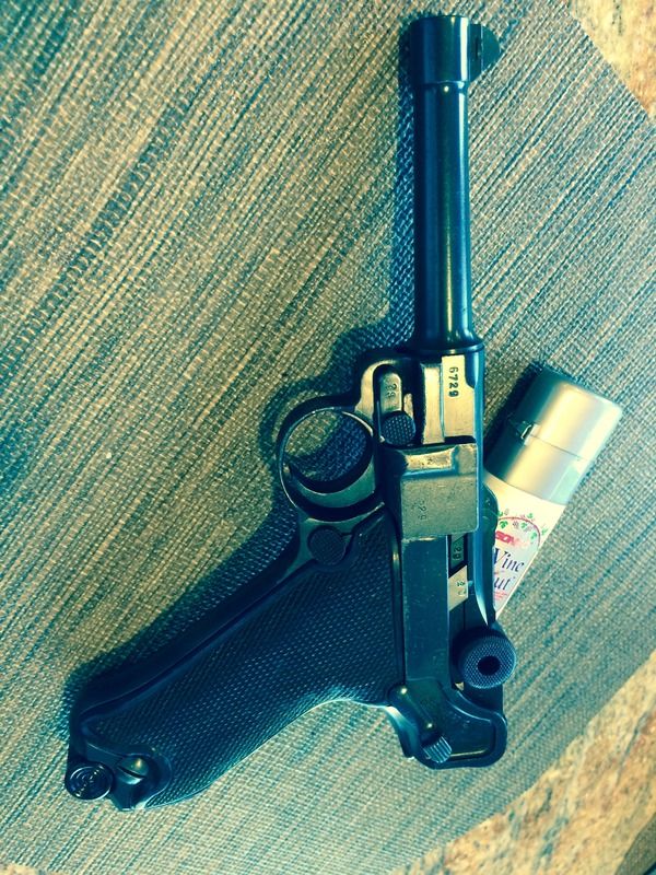

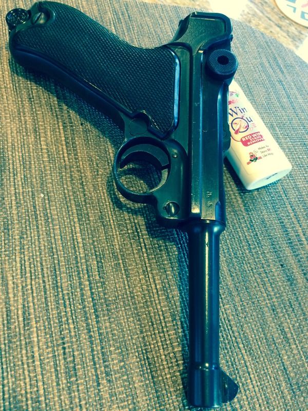

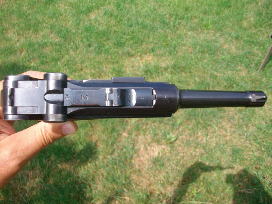

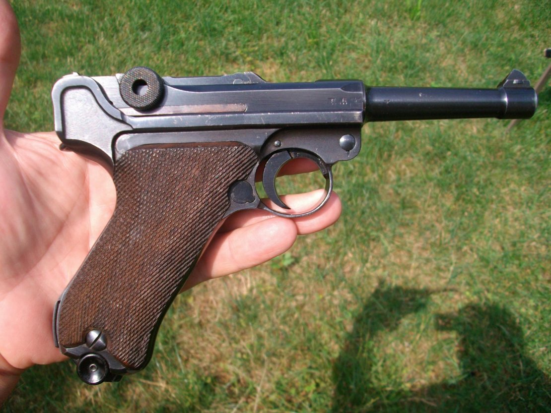

this is a no suffix block with the SE-655 SE-135 acceptance marks and test proof three. This pistol appears to be a transition from SE-655 SE-655 to SE-135 SE-135. All parts match from what I remember, have not taken it apart in 12 years.

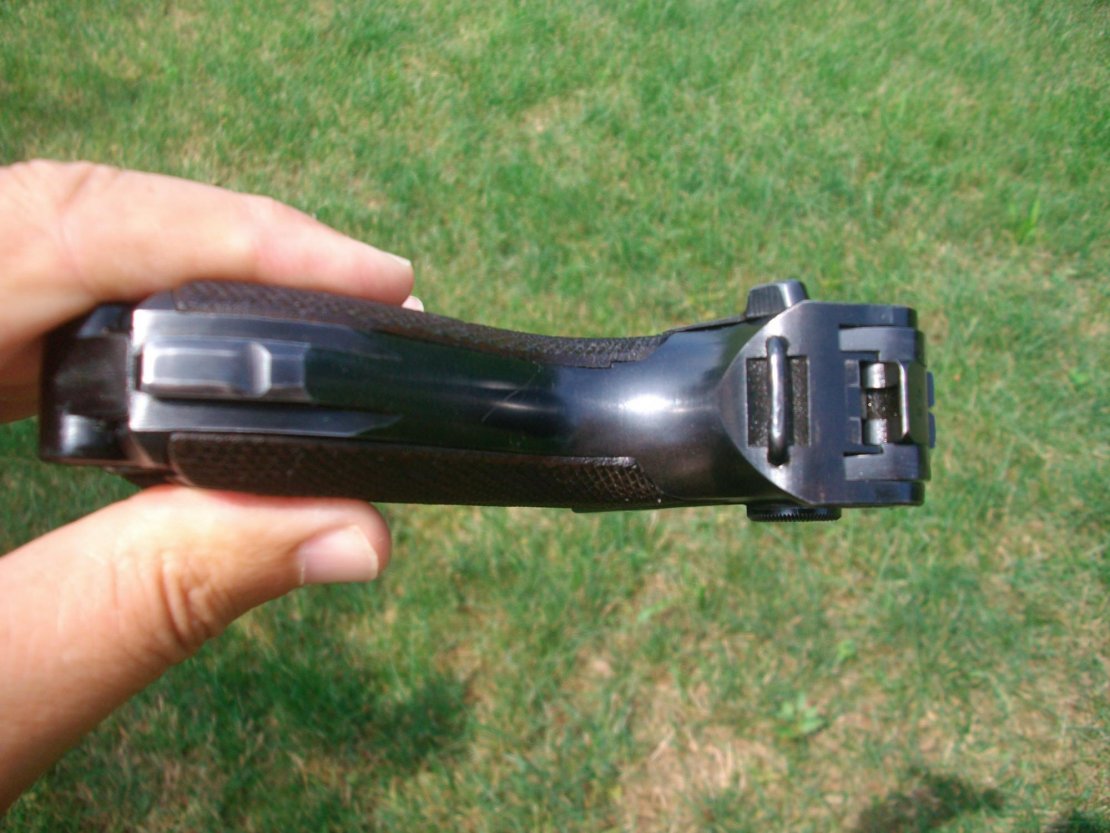

The first photo is the best of the bunch, and I'm thinking that to be the original finish. I just can't conclude otherwise based on the last 3 green photos. Magazine is definitely aftermarket. Now you need to determine if ALL numbers match internally.
IF all numbers match, and IF you land the correct plastic bottom magazine, and IF no one tells me I'm full of beans on the original finish thing, then I'm guessing value to be in the $1500-$2k range.
Unread 07-27-2015, 03:25 AM   #10

I don't want to seem difficult but the photographs shoud be taken from a closer distance and never in the open sunlight.

The finish on the gun looks original, with all edges crisp. The sideplate, however, has me worried. It looks considerably more worn than the balance of the gun and has a telltale vertical "scrubb line", which would normally have been polished out. This is usually found on sideplates that have been machined down to accept a new, force matched number.
Better photos would tell us more.

I agree. The sideplate looks unusual. Inside the plate, you should see the number "68" stamped.
Take the photos in shaded sunlight. Use a camera with a closeup setting and use a tripod. Trip it with the self timer to eliminate camera shake. Take good sharp pictures, without using the flash. There is an odd color cast to your photos. Use a digital camera, not a phone or tablet.
i can't judge the finish from your photos, but the safety should be marked in ivory colored paint. Seeing no paint there, and seeing the toggle axle retention pin apparently blued, this would point to a refinish.
To check the authenticy of the grips, take them off carefully and photograph both of their back sides. There should be threads in the holes. Also, a flame heated paperclip should not penetrate the bakelite material.
The photos taken in ac4142's post are not of the original poster's gun.

Being re-finished hurts the value considerably, so I'd not roll over and accept refinish too quickly. Depending on the pre-bluing buffing job, it can kill the value to $800, whereas an original might be $1400 plus.
While I can't tell too much from photos, I'm seeing no evidence of aggressive buffing, so I'd hold out for $1200 or so if you have to sell it fast.

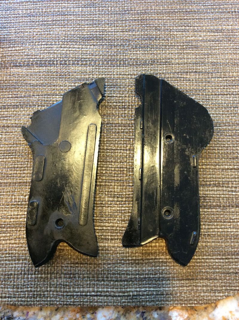

Okay, the side plate does not have a number "68". There is what looks like part of a "B" stamp.
Took pics of the grips, also did the heated pin test, it made a tiny mark but did not melt the material.
Bryon is offline   Reply With Quote
Unread 08-05-2015, 10:36 PM   #19
I'm not an expert, but the grip on the left looks aftermarket to me. The raised area around the hole is suspect.
The other one which shows evidence of the threads is more likely to be original.
The inside marking of the side plate confirms that it isn't original to the Luger.
