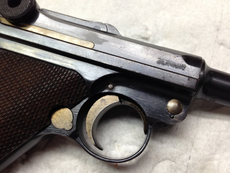

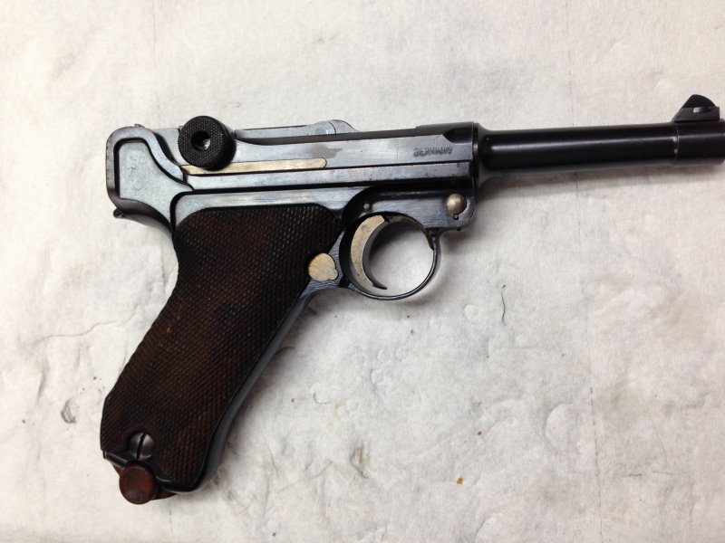

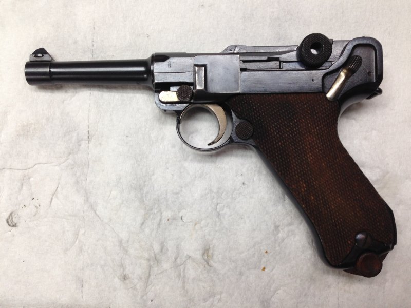

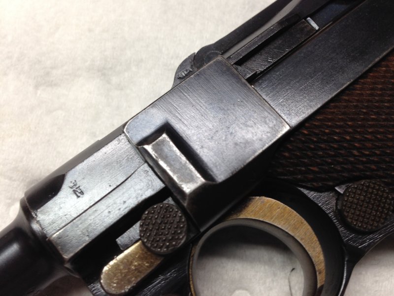

A friend of mine has this .30 commercial, it's definitely not the most desirable Luger variation but I would like to buy it just because I want a nice, matching Luger in an affordable price range. I think I can get it for $1,100, but I would like to know a little bit more about it first.
It doesn't have many numbered parts, the matching numbers I have found are on the frame, barrel, rear toggle (last two digits) and side plate (last digit), but there's also a non matching number on the rear of the breech block. This is what I can see just after a field strip, but from what I can tell there's no other numbered parts.
So does this look correct to you guys, and what do you think about the price? I know that the pictures aren't all that great, but the gun looks great in person, maybe a 95% or so.

Unread 06-23-2015, 11:34 AM   #2
Look closely for numbers, as they are "hidden" on the commercial guns. Even if all matching, $1100 for a .30 cal. seems to be right at the top of the market. Although the gun looks to be in good shape, I'd personally pass until the price drops to the $950 range.
Unread 06-23-2015, 12:30 PM   #3
Posts: 8,197
Thanks: 1,416
Maybe if a F2F sale w/no FFL fees, no sales tax, no shipping...And if you live in an area with few/no Luger sales...
I like the 30 caliber, and have bought & sold a couple...But David's price would be the most I'd pay...And that would have to be a F2F sale...I'd offer $100 less...And walk if seller give me a line of BS...
Unread 06-23-2015, 01:15 PM   #4
Sounds like a mis-match.
The side plate should be numbered on the bottom with both digits.
A "wrong" number (anywhere) is odd and not a good sign.
The "lines" on the side plate are not right, should be smooth like the rest of the pistol; maybe a number was removed?
Unread 06-23-2015, 01:36 PM   #5
Posts: 10,155
I think the price is too high. Overall the finish is nice, even if the gun turns out to be a mismatch numbers.
I agree that the "lines" on the face of the sideplate appears to be from something being sanded off and then refinished. But it doesn't look like enough metal was removed as if a serial number was removed... perhaps it was just a little rusty and they used a sandpaper that was too coarse to clean it up before refinishing.
The Takedown lever has marks around the edges of the pivot point that appears that someone who didn't know how to take down a Luger may have used pliers to assist them in turning the lever.
All in all I don't think the gun is worth more than $800-900 in this condition.
Just my $0.02
I found the last digit of the serial stamped inside, but you made me look again and the last two digits are actually stamped on the bottom edge. The side plate doesn't really look sanded, it's more like heavy high spot wear. It's not as nice as the rest of the pistol, for sure.

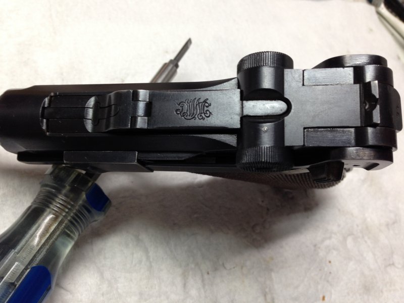

I am unsure what you mean by numbers on the rear of the breachblock?
If you look at it from the rear, there's a two digit number (not matching) right next to the firing pin retainer. Like Don said, finding odd numbers is not a good sign and the rear toggle has a "7" stamped underneath. Did they ever use any extra numbers like batch numbers, assembly numbers, date codes etc? This is pretty common on other guns, but I don't know if DWM ever did it?

Unread 06-24-2015, 10:21 AM   #15
The breechblock serial number is placed on the left side, below the line of the receiver extension, where it cannot be seen without disassembling the gun. On Lugers of this era there is commonly a number stamped on the rear face of the breechblock, next to the firing pin retainer, which has no relation to the pistol's serial number. The reason for this number is unknown.

Thanks: 159
Ok, so the number I'm seeing is not necessarily relevant. Still, there are no numbers on the left side, just a C/N stamp. The only number on the breech block is the one next to the firing pin retainer.
The extractor on the OPs gun should be numbered and matching, but you will have to remove it to see the numbers.
I just removed it, and it's not numbered. It's stamped "GELADEN", and that's it.
